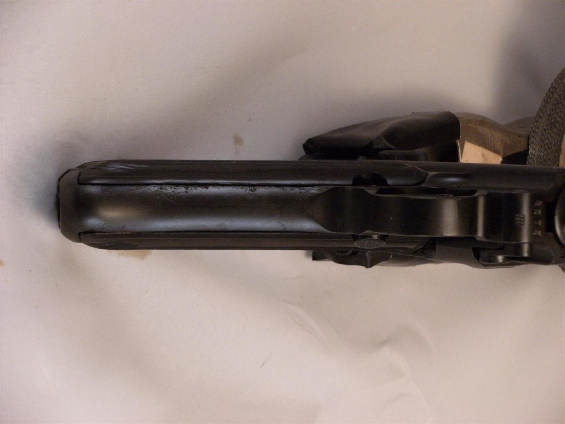

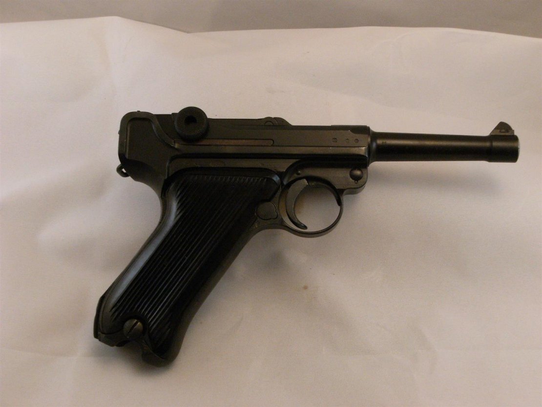

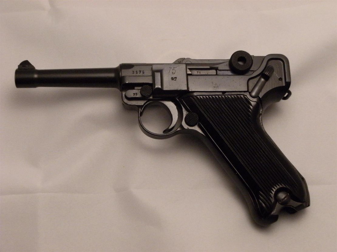

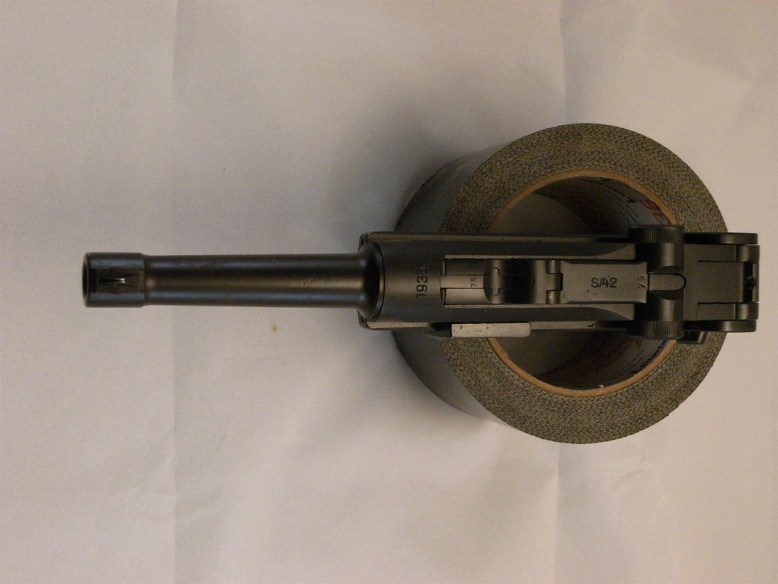

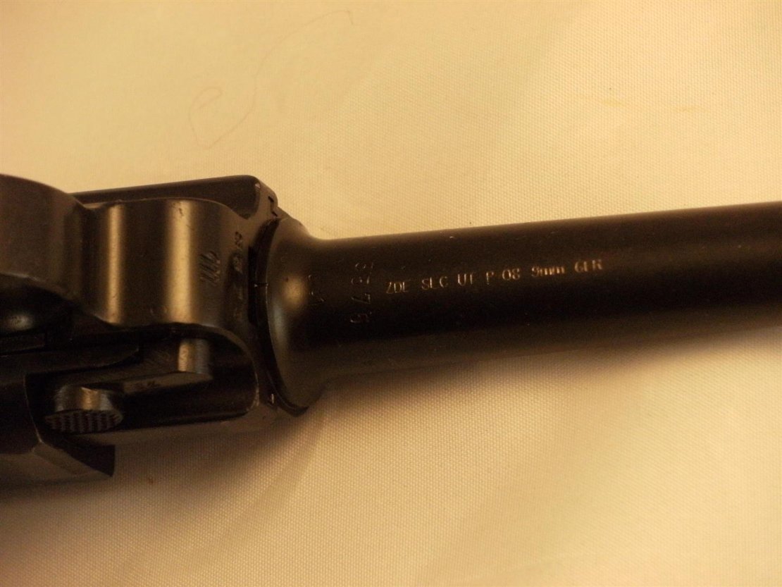

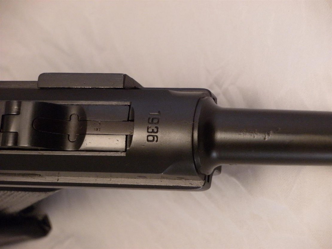

I’m new to Lugers and the forum. I don't know anything about forums so if I am doing something wrong please let me know.
I recently purchased a P08 from my nephew who needed to sell it. Pictures attached. I’m interested in learning everything I can about it. From what I have gleaned from the forum I think I know the following but would appreciate any corrections or additional information.
-Made in 1936 by Mauser.
-Early 1936 production because no letter after S/N.
-9 x 19 (9mm Parabellum) caliber.
-Shooter because re-blued, wrong grips, not all parts match S/N.
-Military issue because of proof marks.
I know it will never have any significant collector value but would like to return it as close to original as reasonable just for my own enjoyment without putting too much more money in it.
-Can anyone recommend some reasonably priced walnut grips to replace the plastic ones? From what I have read, some of the replacements are junk.
-Does the hand scribed “75” on the side plate indicate anything significant like it may have gone back through an armory and had this replacement side plate fitted to this gun or is it just something someone did along the way?
-Would it be worth it to try to find a side plate with numbers to match the gun?
-I would like to get an additional magazine to use when I take it to the range. Are there any decent new replacements available or should I buy a used one?
-Does anyone have any other suggestions for “aging” the gun or doing anything else to return it closer to the condition it should be for its age?

Welcome to the forum
The 75 on the right is called 'forced matching' - and the grips are usually what I think of for a 'Russian Capture'. They were usually 'dip blued' and sometimes this bluing can be taken off. But if overall it looks nice, I would leave it, as its import marked and with the sideplate renumbering.
The trigger, take down etc should be strawed on a 1936

-Early 1936 production because no letter after S/N...
The suffix is "m", as shown below. 3575m is your serial number.

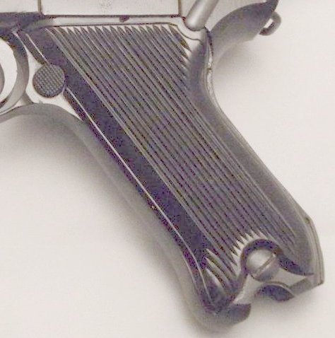

As Ed said, your grips are the 'Russian capture'. I paid $200 for a set. They're not all that common.
I think they're boo-tee-full...
These Russian capture Lugers were arsenal rebuilt after the War, and worn parts were replaced. Your 'dip blue' looks very well done. Overall, I like it. It would fetch over $1K hereabouts...Most likely in the $1200 range...

I personally would not alter the gun in any way, (well, wood grips can't hurt, as long as you keep the Russian originals).
These Russian capture Lugers are starting to garner collector interest. They represent a unique chapter in Luger history. Yours is a poster pistol for many of the features found on Russian captures.

Because of all those that have been imported, the quality of RC Lugers ranges from completely mismatched assemblies to better examples. Your Luger is mostly matching, with a force matched side plate. Once the dip refinish was done, and the import mark added, the originality of this Luger cannot be regained. I wouldn't pour money into it for that reason. The 1936 would also have had a rust blued finish, and strawed trigger / safety lever / ejector. You can't really restore it's original appearance without quite an investment...
I would also recommend keeping it as-is, and enjoying it by shooting it. I think that the quality and metallurgy of these Mauser made Lugers is excellent, so they are great to shoot.
