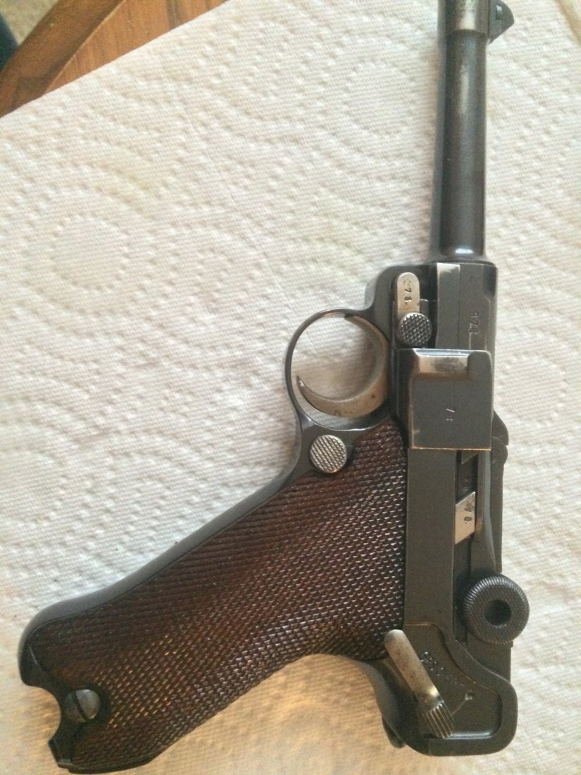

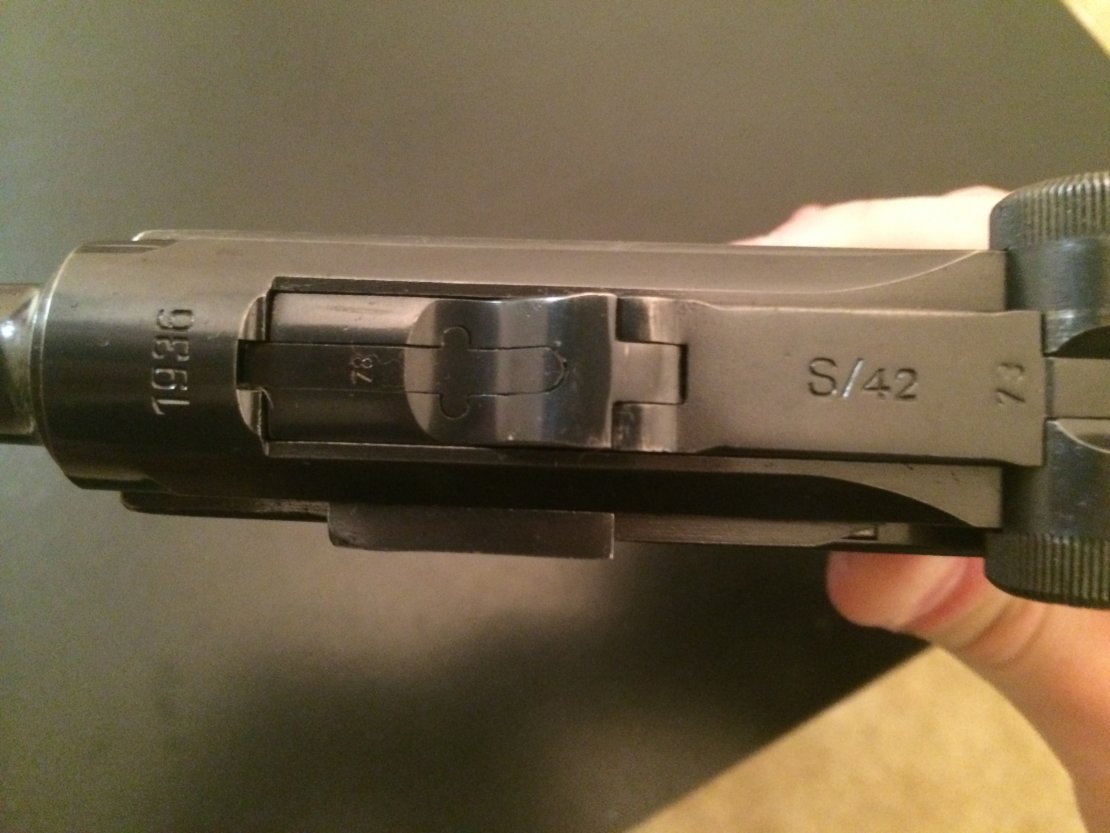

I may have overpaid for my 1936 S/42, but my impatience got the best of me and I'm more than happy with it. Its all matching as far as I can tell. The bore is minty and the finish seems solid. One thing that surprised me is in all the pictures Lugers look 'black' however in real life they are a beautiful shade of blueish gray. Very attractive color.

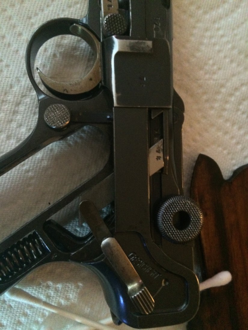

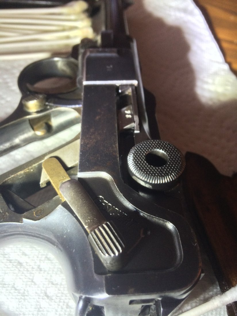

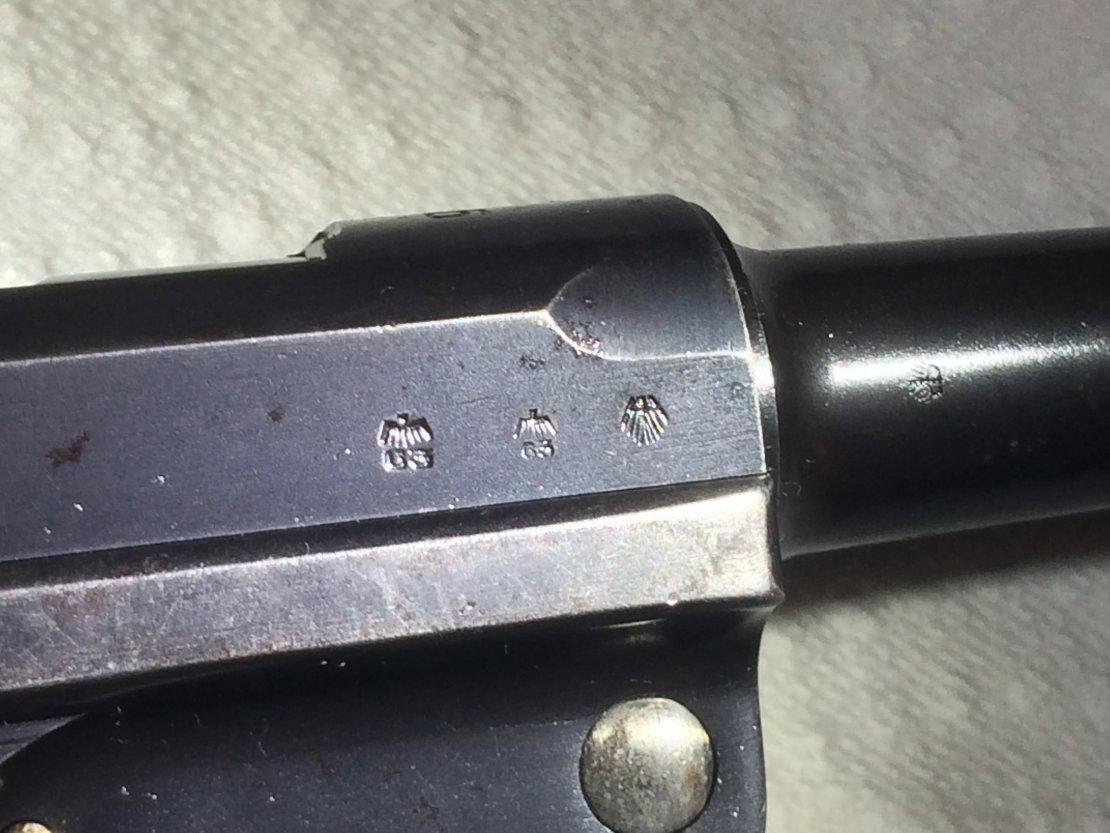

So onto my questions. There is small dots of rust on gun, under the finish in some cases as I'll show in pictures below. It's only really visible if you have a light coming at it from an angle. What is the best method for keeping the rust contained? I don't want to 0000 steel wool it because it'll likely remove the pretty blue finish.
Also, what is the best oil to use to preserve these old boys? Any tips for storage? (I've read of people using de-humidifiers in their gun safes, any links for these?)
Thank you everyone!
Matt
PS - How does one PM? I've seen that mentioned but I don't see a way to do it.

Looks like a nice gun as-is, and I too would be reluctant to use any steel wool, although some do recommend it. I'd say to oil a course cloth, run the offending areas, and call it a day understanding that those spots developed over years, and are not going away.
Any 3-in-one oil will work, as will any gun oil. Don't soak the grips but keep the rest lightly lubed. Most here say to not store in the holster.

I agree with what David wrote, I've never used any steel wool of any kind on my guns, especially on my collectibles; I've always preferred to use Ballistol and a rough, harsh in texture cloth for a few times.
Sometimes it just takes a bit of patience and a lot of love for these beautiful guns.
Congratulations again, nice Luger.

A simple nylon toothbrush sprayed with oil will help remove much of this without hurting the finish. Another option is a brass brush used VERY gently around raised rust spots, then cleaned off.

Take a look at this product.
I have used it on surface rust with no problems.
http://www.exploreproducts.com/big45...un-cleaner.htm

Properly done, well oiled 0000 fine steel wool or oiled bronze wool will not damage the blued finish if you use it correctly.
The issue is relative hardness.
The dark blue-black magnetite form of iron oxide is very hard and dense compared to the red oxide rust form of iron oxide. While the magnetite is hard, and rust is soft, the thickness of bluing is only about 2 to 2 1/2 microns. it's a surface conversion of the steel.
Spots of rust will eventually form pitting through the metal surface. That's why you don't want it growing. That said, it's normal to find the red form of iron oxide visible in the surface of a 75 year old firearm. In fact, if you don't see it you suspect a refinish.
Steel wool is as hard as the in the white steel in the gun, give or take a bit for the different alloys involved. It is harder than the rust iron oxide, and softer than the blue-black magnetite. That's why it can be used to remove the rust without damaging the blued finish.
The key is to not be too aggressive in the process.
If you want to try it, find a non-visible area under the grips and start out well oiled and gentle.
Using a cloth that is oiled would also work, but require more rubbing, possibly generate heat in the process and possibly cause abrasion marks if it's got any grit or dirt in it.
In the materials world, hard cuts soft - not the other way around!
It took a while to convert attitude towards those dots. In the longer run, collectors found them very comfortable on those dots. That's a sign of old finish. On human hands, it's common to see some darker dots on skin,,,, of course, that's very unusual on kid's skin, but gradually becoming common when people grew older and older. Same for the blue finish. Those dark dots under the finish... it's a natural sign of old age. Better keep it as is.
Probably everything has an exception. Some guns were well preserved, so almost free of those dots. Still use human skin as an analog -- just like some women started taking care of skin at their very young age, then, at same age, skin is much better preserved. Same for the gun. Some guns were collected by people many years ago, and were well taken care of, well preserved.
