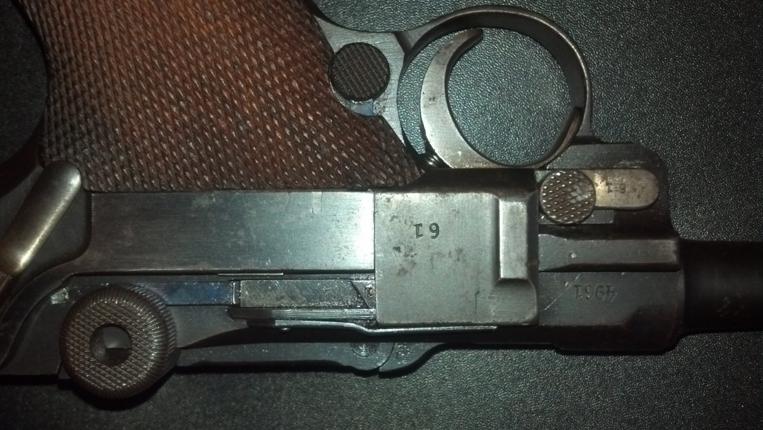

I acquired my first Luger about 2 years ago and have been learning about them every since. My DWM has the safety sear bar on the top of the slide and the safety itself was then removed. Am I correct that it would have been added in 1933 or about and removed in 1937 or about? Also the pistol has no other markings other than the normal acceptance marks and the Circle N proof. Should it not have some Police Unit marks or Nazi era marks if it was in service during those times? I am a little ignorant about Police Reworks and any info would be appreciated.

Can you get us photos of the mag. release button area AND the manual safety area on the left side?

Here are a couple of pics. I have looked and the safety is gone but the cutout in the frame is still there, it was not filled in.

So by saying that the safety is gone, you are referring to the magazine safety?
What is the chamber date? I'm thinking that the markings are appropriate for WW1-turned-police guns of that time, but let's wait until our police gun specialists have a look.

Yes, the magazine safety inside the pistol. Just the top bar remaining.

This pistol..so far is typical of what I believe is a Mauser re work. A WW1 pistol that had improvements made to it then issued to Police Units. I have often wondered if these had the extractor improved or if this part was left alone..
Yes..this firing pin is not the one it originally came with but a fluted one. Notice the deep grooves in it? Original WW1 DWM Army pistols came without this feature.

So even a reworked pistol would not have other markings. Also am I right about it being in service in the 30's?

So even a reworked pistol would not have other markings. Also am I right about it being in service in the 30's? I have seen Police pistols with MANY unit markings but that is not usually normal. Mostly they can be found without additional Police marks. Yes..exactly. 1926 is when the Germans began thinking of converting..changing etc. I suspect much of this work came about beginning 1929. Police holsters in the WW2 configuration became prevalent about then. Some could have been before but hard to really say how much/many.

If you remove the sideplate on a Luger while its loaded and press on the sear it can go off. The sear safety prevents accidental dishcarge if the side plate is removed by utilizing a pin that falls into place when the sideplate is off, thus blocking sear movement.

2. That many times the word 'rework' is not true - the magazine safety was added at same time as the sear safety but then removed in the late 1930's - sometimes they were cut off, sometimes they were removed completely with the side welded in (little rectangle on the side, like yours) and the hole for the safety welded in - these I believe were reworked because of the welding and heat involved. Sometimes you find the hole just left there.
3. If reworked or re-barreled by the police, then it would show a new marking on the barrel as acceptance.
So, sometimes there is 'proof' they were reworked and sometimes they weren't marked.
