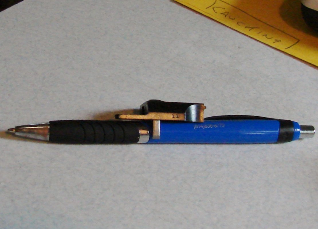

On an otherwise matching numbered Swiss 06, the side plate is numbered on the bottom side with the number 11. Would this indicate a factory replacement? No number on face of side plate or on any other place on the side plate. Numbers seem about 3/4 size of others.

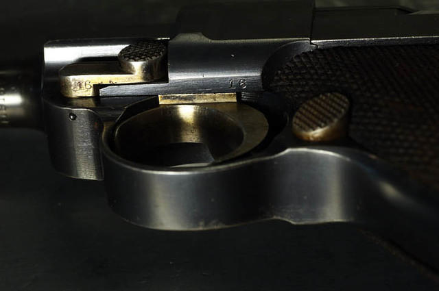

Unread 06-12-2014, 06:42 PM   #2
My 1900/06 Swiss is numbered in the commercial style, just like yours:

Sideplates of Swiss Pistols 1900/06 (DWM) are always numberd like this. The 1900/06 produced by W+F have 3 digits at the same place on the sideplats.
Alexander
Unread 06-18-2014, 07:59 AM   #4
Armin
Location: Germany
Posts: 35
Thanked 11 Times in 6 Posts
Yes, the side plates of Swiss Lugers are always numbered in this place, sometimes even upside down.
Armin.

This is a W+F Bern pistol, so not only is the number wrong, but should be three numbers, not two. Last three on frame are 279. Should the locking bolt also be marked 279, 79 or not numbered?

Unread 06-18-2014, 12:26 PM   #7
My W&F Bern Luger sn 21xxx has the last two digits (only) stamped in that position of the trigger plate, and no numbering on the locking bolt. The orientation of the numbers is 180 degrees (upside down) as compared to the DWM side plate.
The locking bolt lever has a more thin and almost delicate appearance compared to Lugers I have.
Unread 06-18-2014, 12:36 PM   #8
Thanks: 1,123
I would second Marc's (mrerick) comments. My W+F Bern is marked as his right down to the upside down side plate number. A side plate stamped with three numbers is the exception rather than the rule. The reason for three numbers is not exactly known. Popular theory is that a production run of guns exceeded 100 therefore there were two guns with the same last two digits of the serial number, so one of them was marked with three digits to differentiate it from the other.
Unread 06-18-2014, 04:48 PM   #9
Posts: 2,676
Thanks: 3,247
Thanked 2,668 Times in 991 Posts
My W+F Bern is also marked the same and upside down. No number on locking bolt. Numbers are 3 digits. Bill
