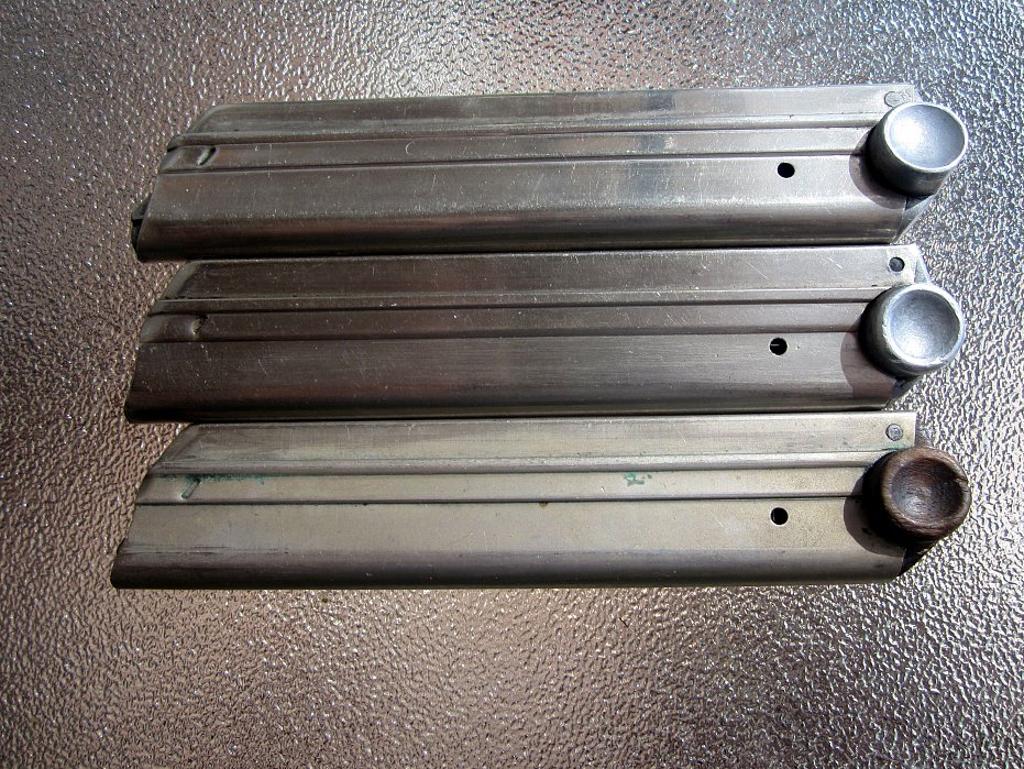

Default Whats are the holes for!!
They have remained unchanged for over a century!!~Eric

Tks I consider oiling holes but the mags have one side wide open for oiling when neccesary. The small holes seems the issue. Its present on ever type or maker I own one from the police and 2 matching to my Kreighoff. I imagine it had to have been made with the first luger prototype. Each was worthless without one another. They all seem to be interchangeable the 9mm or 7.65mm. Pure perfection and still in use a 110 years later. ~~Eric

Good question Eric, as I don't think that those are the so called "witness holes" that you can see on 1911 or GLOCK magazines bodies, indicating how many rounds are remaining in the magazine.
The small hole is the issue I think, perhaps it was supposed to be used to stake the magazine button?

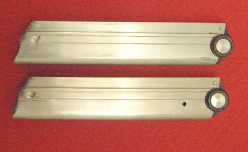

A novel use for the hole no doubt, but it is intended, as Ed (Regul) said, to stake the follower button to the follower or to remove it for repair. The very early Luger magazines, the so-called "flat button" magazine, was made without this hole since the follower button was threaded and screwed into the follower. This early magazine is quite scarce and expensive.

The follower is the metal platform inside the magazine that pushes the rounds up. The button that you push down on to load the magazine is fastened to the follower. In order to keep the button from working loose from the follower, when the magazine is first assembled the button is "staked", i.e. the end opposite the button is expanded in the follower by a punch inserted through the hole.
I showed a regular magazine with the hole (bottom magazine in the photo) and the rare "flat button" magazine without the hole (top magazine). The flat button magazine was used with the very early Lugers in order to insert them into an unrelieved frame. The flat button was difficult to use in loading so a higher button was implemented and the frame relieved to accommodate it. This higher button is the one that was staked through the hole.
