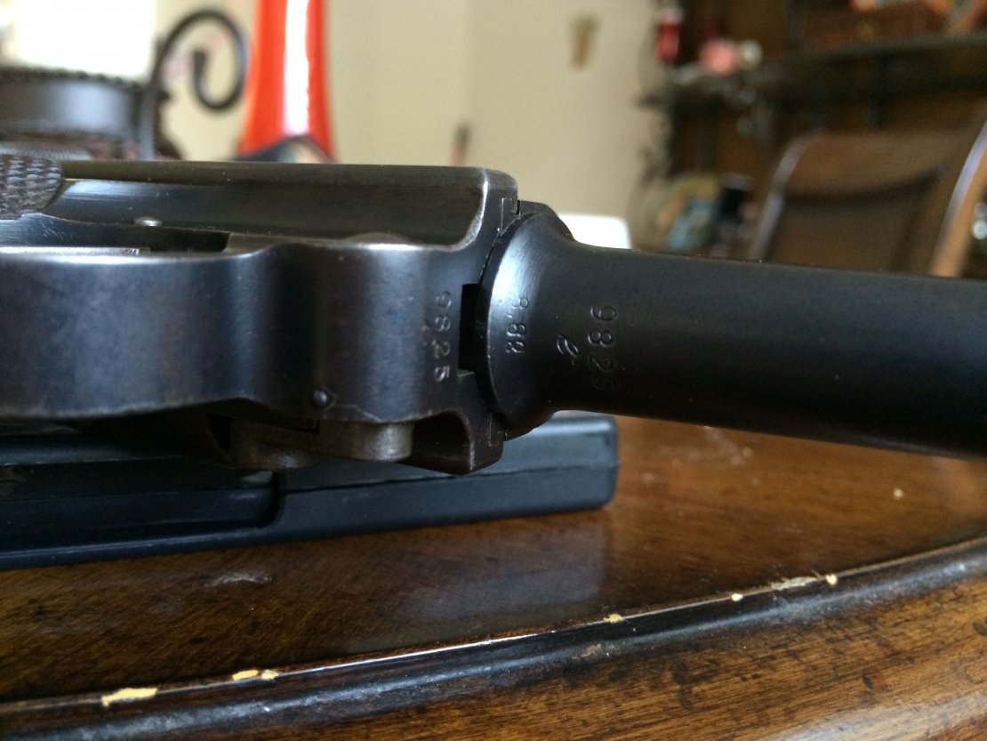

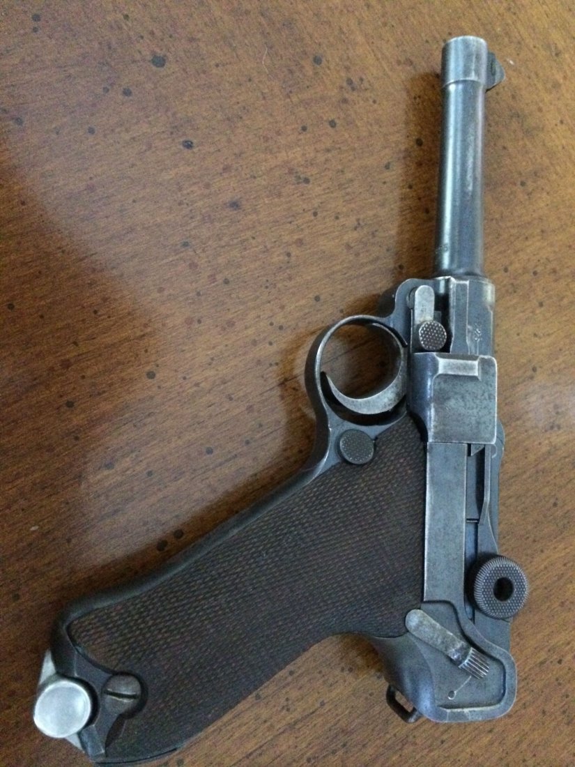

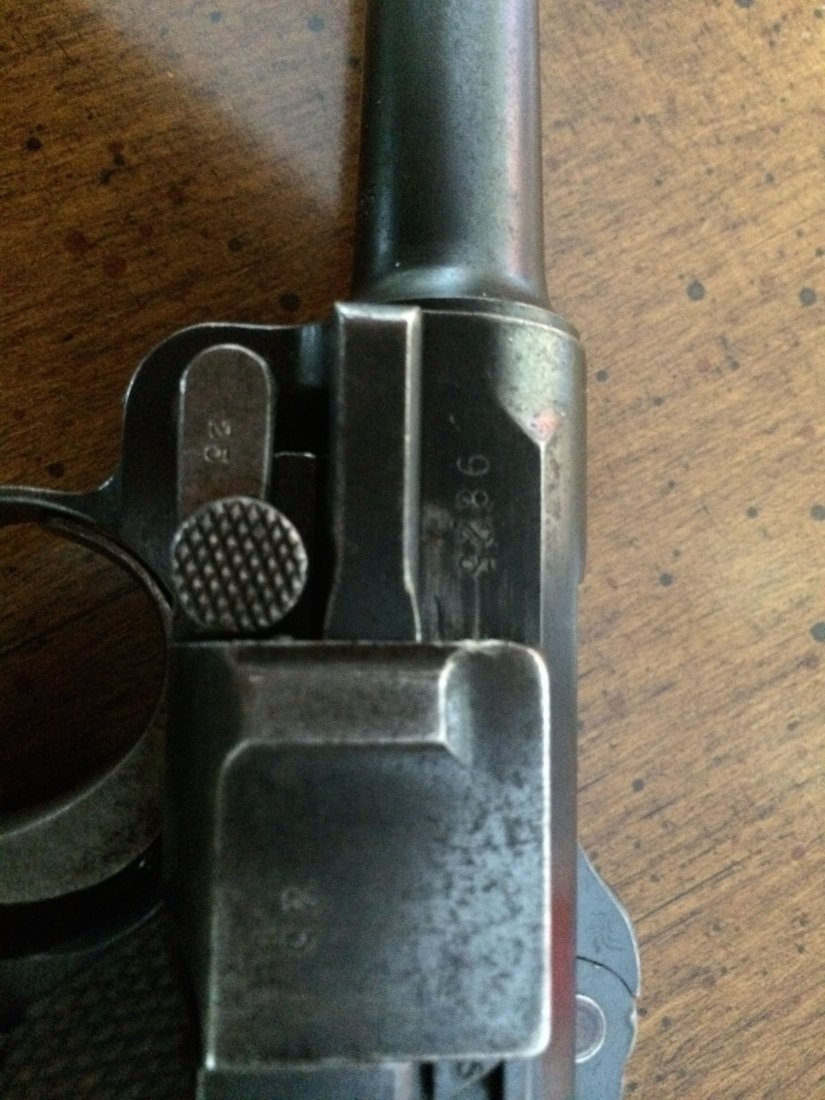

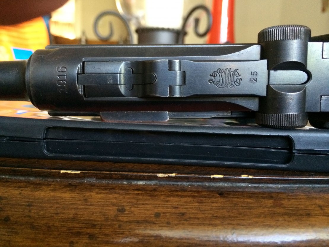

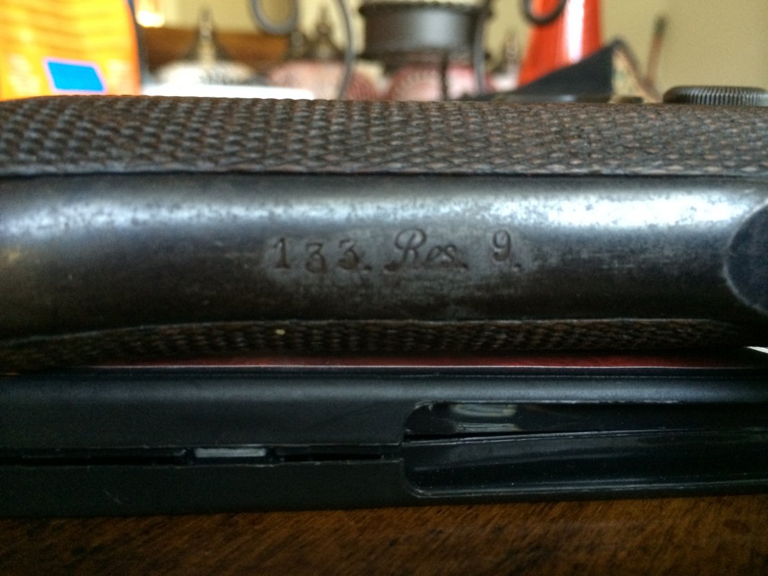

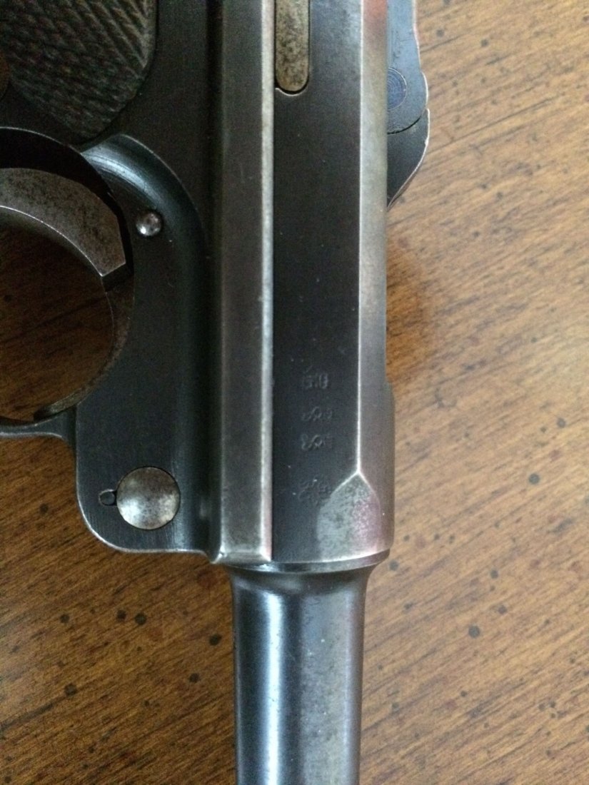

I have recently inherited a 1916 German Luger. I took it to a gunsmith for identification, but he could not identify the unit marking. He is convinced it is not a military unit marking, or it would be in the books.
The marking is 133. Res. 9.
I'm attaching some photos.
Any idea out there what this marking is?
Thanks!

Hi Ed, Welcome to the forum! Your unit marking is not entirely to regulations, but stands for 133 Reserve Infantry Regiment, Weapon #9, (a cursive R indicates reserve).
Regards, Norm

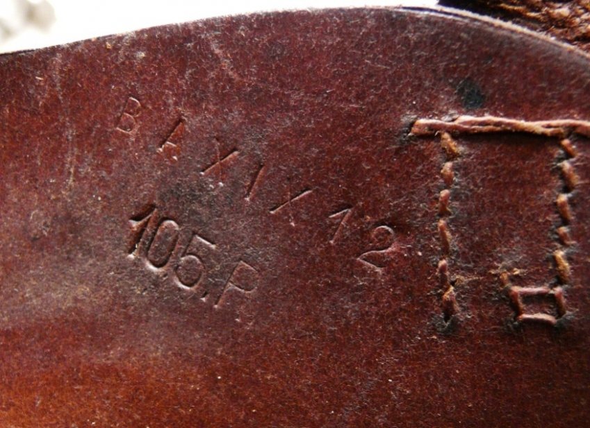

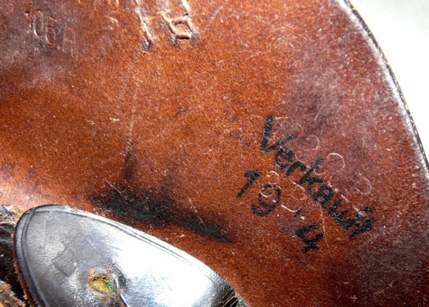

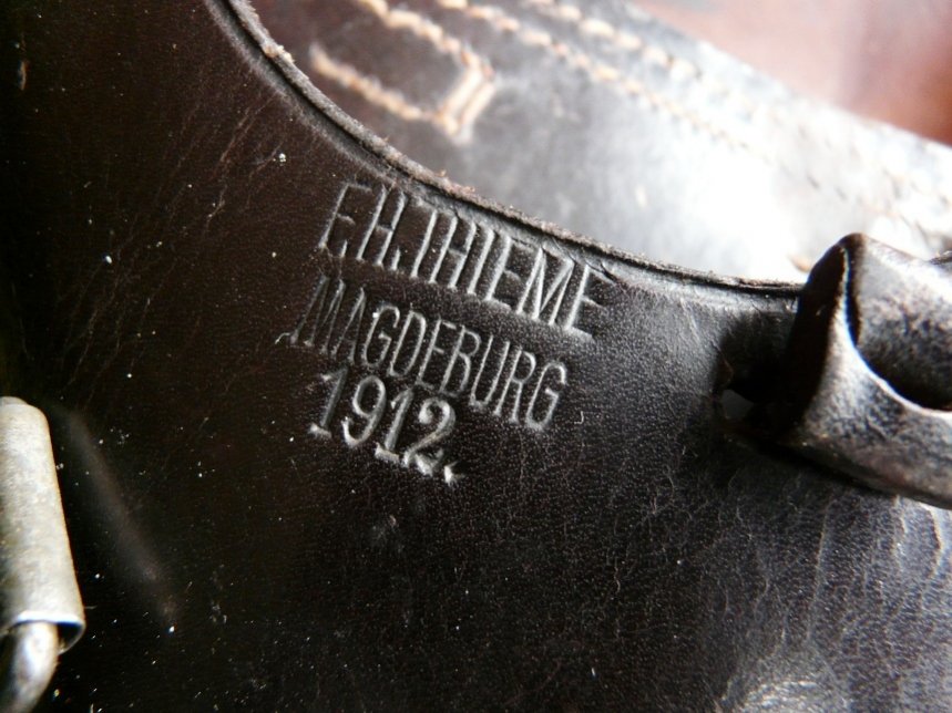

It was a Saxon unit that had terrible losses during the battle at the Some.
I have a 1912 dated holster that was issued to the 105. R and went to the 133. Reserve Infanterie Regiment in 1914.

Thanks Norme and Klaus. This is very helpful. To reiterate, this Luger unit marking is the Reserve Infanterie Regiment 133 and is weapon #9.
Also, it is a non-regulation marking. That explains the difficulty the gunsmith was having with its identification. That restores all of my faith in him: his work is always excellent.
