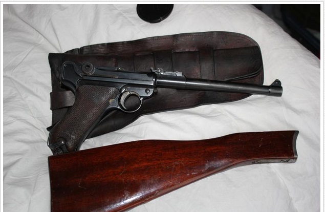

Can anyone tell what this Pistol is only marks are DWM on top of toggle a Serial number on front of receiver eight inch barrel 9 mm with a stock also has a very old western style holster and old cleaning rods ser number 6055 with a letter behind numbers a L or G ??http://s6.photobucket.com/user/horse...ml?sort=6&o=23

I'm no P.08 RKI but it looks to be a commercial LP.08 from the lack of military proofs on the right-hand side and the non-fine adjustable rear sight. The bullseye magazine...navy magazine?

Would need more pictures and info to tell you much of anything.. Many will say that there were no commercial artilleries. I assume there is no date? Does it show evidence of being scrubbed where date, serial numbers and proofs should be? Are there internal numbers? If you can send more and clear pictures I am sure someone on here can help. The mag. does look like a Navy. Is there a crown M on the wood base? Bill

From the one and only pic I can see I am with Bill..should be a lot more markings than those you describe.
The stock is trouble. If it's in the USA I would jerk the iron off and pitch the wood.

Did you understand what Jerry was telling you on the stock? Illegal! Save the metal fittings but discard the wood like your life depended on it. It's too bad but it is the law.

Welcome to the Lugerforum. I am glad you live in Canada, because as others have stated, the possession of this stock and that Luger would be a felony here... I can not be certain regarding Canada... so please check.
We would like to see MANY more photographs. Especially of the iron portion of the stock. I have never seen a stock like that one. It is probably a custom creation. If you look at many photographs of Artillery model Lugers with their associated stocks, and other "carbine" style stocks, you should easily see the dramatic difference between the one you have shown us and "normal" Luger stocks...
Without additional close up, in focus, glare-free photographs of the pistol, my judgement is that your Artillery Luger is a refinished military gun, and would be categorized as a "shooter" and not a collectible. My opinion could change based on any additional photos that you can post.
Close ups of the magazine would also be a good idea. If the magazine is, in fact, a WW1 Navy Luger magazine, it is probably worth several hundred dollars to a collector of Navy Lugers.

Yes there are stocks which are legal and original. But legal is the key word. In the US it must be original or a reproduction of the original. The stock pictured is neither so not legal in the US. I have no idea about Canada. Bill

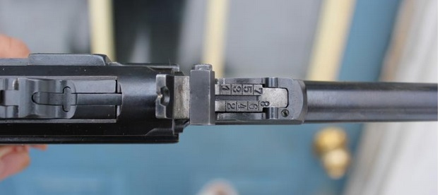

Finish looks nice (original), commercial style numbering, and un-numbered barrel. Is there a flat notch in the top for the artillery sight to lay down in?
Also, do the stock metal numbers match the gun?

One of the reasons I want more photos of the stock and installed iron is that the stock iron is NOT constructed like a standard stock iron... I am intrigued by how it was made and intended to be used.

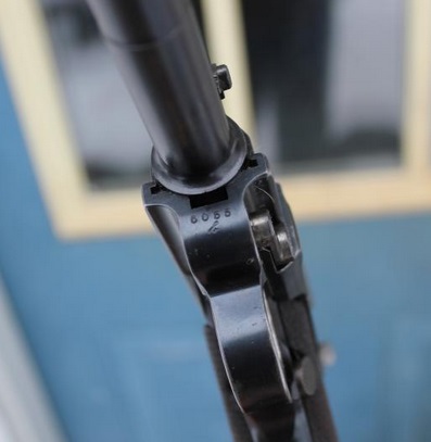

With the un numbered barrel, hidden serials I would say it was a parts gun made up. New barrel. Is there a Germany marked on it? Is there a date on the chamber?
The serial on the frame looks to have a suffix.
