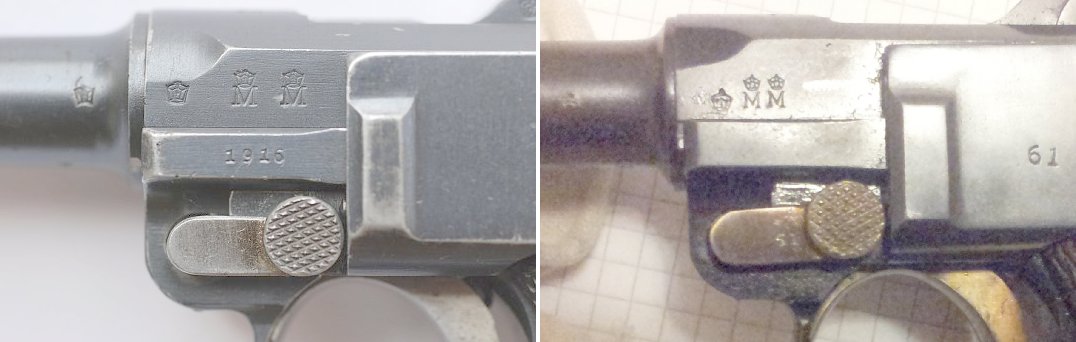

Unread 01-10-2014, 08:23 PM   #9
I gotta tell ya..those Crowns are floating like they have helium in them...
I am sorry, what do you mean with that?
Hermann
Arminius is offline   Reply With Quote
Hermann
Herman, he means that the crown proofs are freshly struck and are clearly phony.

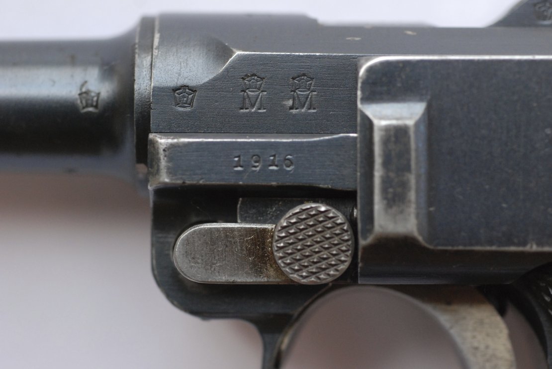

Unread 01-11-2014, 10:11 AM   #19
Hi Hermann, "Floating Crowns" are a descriptive term used by collectors to describe the Naval crown/M inspection marks on some early fake Navy Lugers. The crowns seem to float above the M's (second photo). A "Nested Crown" describes an inspection mark on a genuine gun where the crown seems to be sitting on the M (first photo). Unfortunately, since this distinction was discussed on the forums several years ago, most of the more recently faked Navies have nested crowns too.
As a collector whose first Navy Luger was also a fake (I now own 14 genuine ones!), I think I know how you feel. Use this as a learning experience, buy some reference books or read through the Archive section of the Navy Forum, right here on this website. I read every last post, it took many hours but I've found that it was time well spent!
Best regards, Norm

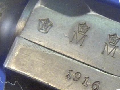

Unread 01-11-2014, 10:36 AM   #20
I am curious to know something..in several photo's it appears the top cannon is jutting out beyond the frame just slightly...
I am puzzled by this also...With the locking bolt ['takedown lever'] in 'locked' position it should not be possible for barrel extension ['receiver'] to stick out like that...
I have recently read of a mismatch like that, but it was on a pistol with a ground down extension lug...Maybe your lug is ground??? Or maybe the locking bolt has metal removed???
I think that you paid too much, and I would be more concerned with that, than with whether it is a reproduction or original...But I am not a collector, and if I were shopping for a 'Navy', I would be happy with this repro...But only if it was offered for about 1/3 what your price was...
Edit: I combined the two pics of the C/M's to compare 'floating' with 'nested', and now that I look at the front of the frame, I wonder if perhaps the frame was shaved to remove the original serial number...
