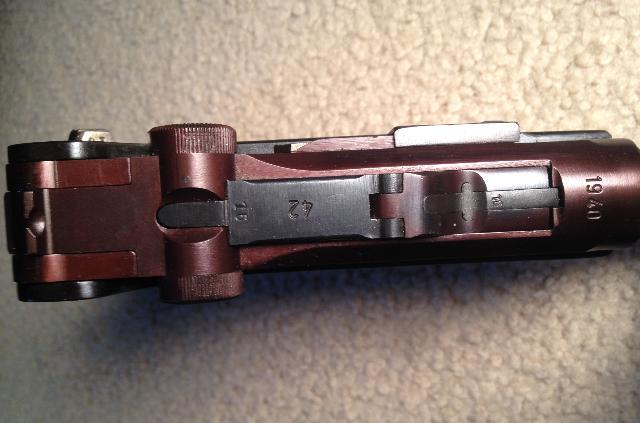

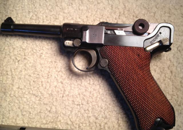

Does this look like original finish with the pictures provided?Can the grips be indentified as originals with the pics?

If the small parts are strawed, as they appear to be in the photos, then the gun has been refinished. The grips look like repros to me.

dip blue after 37 , the grips are too nice look like waffle cone too thin.... thanks

The give-away for these repro grips is the rounded top left corner of the left grip.

Refinished. Bluing solution was at the wrong temperature or weak... PLUM is Not original finish... repro grips look at the difference in the checkering between the original grips and repro shown above. Major difference in the number of lines per inch...
