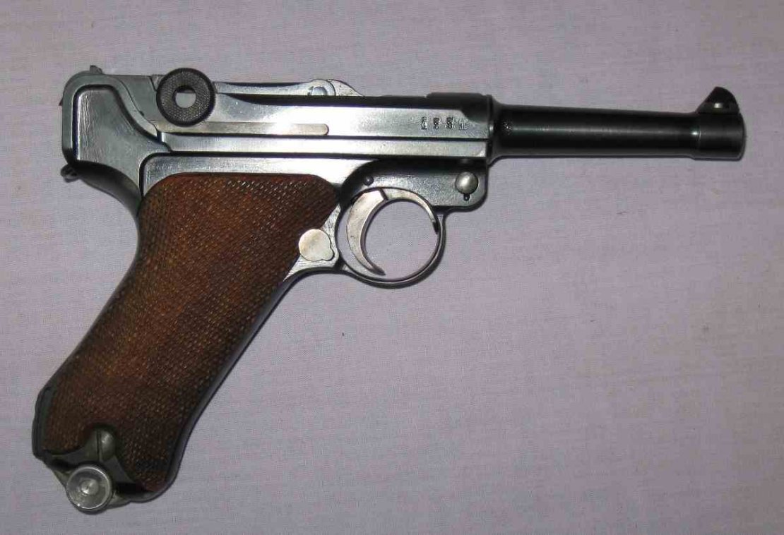

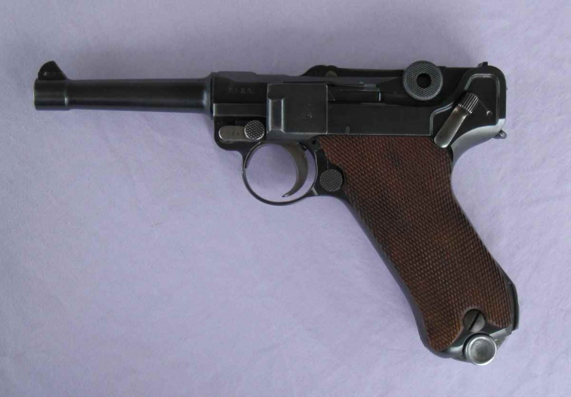

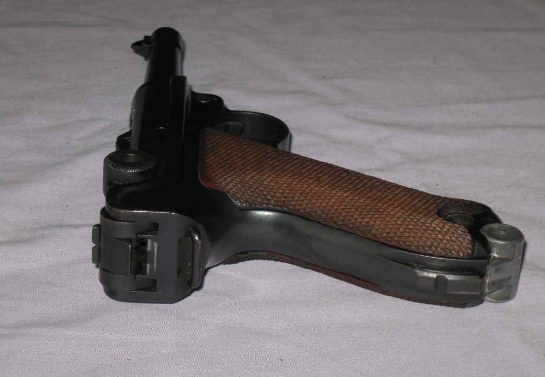

hello, would appreciate opinions on this Reichswehr 1920 property stamped Police Luger .

what value would you place on this Luger?

1917 Erfurt with a gov't 1920 marking - went into police service and received a mag and sear safety - has been refinished at some point, would assume arsenal / so that would be expected...

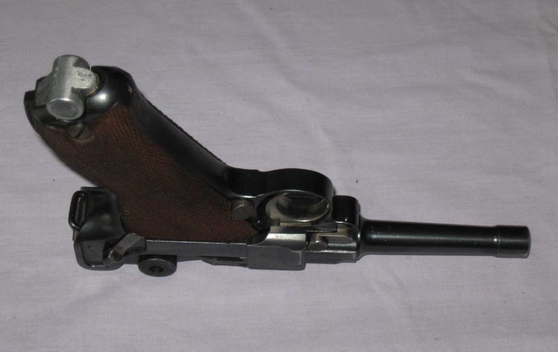

I am assuming it has a matching magazine, and it looks like its in excellent condition. The magazine is aluminum, so is 1930's era likely. I would venture a $1400-1700 value
More information, rather than just pictures would help
all matching?
holster or anything else?
any unit markings?

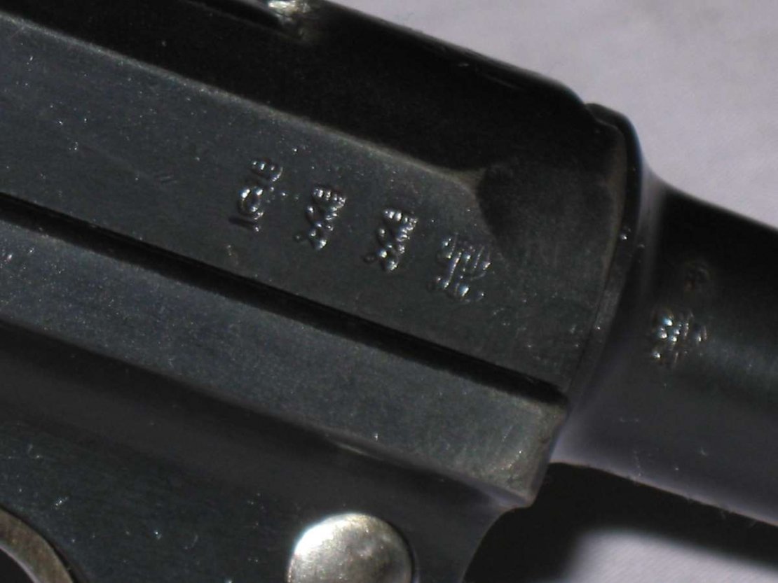

I changed what I wrote, as I assumed... but you don't show any pictures of the serial number, so its a guess that the '24' matches????

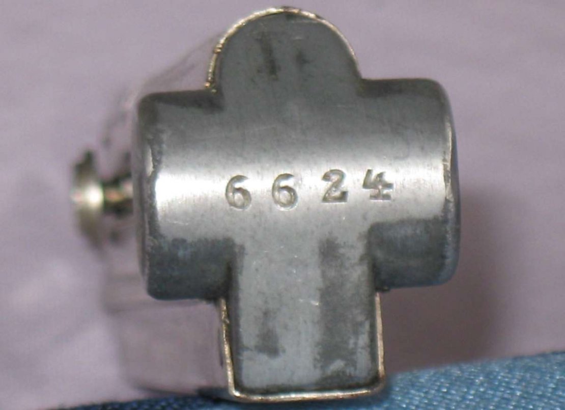

The mag. may match from its rebirth as a police gun. It is not a matching mag from its original military conception.
A nice gun. Congratulations!

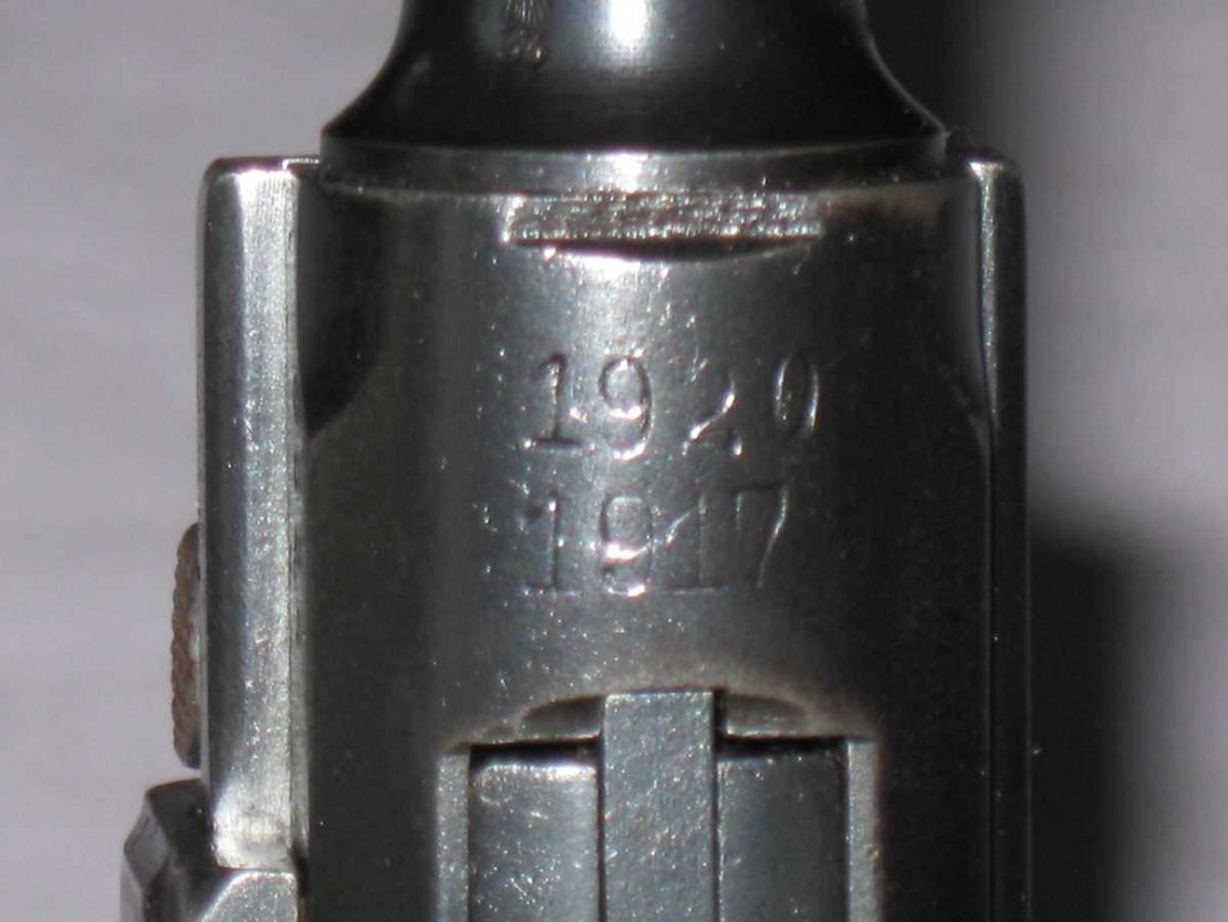

The pistol was arsenal re-finished/re-worked in 1920 where the barrel was shortened to its current length. The gun was originally unit-marked on the inside grip area, but these markings were X-ed out during the arsenal refurbishment and are now illegible.

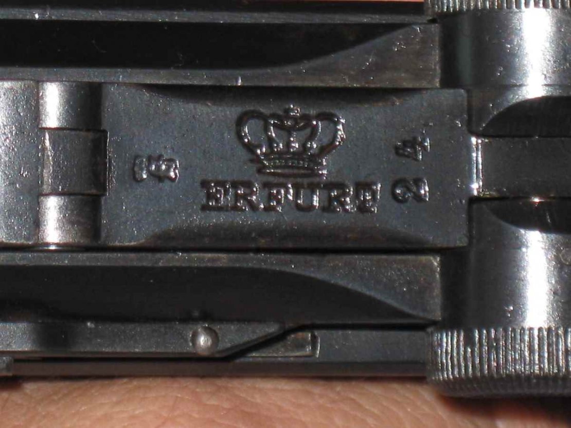

It´s a "parts- gun": Receiver is DWM, toggle Erfurt.
NO, NO, NO
Old information and not correct
1920 is not the arsenal remarking - see the FAQ to read about the 1920 gov't marking
It would have been re marked whenever the unit changed or the gun went to a new police unit, could have been 1928 (or other date, sure not 1920).
Was the barrel shortened? if frame was DWM, then yes

This is not an Erfurt pistol. It is not what we call a matching numbers gun. It is a mismatched re-blued almost complete DWM - with a partial Erfurt toggle. The fact that the toggle train has the same numbers on it as the rest of the gun means nothing.

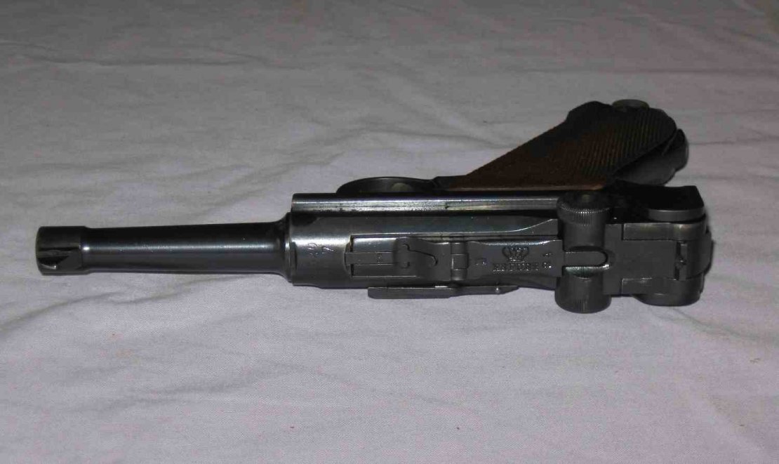

The frame, barrel/barrel extension, and all small parts are DWM. This gun has been reblued again more recently (after the Police refurb/reissue). Is there a SN stamped behind the rear sight? (there should be but I don't see one).
The matching mag is a nice touch but adds little value to the gun because:
1. the gun is not a complete original.
2. mag has been ground down and renumbered, but probably not by the police.
3. police issue mag should have a 1, 2, or 3 stamped on bottom.
$1100-$1200 is top value, as a nice mostly matching DWM shooter.

Geo, I would want to see more before I would declare it reblued after the police.
The sear safety pin is in the white. I would want to see under it to see if it is in the white on the underside?
Not all police guns receive a 1, 2 or 3 - I agree I expect to see it. Do you see obvious regrinding on the base? I did not, but I am on my laptop. It does look odd, I would want to see pictures from the sides to see if reground and a real close up of the numbers.
yes, it is it retains it's whitish color
yes, it's "24"
point well taken; the seller is going to carefully open up the inside & check the serial numbers. I asked him to send me pictures so i can post. thanks Geo.
FAQ is a very valuable section, thanks Ed for reminding me of its presence. Here's the section on the so called "double date"
FAQ#40 What is a double date?
Here is another area that is brought up, especially in the GunShow circuit. Double dates. True double datres are fairly rare, and what most folks call a double date is really a Reichswehr 1920 property stamping. I quote Jan Still: The 1920 stamp was added sometime between August 1920 and April 1921. It is a Reichswehr property stamp applied to identify the Luger as German Army property to prevent theft. Civilians were paid a bounty for turning in their unauthorized weapons to be destroyed. The Army feared the theft of its unmarked Lugers for the bounty.(Weimar Lugers page 20-23)

It looks like a recent refinish to me. Blue in the pitting. Some of the edges ground round. I wouldn't pay more than $1000
But I am partial to guns with wear. Some people like the refinished look.

When I looked at the photos I mentioned that the barrel has the TP (Technische Polizei) stamp and the acceptance mark of those years. It also has another "blue" than the rest of the Luger. I do not think that the pistol was reblued ever.
