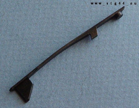

For sure.
You are sometimes mixing up extractor and ejector, and it gets confusing; I'm assuming you mean extractor.
The ejector is the long spring in the side of the receiver extension, and does not have a "spring" it is its own spring.

Extractor. A numbered part uses a spring for tension.
Ejector. Not numbered, it is a spring in itself.
This started wrong when the OP wrote he replaced the "ejector" spring. That thing doesn't exist. So I assume he meant "extractor" spring.
Later he wrote the ejector broke. And here I believe he really meant it. Ejectors break quite often.

I apologize for the lack of clarity. Kurusu is correct, I did mean I replaced the ejector (photo #2).
The ejector is what I had to file down so it no longer contacted the frame. Just to be extra confusing I mentioned it the original post that I replaced the ejector spring, I should have said EXTRACTOR spring there because I also replaced the extractor spring in addition to the ejector.
Thanks again for the help. I think I'll try shooting again now that the ejector isn't dragging on the frame. I'll also bring the original extractor spring to the range and change it out if the issue still persists.
