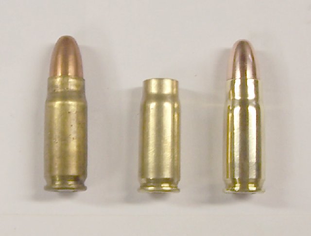

Maybe I'm being unrealistic...Here's a pic of three cartridges...
First is typical before being shot...Second is after 'vibrating' all night with crushed walnut shells...Third is spin-polished with Nevr-Dull...
I don't really expect them to be bright & shiny like the third...But is the second about the best I can expect???
(All are 5.56 military cases formed to 30 Mauser)

The case in the middle should work fine... Marc

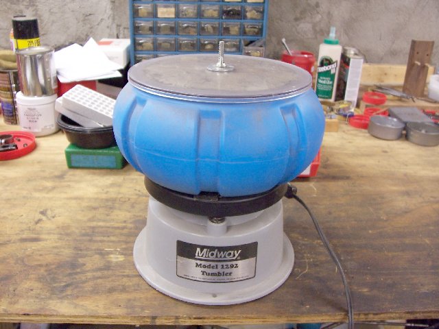

Attached is a pic of my ~20+ year old Midway 'tumbler'. I suppose it's more accurately a vibrator. When I first got it, instructions were minimal. I filled it, dropped my cases in, and turned it on. It sort of vibrated, but even after leaving it run overnight, the cases were still dirty. By accident, I screwed the lid down tight while it was running, and lo & behold, a vortex action began!!! Media from all sides began flowing into the center, and down. I could see my cases bobbing up & down in the flow!!! Fantastic!!!
So it cleans the cases quite well, but doesn't really leave a matte finish. And it doesn't touch tarnish. So I guess the 2nd case in my pic is as good as it'll get.
I might try the crushed corn cob on another batch tonight, just for comparison.

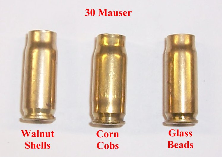

I'm 'cleaning' a batch tonight with crushed corn cobs; tomorrow I'll try a batch with glass beads and then do a side-by-side comparison to see which looks best...Hopefully, pics will show which works best in my vibrator/tumbler...

I finished my comparison of brass 'cleaning' in my Midway vibrator...Pic attached...
All three were 'vibrated' for 8 - 10 hours in the indicated media, with no additives.
(The middle case has a shadow near the base...That case has not yet been resized in the .223 Remington sizing die...It's as-fired...The other two have been .223 resized, and measure .372"/.373", while the fired case measures .385"...It expanded .012" from the sized .223 sized case when fired in my Mauser C96...)
They all turned out acceptably clean, but if I had to choose, I'd say the crushed walnut shells got the cases the cleanest...the insides even look cleaner...
