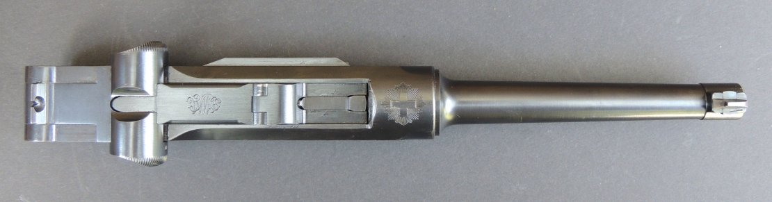

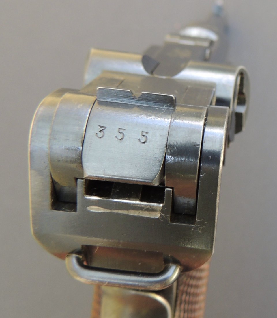

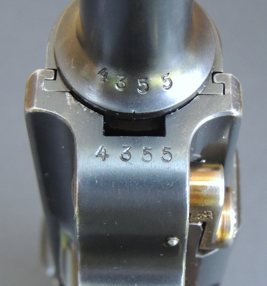

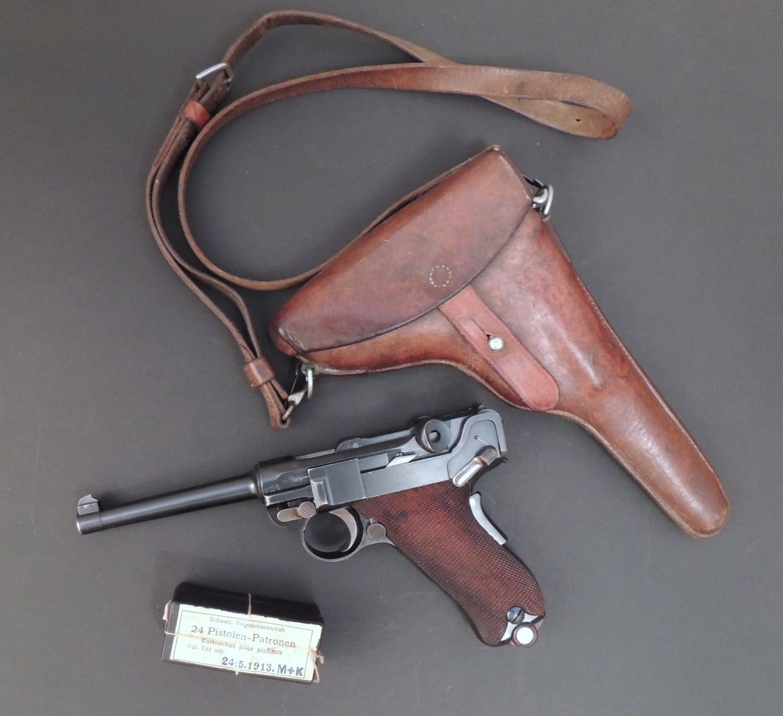

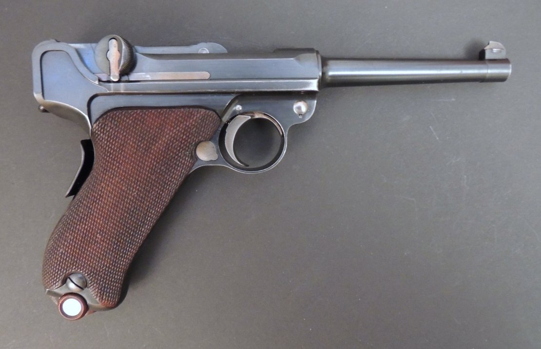

Swiss Pistol 1900 with SN 4355. This gun belonged to a lot of 1500 unnumbered parts sets which were delivered in 1903/04 from DWM to Switzerland. They were assembled in 1903/04/05 by the Waffenfabrik Bern (W+F). That was the last delivery of Pistols 1900 the Swiss Army. In 1906 the delivery of Pistols 1900/06 began. In 1934 the pistol was transferred to private possession.

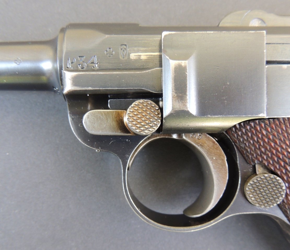

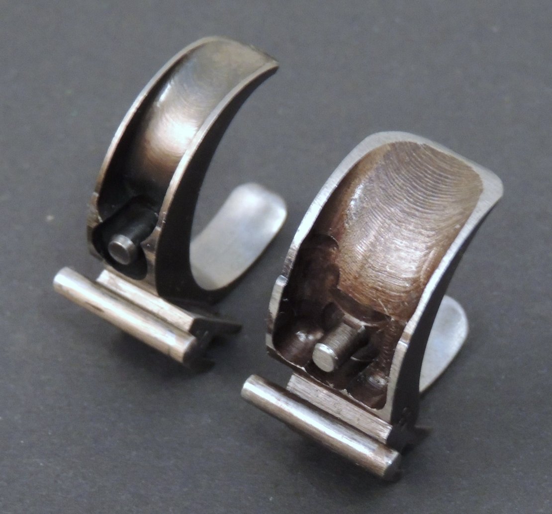

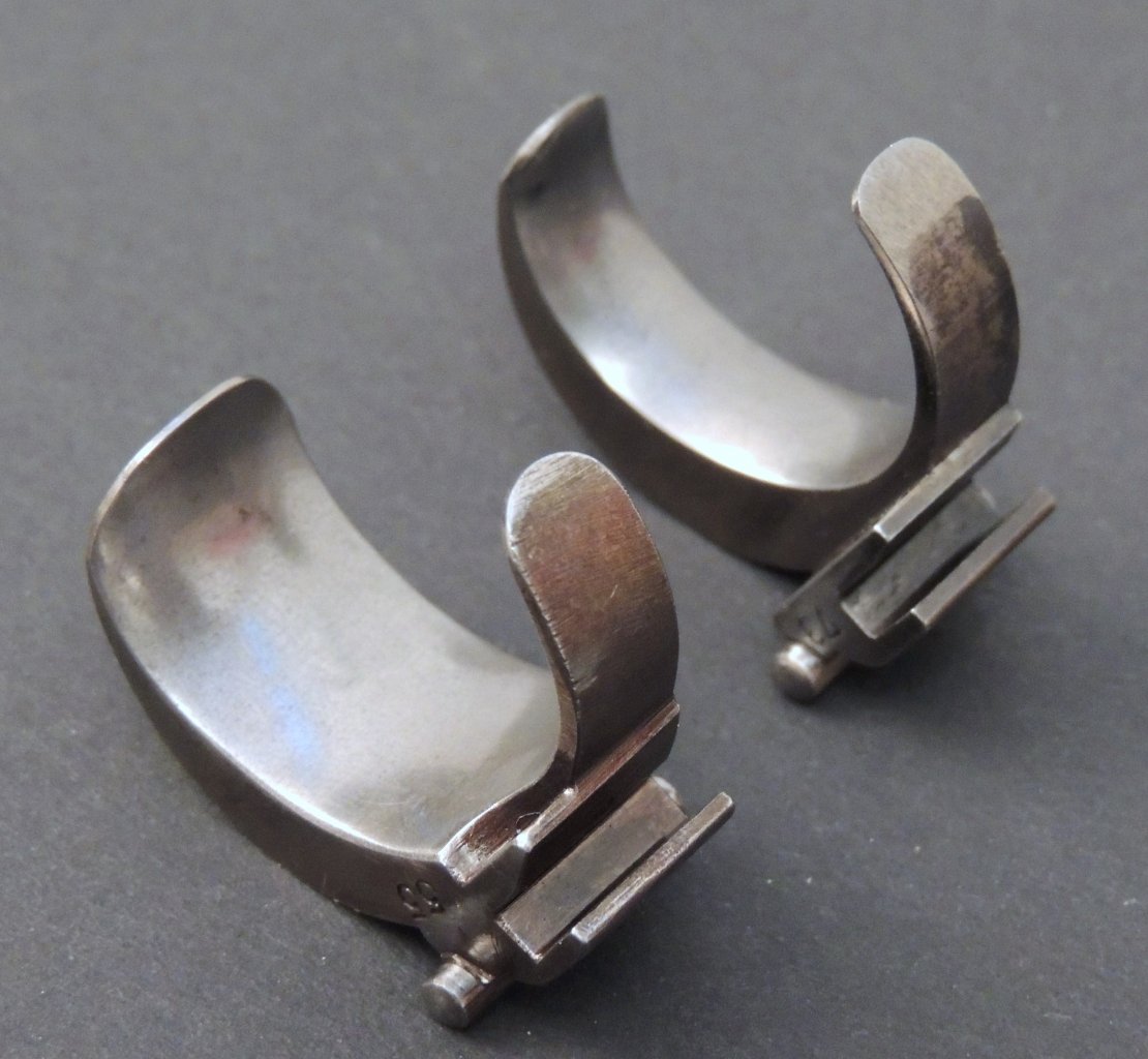

Typical for this variation of the Pistol 1900 is the wide trigger. One can find it on the last 1100 to 1500 Pistols 1900 (between SN 3500 or 3900 to SN 5000; the information in the literature is contradictory). The aim of the wide trigger was a better trigger control for target shooting. It seems that the wide trigger was only produced by W+F but not by the DWM.
The pistol has the reinforced extractor made by W+F and still the original "V"-shaped rear sight.
I’m interested in SN of Pistols 1900 with wide triggers below SN 4000.
Alexander

My Swiss Military Md 1900 with the properly numbered wide trigger is number 3989. I believe it was manufactured in 1905.

the director of the W+F wrote in a letter to the Kriegsmaterialverwaltung in October 1903, that during 1903 the W+F assemble 500 pistols (SN 3501 to 4000). Further he confirmed that he has received the drawings of a wide trigger in Mai 1903.
That could be evidence that the wide triggers came not before October 1903 and after around SN3500. On the other hand, it’s possible that triggers were changed afterwards by the W+F.
What I have learned during many years of collection, not everything which is unusual is not correct or a fake. Therefore your Pistol 1900, SN3185 with wide trigger can be absolutely all right. Even more, it’s an interesting gun because it’s unusual.

Bobba's text is based on the the books of Häusler and Rutsch and Rutsch is probably based on Häusler. I suppose that Häusler has made his own observations and collected SN. He writes, that we can find wide triggers between SN 3900 and 5000.
However, Sturgess who has made a lot of first hand research, has the opinion, that wide triggers were used above approximately SN 3500.
The Director of Waffenfabrik Bern writes on 17 October 1903 in a letter to the Kriegsmaterialverwaltung (Ordonance Department), that on 2 May 1903 he got the drawings of the wide trigger from G. Luger/DWM. And he also mentioned, that in 1903 the Waffenfabrik will assemble pistols with SN 3501 to 4000. (according to a document in the Swiss National Archive)
Therefore I think that the Waffenfabrik began to assemble pistols with wide triggers earliest with SN 3501. Earlier pistols were assembled by DWM and I think they all had originally normal triggers.
However, as I allready said, it's possible that the Waffenfabrik changed triggers of earlier pistols afterwards. Especially when the owner of the gun would have brought his pistol to the Waffenfabrik with a appropriate request.
Alexander

if i were a target shooter in the swiss army, could i not buy a wide trigger and place it on any gun. especially if they were made, as stucki stated, in switzerland and not at dwm?
are they interchangeable with each other or does the frame need to be revised to accept a wider trigger?
