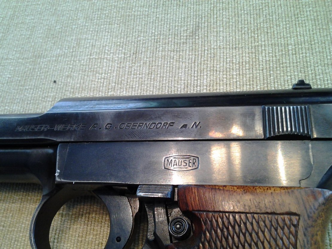

A little off topic but the another pistol and a 1944 K98 mauser he brought back. At some point he cut the mauser stock down a couple inches and put on a different buttpad. I'm trying to figure out what to do with that. Best idea i have so far is buy a new correct buttplate, cut and re-weld to fit and try and match the finish of the rest of the rifle. Its also missing the take down ring which isnt a big deal to replace.
mseitz24 is offline   Reply With Quote

From your photos, every one of your Great Grandfather's bringbacks looks modified. Both pistols look buffed and reblued and the rifle has the stock cut down, the sling nailed on with brads and the take-down escucheon removed from the stock. The holster cutdown was almost undoudtedly done by a GI, as a German would have never modified his gear in this way.
Until much better photos are provided, this is what I see.

Thanks: 20
Thanked 30 Times in 12 Posts
The Model 1910/22 Mauser pistol is not re-blued...they are always high polished...that is the original finish I think( I might be wrong, but I doubt it). I have one and they are beautifully blued. The Luger too does not appears to be re-blued...with better lighting I am sure you can tell variations of old blue colors. Any other opinions on this?

Frank, I'm not basing my assesment of the Mauser on the shine, but on the uneven surfaces, buffed out edges and muddled roll markings. Compare the crispness of your pistol's edges, roll markings and the slide's finger serrations to the pistol in question. I think it will become a little more obvious.
Again, I did put in the disclaimer that I was basing this opinion on the current photos.

Its probably the terrible pictures. I was using a flashlight instead of the flash because the flash was washing everything out. Im 1000% positive these havent been re-blued. The stock is cut down and take down disk removed or lost as I stated above. It doesnt make any sense to remove it so possibly lost in the war? I dont want to replace it as it wouldnt be original to me, it wouldnt be the rifle he brought back.

What I would do is...new pics with better lighting. Alanint, I understood the disclaimer...but even with the poor pics...I could see the bluing shades on the Luger, and the light use rubes around the the corners of the model 1910...which will show up when he posts better pics. That is why we are having the fun in discussing the love affairs. No intent on any slam...if that was perceived.

What caliber is the Mauser pistol? Correct terms would be a M1910/34 if in 6.35mm or M1934 if in 7.65mm. The serial suffix of your G date appears to be a lower case "b", as all G dates were in the "a" to "f" suffix range. Th
Unread 07-25-2013, 10:50 AM   #19
Mike,
Take your photos in indirect (shaded) sunlight. use a tripod, and the closeup setting on your digital camera.
Modifications (including cutting out the holster and any refinishing) reduce or eliminate any collector interest in a firearm or holster.
Tom, the pocket pistol is in 6.35mm / .25acp.

Tom is correct in that it is a 1910/34 mauser and it is in .25 cal. It is also an extremely late serial number being in the high 425,900 block and very near the transition from Crown N to Eagle N proofs. Eagle N's are very, very rare and a better photo of yours in the area of the front right side would verify one way or the other. As to the originality of the finish, I tend to believe it original, but as previously stated better pictures would be of benefit.
