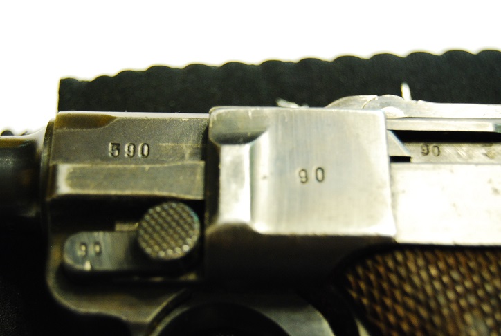

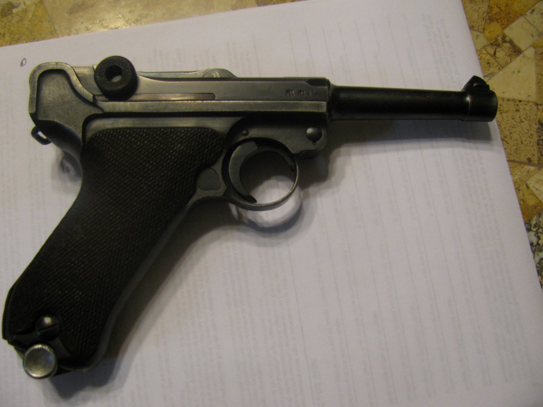

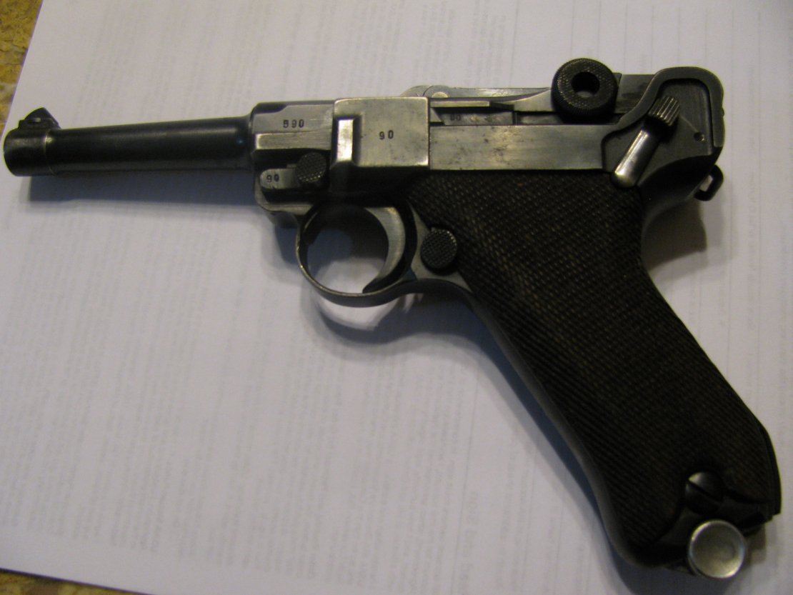

My father recently passed and this was in his safe. I didn't even know he had one, but if anybody could tell me some history behind it and a rough idea of what it is worth I would really appreciate it.
I am guessing the magazine is different because the S/N do not match the rest of the pistol and it has a marking I cant quite figure out but it has a "2" below the marking.
Also, it seems to me that all the small pieces with the 2 number on it are 90 and the S/N of the gun is 590.
Thanks in advance

welcome to the forum. I am sure you are going to find that you have a very interesting luger now in your procession. I don't know a whole lot about Krieghoffs, so Im sure so others will fill you in a little better.
But as for the shape with a 2 under it is an eagle figure surmounting a numeral "2'. According to the book Im looking at it was something to do with the Luftwaffe contract. I attached a couple of pictures with the paragraph talking about the eagle over the numeral "2".
I am sure others are going to want to see some extra pictures. The top of the toggle, maybe the front of the trigger guard and barrel. They love seeing close ups of the markings, especially the one you are referring to.
As for the SN, yours being 590 and seeing the number 90 on the rest of the parts is normal. As for the magazine having a SN 8399, yeah its not matching to the gun. But from what I see in the pictures its definitely a nice piece. These particular lugers are usually on the high end when it comes to price. You can check out web sights like "simpsonsltd, legacy-collectibles and phoneixinvestmentarms to get an idea of what people are getting for them.
Enjoy your new luger and sorry to hear about your father.

Lots of pictures. The suffix letter has me worried, as krieghoffs never had suffix letters...

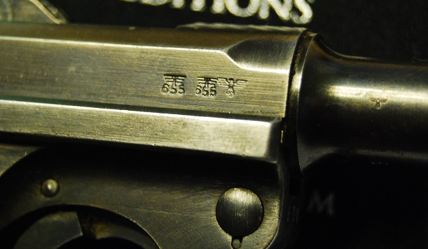

I think it's a Mauser with a mismatched toggle on it, as the acceptance markings look like eagle 655 on the right...

Ed, I think you may be correct on that one. When you zoom in at the pictures, it looks to have the hump on the back side. Also it looks like next to the E/655 I think I see the Nazi style eagle over the swastika, and maybe one on the barrel. That's my bad on the initial call.

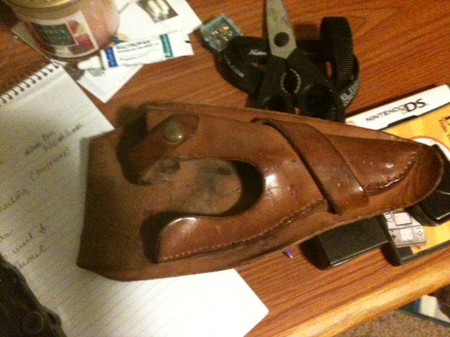

I'm curious about the holster? What ya'll think on that?
Unread 08-04-2013, 10:06 AM   #5
I think post war for sure, maybe Luger, maybe not, but very cool holster.

Hi, and welcome to the forum. I'm afraid we don't have good news for you...
Take better lit pictures in shaded (indirect) sunlight. Use a tripod, and the closeup setting of a digital camera. Don't use the camera in a Smart Phone. The white background is causing your camera to underexpose the Luger.
Your Luger has a Mauser manufactured and accepted receiver. The frame is Mauser also (it has the Mauser "hump" shape at the rear of the ears). Most of the rest of it is probably Mauser as well, but E/2 marked parts would be from a Krieghoff. Why no photo of the top of the receiver and toggle?
Clear pictures of all the external markings are needed to help much more.
If there is a Krieghoff toggle on this, it is a mismatch. A mismatch shooter doesn't have a fraction of the value that a matching Krieghoff has, even if it does have Krieghoff parts in it.

I was just reading in Kenyons book "Lugers at Random" The attached PDF in this thread noted a proof mark 46. If the toggle had a "42" on it, I think that would go with the rest. Code "42" were made from 1939 - 1940, so he is in that ballpark. SN range can be 1 to 5 digits with or without a letter. And there were up to 50,000 or more manufactured. He mentioned that the grips are plastic in the PDF and kenyons book mentioned that code "42" had either walnut or plastic grips.
Probably miss match toggle and magazine.

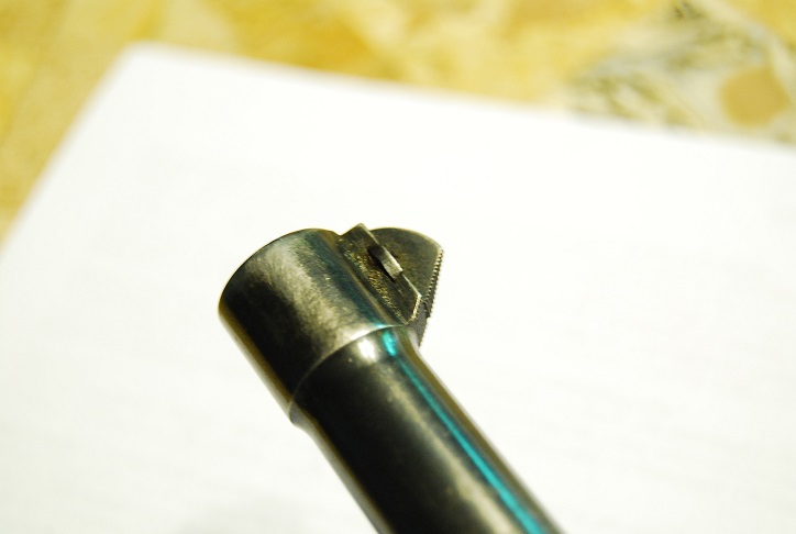

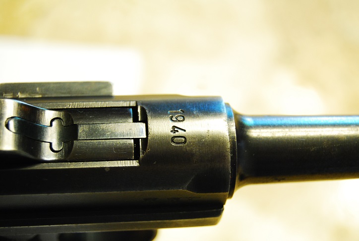

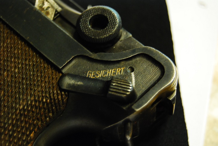

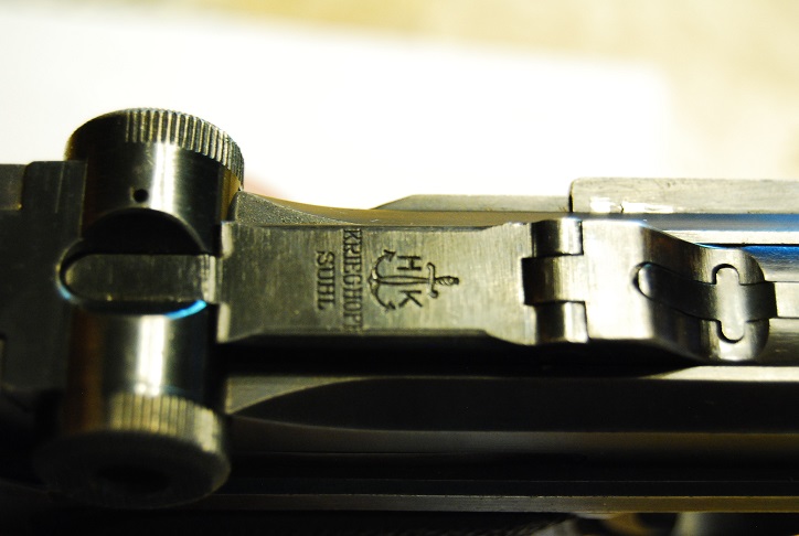

With the camera I had I couldn't get any pictures of the marking to come out. I borrowed my fiance's camera whose camera is much, much better than mine and was able to get these.
Thanks again

but as for the new pictures, it definitely has the mauser hump. But I don't see the first marking as for SN on the toggle in any of the pictures where a SN is usually stamped. Does H&K lugers stamp them differently?
Unread 08-04-2013, 02:11 PM   #12
Hi Frank, belated condolence on losing your father.
Yes - much better pictures.
It is a Mauser Luger with the forward toggle replaced with a Krieghoff one.
One warning. The axle that holds the forward to rear toggle has a retention pin that fits in what looks like an empty hole on top of your toggle. This pin needs to be in there for safe operation.
The correct toggle for your Luger would have a "42" concealment code (which stood for Mauser).
The full serial number of your Luger includes the suffix letter on the front of the frame. It's "590e" from what I can see.
It is sometimes possible to find correct matching toggle parts. If this is the only mis-matched part, it would pay you to keep your eye open for one. The Luger looks to be in original finish. Don't see any E/2 marked parts...
These Mauser made Lugers are very high quality. If the toggle was properly fitted, and you have it checked out by an experienced Luger gunsmith (to get that axle retention pin back in, and look for any other issues) you'll have a very nice 9mm shooter Luger. Find a correct forward toggle, and the value will double.
BTW, the inside of the trigger plate should have the number "6" stamped in it.
