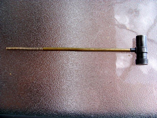

With oiler! How does one use the oiler without making a mess?

The "dipstick" was meant to be used as a crude brush. Dip it in the oil well and then apply drops to all the typical areas needing lubricant on the pistol.
This is an era where lubrication and cleaning were viewed seperately.

the pattern on the lid normally has dicing patterns in 2 directions that cross each other. looks like a repro item. no original.
Ben is correct..this is NOT an original rod IMO. You will also notice the brass rod is jointed. It is screwed into the stub projecting from the grease barrel.
I have mentioned this many times before but since it's come up..I will do so again. The Germans cannot have manufactured ANY rod with a screwed in shaft. Any shaft manufactured this way will unscrew itself and simply slide right out the end of the cleaning rod sleeve and be lost.

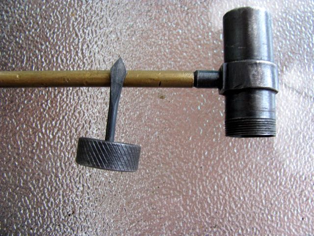

Default For You Jerry!!
A nice close-up!

Unread 06-25-2013, 02:00 PM   #15
Neil Young
Neil Young's Avatar
Join Date: Jun 2008
Location: Scottsboro, Alabama
Posts: 552
Thanks: 567
When you look at that close-up, it is apparent that the work is pretty crude. Even I can do better than that.
Unread 06-25-2013, 02:17 PM   #16
Default My other!
A little different. They both look real to me!!

Unread 06-25-2013, 02:21 PM   #17
BTW, I used the word "oil" but I too agree that these were filled with grease.
