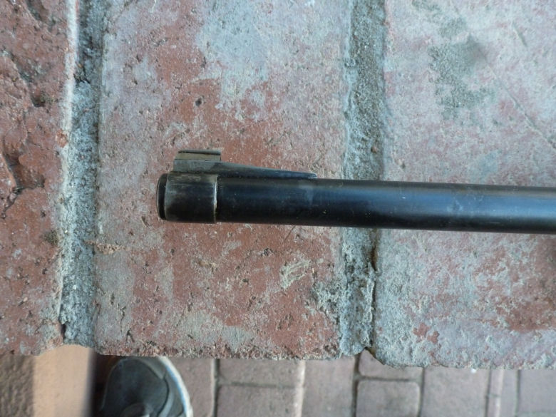

I am trying to restore a 10 inch barrel which was improperly chambered - 0.025 to deep. Got it turned back one thread, re-threaded, and now I need to deepen the chamber by about 0.024 inches. Does anyone have a reamer they would be willing to sell me? Something with enough life to do 0.025 inches. Thanks. Dennis

Interesting barrel...Did you machine it yourself from a blank???
I have a 30 cal blank and was thinking of a 30 cal artillery barrel...
How about some pics???

I actually got this barrel off ebay advertised as 'rifle barrel with wooden case' When I looked at the photos it was an aftermarket barrel from probably the '30s with nice front ramp sight and no rear sight. The wood case looked like a shoulder stock but was not. Nice though. Barrel had the barrel extension attached. I just popped sear set and ejector onto the barrel/extension and shot it. Punched primers and ejection problems resolved into excessive headspace. Don't know how to post photos or where.

We shall see if I can attach photos. Please excuse the barrel clamp - it is not a factory rear sight. Dennis. I just do not like having to work to a 3 day rental where the cost to me is about 1/3 of the new price. I am gone to much to guarantee I will be somewhere with the barrel chucked up, supported and trued up on the day the reamer arrives.
