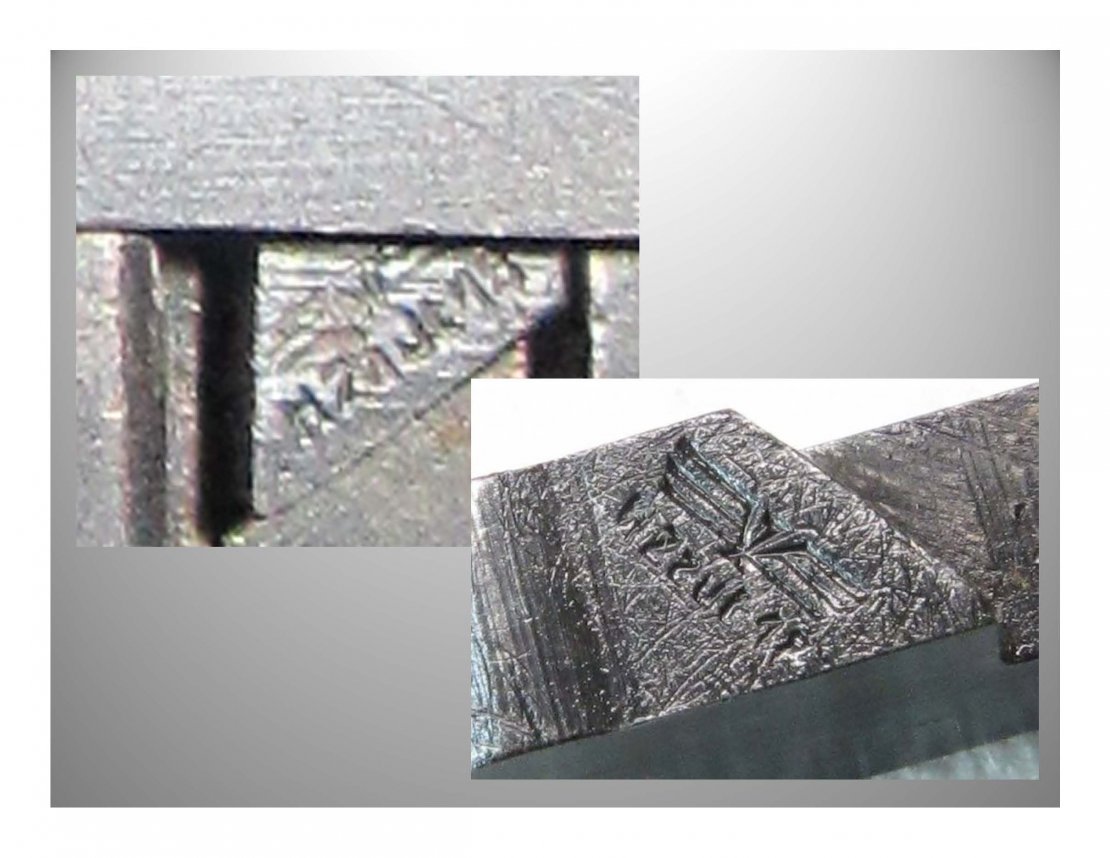

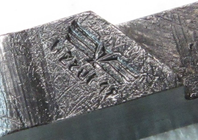

Found this stamp on a sear bar, an eagle with some jibberish underneath. Does anybody know what this is?
Unread 05-05-2013, 09:06 AM   #2
Looks like a double headed eagle. I'm thinking some war time Eastern European marking, possibly Hungarian or something like that?
Unread 05-05-2013, 10:46 AM   #3
Olle, could this be one of the early 'long' sear bars that was shortened and then marked to indicate where/who/when???
Unread 05-05-2013, 12:55 PM   #4
HZaJt18 (or at least as much of it as can be crafted into a very small stamp). Heers Zeugamt (army arms depot), Ingolstadt (city of Jngolstadt, note the J pronounced as I), depot number 18. Straight wing eagle, in use after mid-1937.
Indicates a replacement part insalled at the Zeugamt. Weird "double eagle" look is a photographic effect from photographing a very deep stamp under a strongly oblique light source.

Heres an example of mine next to yours. Mine has the same stamping as yours it appears

Thanks, that solves the mystery! It's pretty impressive how they managed to put that much information into a tiny stamp like that.
