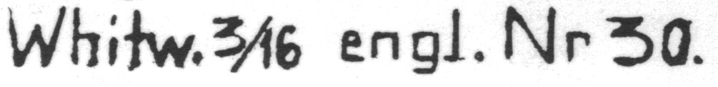

I need to make a set of grip screws with a slightly larger head...I see from the Blueprint CD that they are a 3/16" Whitworth thread...but it doesn't say if coarse or fine...[24tpi vs 32 tpi]...
Does anyone know which they are??? I'm tempted to just chase the grip frame holes with a #10 SAE tap and make my screws Yankee...
Unread 03-08-2011, 09:12 AM   #2
Hugh Clark or Tom Heller or Ted Green should be able to answer this question for certain, but I believe that the "Nr. 30" in the description of the screw on the blueprint may actually mean 30 threads per inch...
I would suggest that you wait for one of the lugersmiths to answer before using your #10 SAE tap.
Of course it is your frame, and if you want to change the screw type Rich, that is entirely up to you.

Unread 03-08-2011, 06:18 PM   #8
All right, let's not get frivolous here...This is serious business...
Originally Posted by SIGP2101 View Post
How about using a simple thread gauge to find out.
Because there are only 3 threads on a grip screw, and the difference between 30 & 32 tpi won't show up until you get more threads to measure...
The blueprint clearly says Whitworth (pic below)...In 3/16" Whitworth, 24 tpi is coarse, 32 tpi is fine...There doesn't seem to be any 30tpi...as standard, anyway...

Unread 03-28-2011, 10:36 AM   #16
You can all postulate what the thread is "close to" but as mentioned above by the OP, The original German military blueprints CLEARLY state that the screw is Whitworth 3/16 English Nr. 30... The use of any CLOSE substitute is still going to bind when you tighten it, and will possibly mess up the frame threads if you force it...
I do not recommend subtituting this screw with something "close".

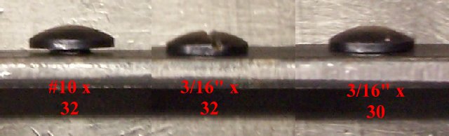

While on the subject, I need another grip screw for a 1913 Erfurt. This is the other that I am missing!
