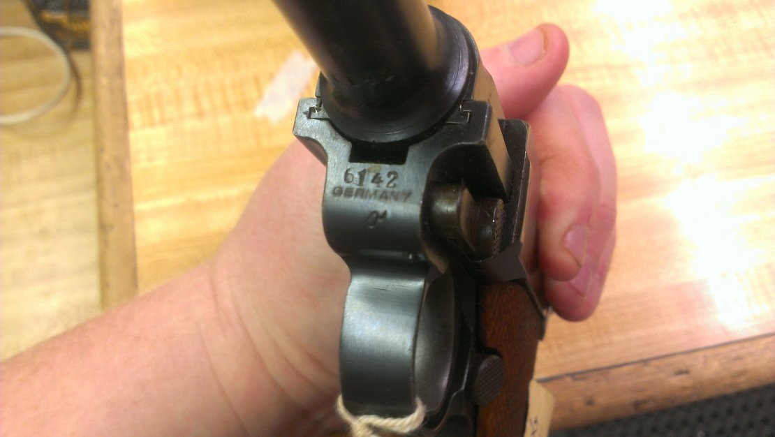

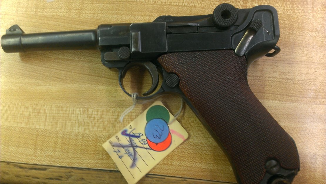

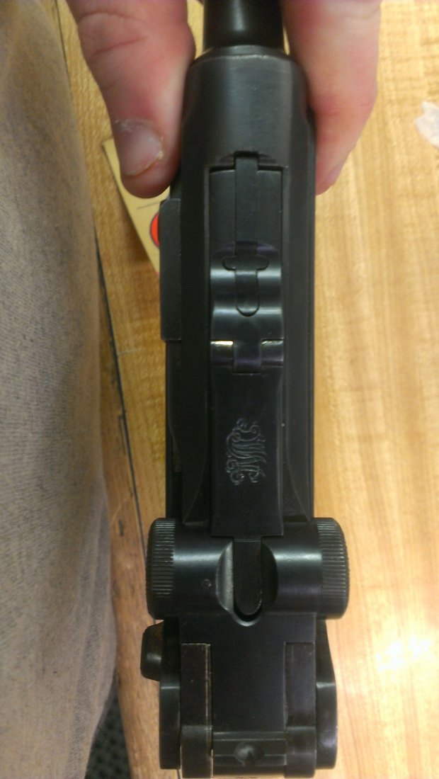

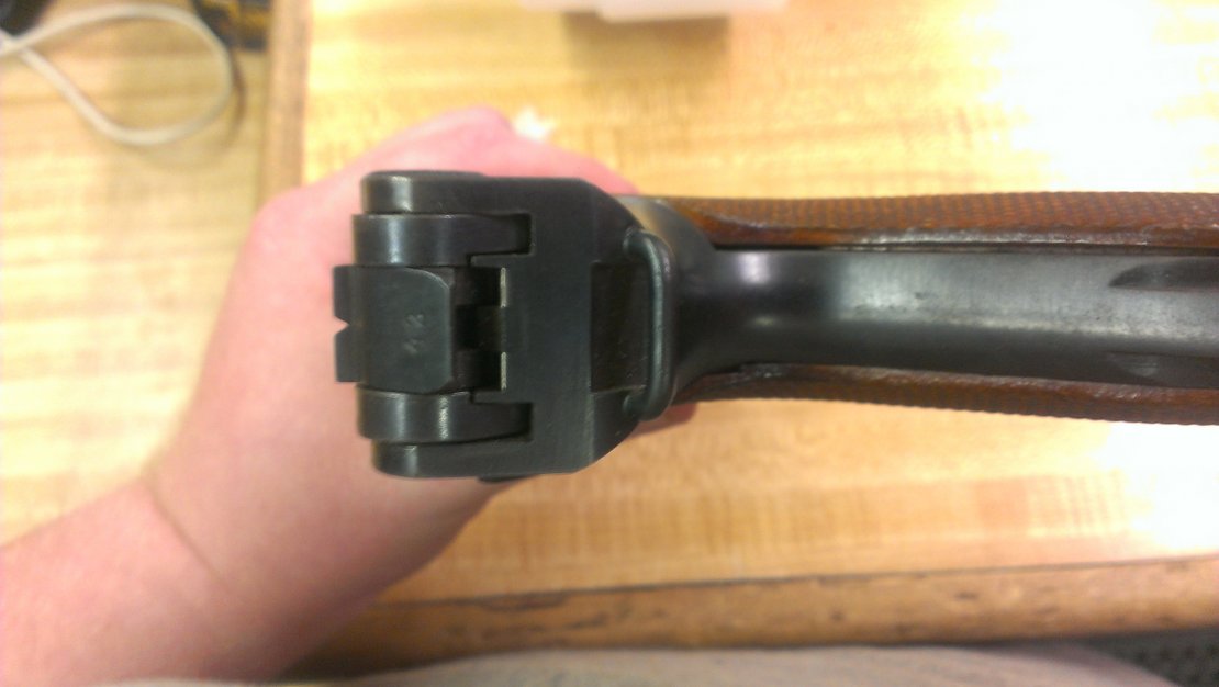

Below are some photos of my friends Luger, he doesnt know anything about it so any input would be great. All the serial #s seem to match. Thanks

Hi Nate, Welcome to the forum! Your friend's Luger is a G date (1935) made by Mauser. Unfortunately, it has been refinished, the small parts (trigger, thumb safety, take down lever and magazine release) should be strawed, not blued over. This really hurts the value to collectors.

As Norm says, it has been refinished, but apparently a long time ago. I'd not relegate it to the shooter class, but the value has been compromised. A fairly uncommon date of mfg. Does the mag match? Do I see a holster in the background?
You didn't request value estimates, but I'm thinking that is what you are after. I'd think that $1200-$1300 is pretty close. Considerably more than most refinished Lugers.
