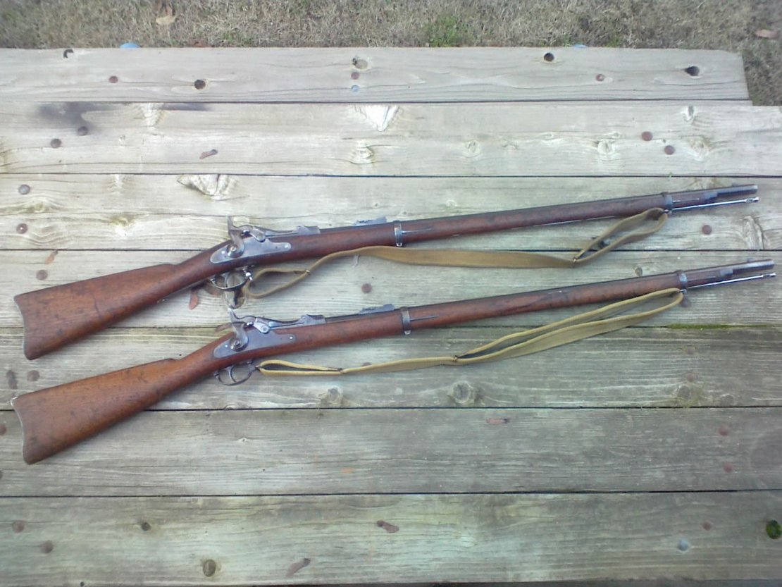

I've switch gears lately since I'm afraid to use what ammo I have left and have been shooting my 1873 Springfield Trapdoors. I bought them a few years back (one for me and one for my son) cheap because they are parts guns. But they go BANG real loud and in a great big cloud of black powder smoke that gets allot of attention at the range. I can shut the whole place down and nobody will shoot again until they all have come over to see what I got. Of course I'll let anyone who asks shoot the 140 year old rifles and they allways love it. Kicks like a mule.

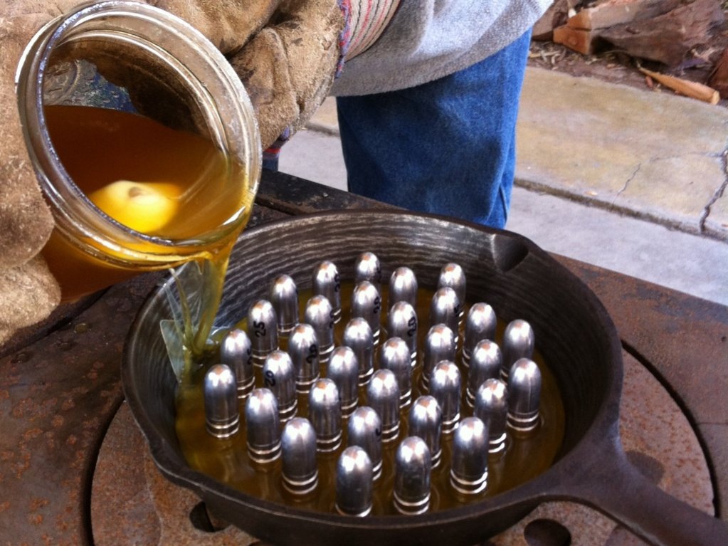

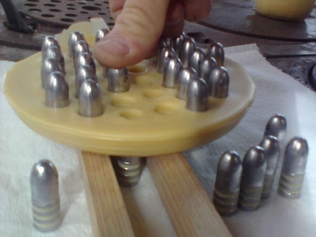

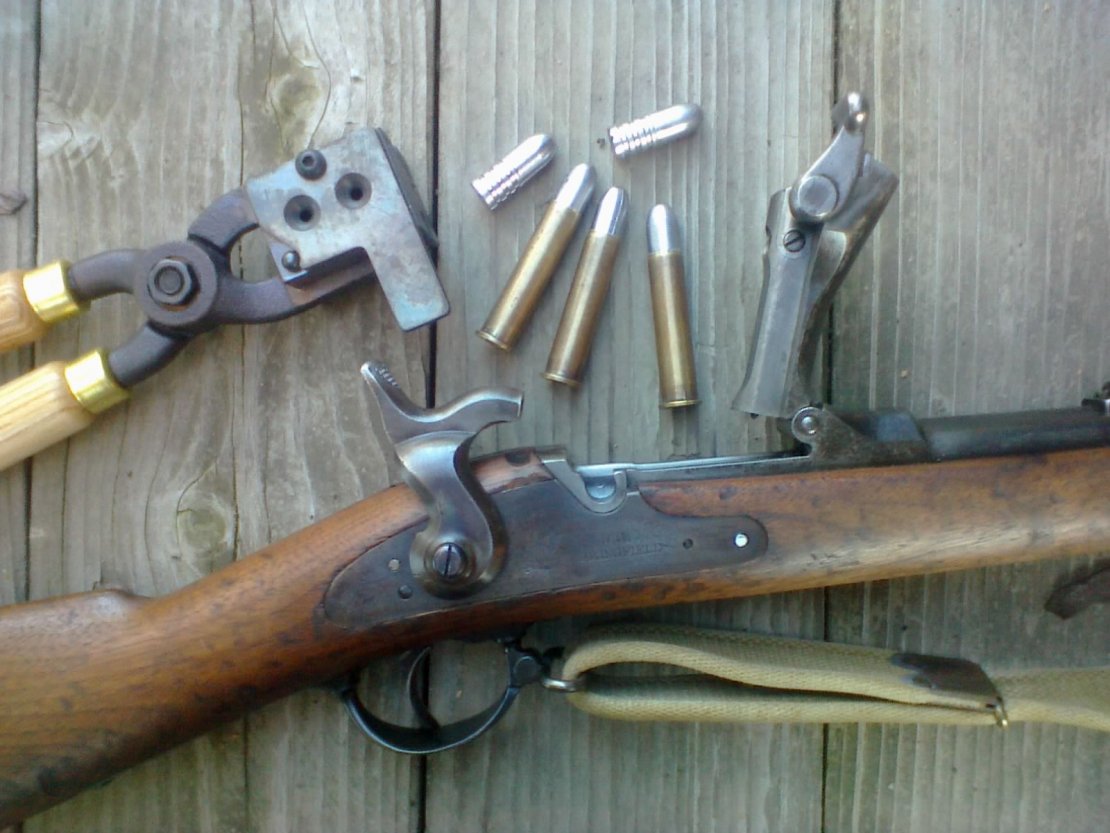

I cast my own 500 grain gov't bullets and compress 70 grains of FFF Goex BP, following directions in Wolf's book. I pan lube the bullets and assemble the cartriges with a Lyman 310 hand tool and some modified dies. Cheap shooting.
Sounds like a whopper!!!
What exactly did you have to modify in the dies??? RCBS dies or other???
Not exactly sure what you mean by 'parts guns'...They look complete...

By parts guns I mean abolutely nothing on either gun is "correct". They are assembled from the components of several models. The lockplates when I got them were Bannerman jobs and most of the hardware is wrong. One gun had a slightly bent barrel (they actually made a shovel attachment for these) and cracked stock to go with it. The bent barrel I carefully straightened and the rifle shoots no worse for it. I paid $200 apeice.

I use a SAECO mould for the M1881 bullet. With 20:1 alloy they drop from the mould at 502 grains and .459 dia. My Chrono clocks them at 1300 fps. and I can get a 3" group at 100 yards from one gun and 4" from the other, which is as good as my eyes will let me shoot any rifle with open sights.
I load them up following Wolf's very exacting recipe in his book "Loading Cartridges for the Original .45-70 Springfield Rifle and Carbine." They are a FULL power load and may or may not be truely wise to use in a 140 year old gun. His book also covers the 405 grain M1873 cartridge and some interesting 3 ball loads I have yet to try, as well as some others.
Of course any conversation about loading needs to include the warning "This is just what I do and have gotten away with so far. I DON"T recommend anyone else try it."
