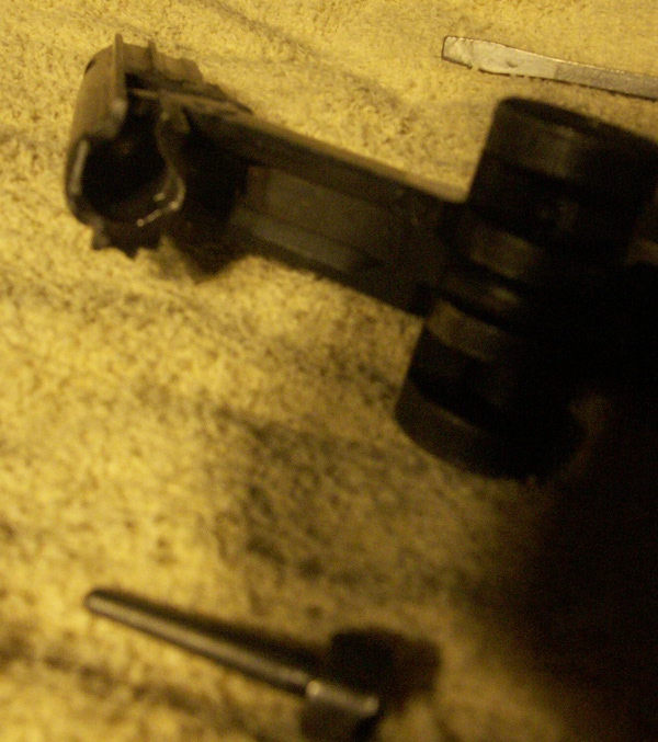

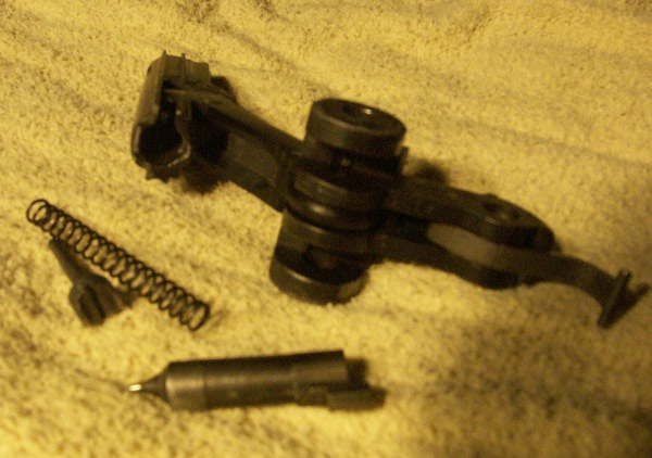

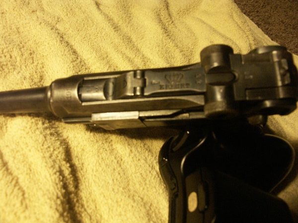

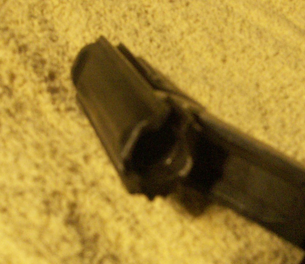

I've uploaded pictures of the gun and the damaged block.
I took the gun to a gunsmith who has worked on these guns before and he said that based on where the damage is that is should be repairable, and safe to use after the repair.
Only the very back of the block is damaged, and it's in a low stress area.

This can be repaired by a skillful welder with little damage to the original finish. If you are to further fire this pistol. I would suggest an entirely new toggle train.
