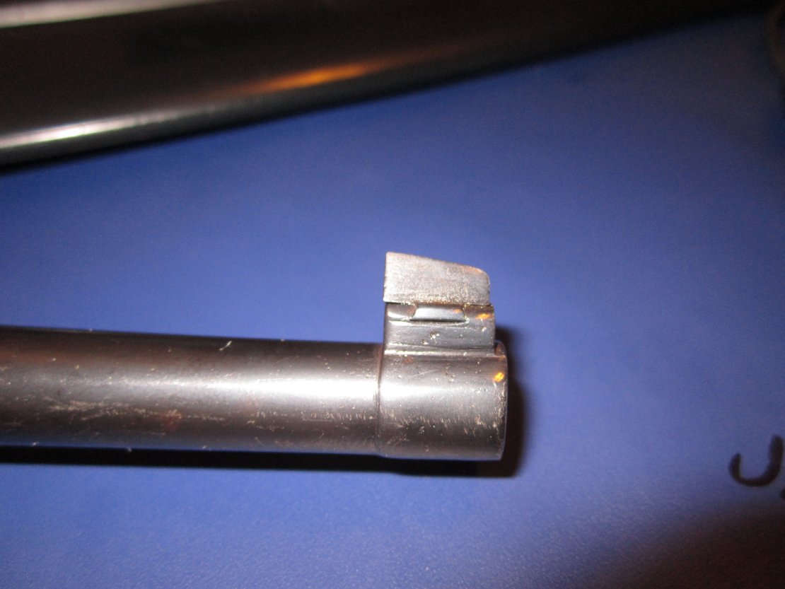

Tom, I have a shooter, as do you. I replaced the front sight with a Mauser 98K and filed a square slot in the rear sight. Makes my "old" eyes see the sights a lot better. I had to shoot and file the front sight to bring the fired group to the point of aim.
I kept the original front and rear toggle and replaced them with the parts I modified.
Works great!!

The front sight of a P-38 has a flat top and would not only match the square notch you are proposing, but would actually fit the dovetail of the Luger front sight base. It is a great modification of a "shooter" class Luger.

Like Frank said, the front blade from a Mauser K98 will fit that "Euro." dovetail groove on the Luger. I had to use one to bring my Navy down quite a bit.

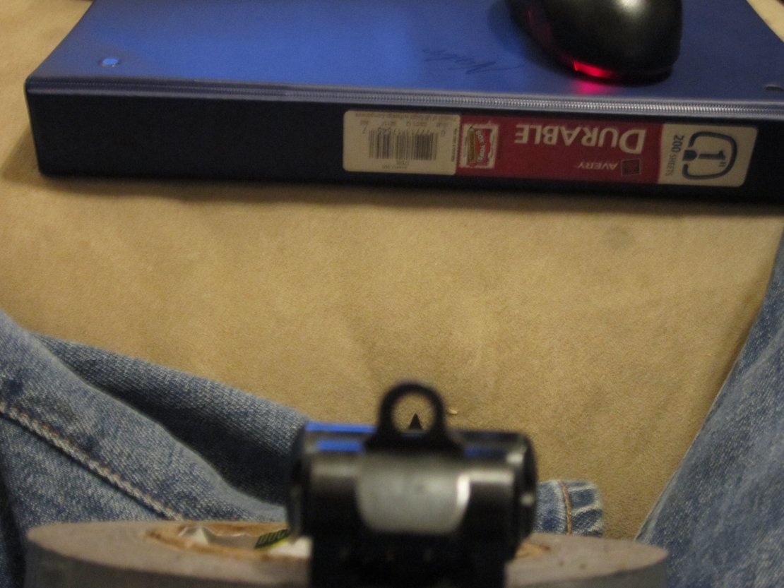

Many of the Finnish lugers that I have seen had sights modified by the Finns to make them more useable. They added what looks like a P-38 front sight and modified the rear sight to a "U" notch. My Finn has just such sights and they work very well....

I bought a 1900 AE awhile back that had a rear sight modified to a peep sight. It has a dove tail cut into the toggle and the peep sight just slides right in. I do believe the front sight was replaced as well. But shooting it with this set up is pretty user friendly once you get used to it.
Unread 01-22-2013, 06:33 PM   #13
Reminds me of the "Ghost Ring" rear sights currently sold by Brownells. I have them on several guns.
