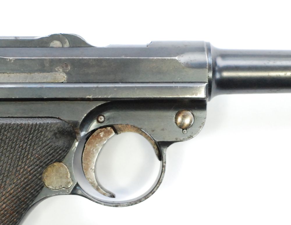

For a 1906 Navy is there any good way to derive the Serial number when the places where the four digits are placed have been ground off? It appears to be a first issue, altered and the 3rd & 4th digits are where they should be; on the small parts. Therefore it's hide and seek on the first two numbers. I can't remember if the side plate has a coded portion of the s.n. or not. How illegal is it to have a gun with the real s.n. removed? Anyway to reliably re-affix the s.n.?
thanks
Jack
Unread 01-23-2013, 06:08 PM   #2
Thanks: 2,078
I looked at this luger last night, did not know it was on gunbroker
technically a gun before 1968 does not require a serial number, I wondered about the process of having one taken off that was already there.
you can NOT see the first two of the serial number with a loop, from the barrel or the front of the frame. AND the rear unit marking I am sure is missing
Its a very nice 1906 otherwise....

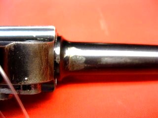

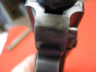

Anyone should be able to look at these two photos that are in the auction and see that the number was intentionally removed.
The perpetrator not only removed the number from the front of the frame, and the bottom of the barrel, but was sloppy enough that he allowed the file or abrasive device that was used to touch the bottom of the barrel where the witness mark is located. See the white spot at the witness mark?

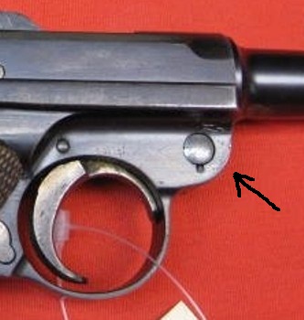

While I do not have a good profile photo of a Luger long frame in the area of the takedown lever, If someone does have a good photo, please post it here and compare it with the one in the auction and you will see the not so subtle change in the normally graceful curve of the front of the frame...
I stand by my evaluation. This gun is bad news. IMHO, this FFL dealer has placed his entire career and reputation in jeopardy.

Hi John, Here is the view you requested. I don't think that much metal has been removed, it looks worse than it really is. It's certainly nothing that a good restorer couldn't take care of. I've heard that there is a chemical method for revealing serial numbers that have been ground, and less metal seems to have been removed under the barrel, so restoration is not impossible. However, I have no idea what the legal position would be.
Regards, Norm
