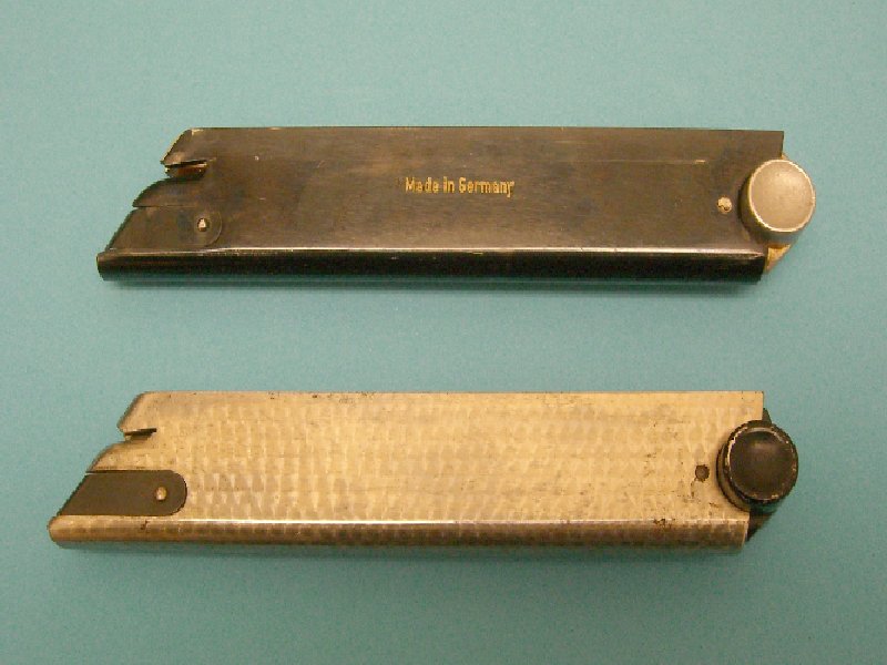

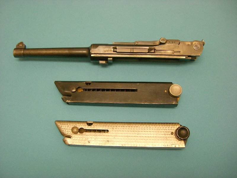

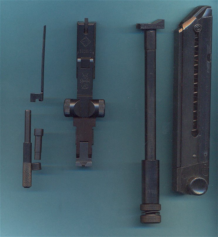

I have been following this thread with some interest. I applaud anyone that takes the time to make a Luger .22 conversion a workable and enjoyable endeavor. David, I wish you much success in your "tinkering"...if you get something to work reliably you will have attained wizard status.
I have some "project" pieces that I have accumulated for much the same effort that you have undertaken. I acquired an American Eagle barrel/receiver that someone with a bit of skill modified. The original caliber was 7.65mm, but the converter bored it out to 9mm to accept a 9mm/.22 caliber barrel insert that was permanently installed. I then happened upon a relatively scarce .22 conversion toggle assembly with an adjustable rear sight. You can see from the photos that the sight is adjustable both in elevation and windage. The blade of the sight is a rough replacement, but I will eventually replace that with one a little more refined.
I have also acquired a couple of magazines to play with. The 10-shot is an early post-war piece that is pretty nice. The 5-shot example is from a military practice conversion unit, stamped Eagle/132 on the spine that someone "thoughtfully" engine turned the body. In defense of their efforts, I suspect it was to improve a rusted or deteriorated exterior. It looks kind of neat so I won't mess with it.
Someday when I get a few more of my projects out of the way, I hope to put these pieces together on one of my guns and burn up some ammo!
Keep up the good work David. I hope you find the right combination.

I consider the time I spend "tinkering" to be just about the most satisfying time of my day. I'm looking into the possibility of working for GunBlack in Interlaken, NY. I called for a quote for bluing my barrel insert adapter sleeve, and he said, laughing, "A 12 pack of beer!" They finish thousands of parts in some orders, so I guess that custom work is the exception rather than the rule. They offer Parkerizing, bluing, and some other surface treatments and coatings, I see by their website. Anyway, it looks like it will be easy to have my sleeve match the rest of the kit. I'll ask about salt bluing when I go up there.
Ron, If I'd encountered a rig like that one, you bet I'd have tried to get it! A novel approach, to adapt the barrel to the kit, instead of the other way around! What's the condition of the Luger--did someone to this to an all matching? I presume the original top end is gone... And I think that adjustable rear sight is just the cutest thing.
The mag with mine is a 5-shot. You can put eight into it; there's room. But the way the follower is shaped presents the 1st of six or more rounds at an angle that dooms proper chambering before it starts. I've noticed that the Erma pistol style of 22 mag has a follower that seems to pivot according to how many rounds are in the mag, maintaining a reasonable angle of pre-launch, let's say, for each round that sit at the top of the mag. Uh-oh, now I'm thinking 10 shot for a conversion mag by using some guts from one of the 10-shots.
I would be interested in a spare conversion kit mag, to compare the performance of another individual. And an extra is also good to have.
