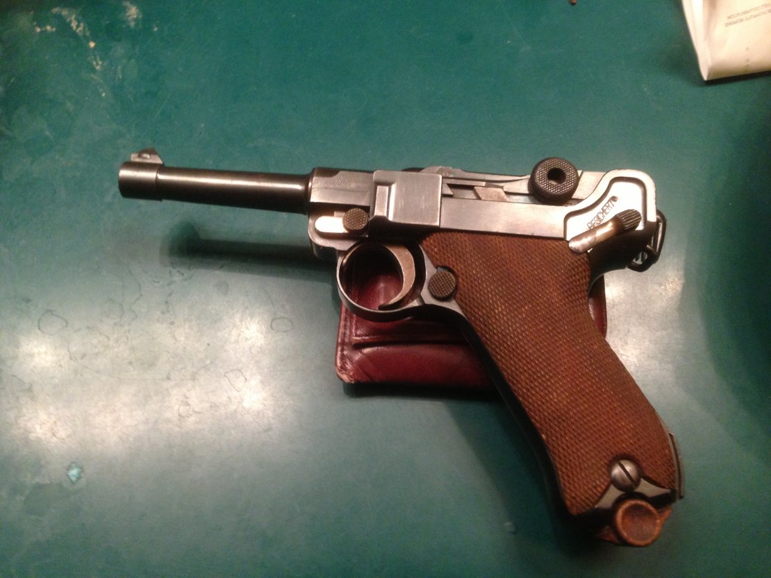

I just inherited a .30 cal mauser luger. Serial #4444 with crown N symbol. 44 and proof symbol on all parts. Strawing appears bright and strong. Finish very good. Handle grip very good. Any help determining what I have would be greatly appreciated

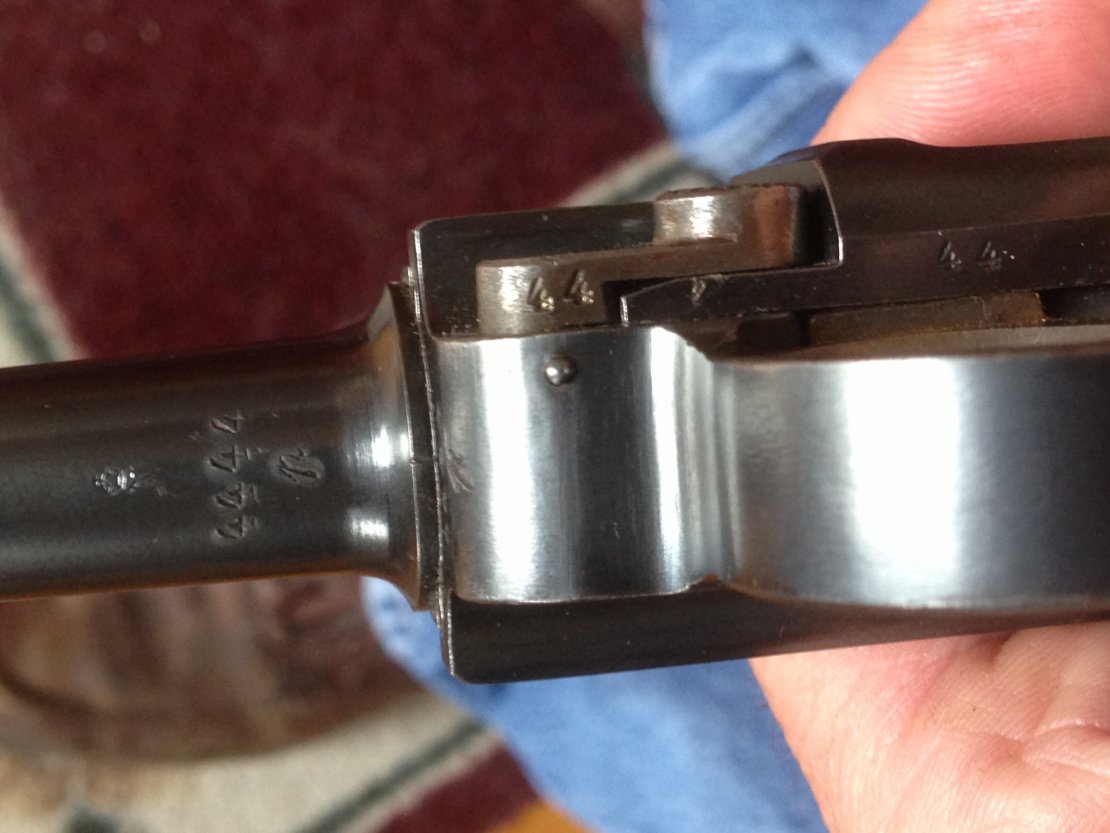

Some pictures, especially of the serial number, it should have a suffix under the sn.

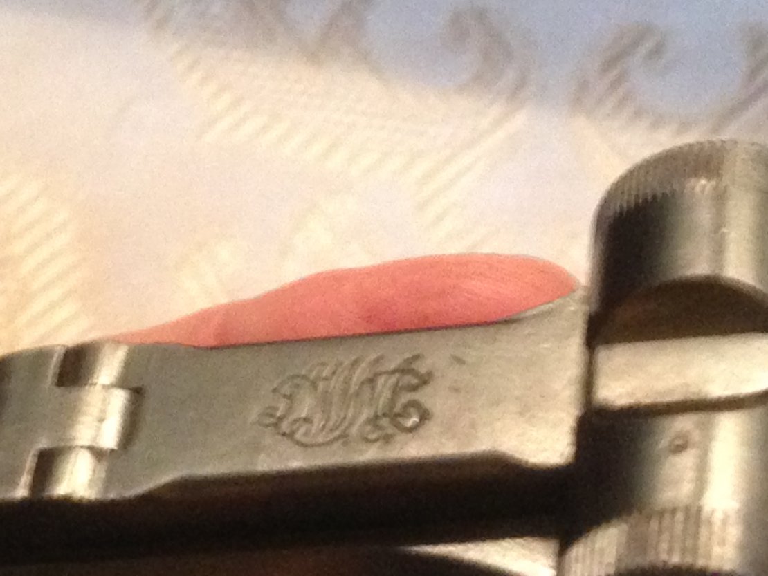

does it have the 'Mauser' logo or the scrolled DWM?

If a DWM it's likely an Alphabet Commercial from the 1920s.
If all matching and in good original condition pricing varies from $600 to $900.

Interesting DWM in a Mauser broom handle stock/holster
I think that is an "r" suffix, but can't tell

The stock and harness are not related to the Luger in any way, but have some value by themselves. the Luger appears to be a nice Commercial, and Marc hit it dead on at $600-$900, probably toward the higher figure given the condition. Very nice!

Seeing the pictures, I agree with David's evaluation toward the higher end of the price range. Nice.
I think that the suffix is a "p" making the full serial number "4444p". That should put manufacturing date toward the end of 1923 or beginning of 1924.
The halos on the barrel serial number confirm that it is in it's original finish.

I was trying to educate myself here by reading the history of the luger. I thought I had read that military lugers were stamped around the piece with the last two digits of sn, as mine is. By commercial do you mean non military? What are the differences between commercial and non? Is it possible to research a sn to determine date of production? Hate to be so bothersome but you guys appear to be the experts. Thanks
hardspunned is offline   Reply With Quote
Unread 11-14-2012, 10:13 PM   #11
Your pistol was made for commercial sale. It's identifiable by several characteristics, including the location of serial numbers, the Crown/N commercial Nitro Proof marks and it's caliber.
It was not made for military issue.
You may also find the word "GERMANY" or "Made in GERMANY" stamped on it's frame, indicating it was made for export.
Unread 11-14-2012, 10:13 PM   #12
Yours is marked in the commercial manner, military is marked more obvious.
Yes, if we know the suffix, your year can be guessed.
