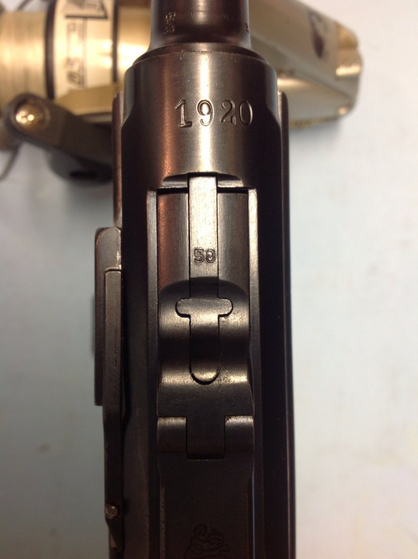

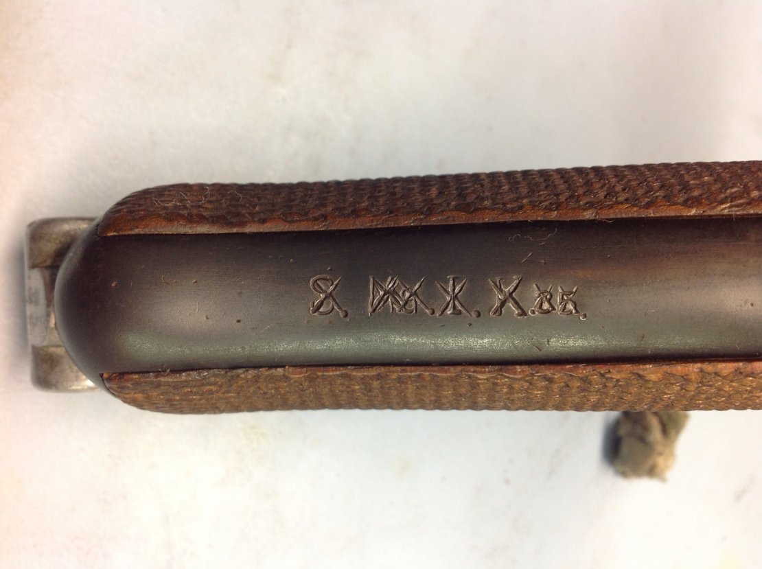

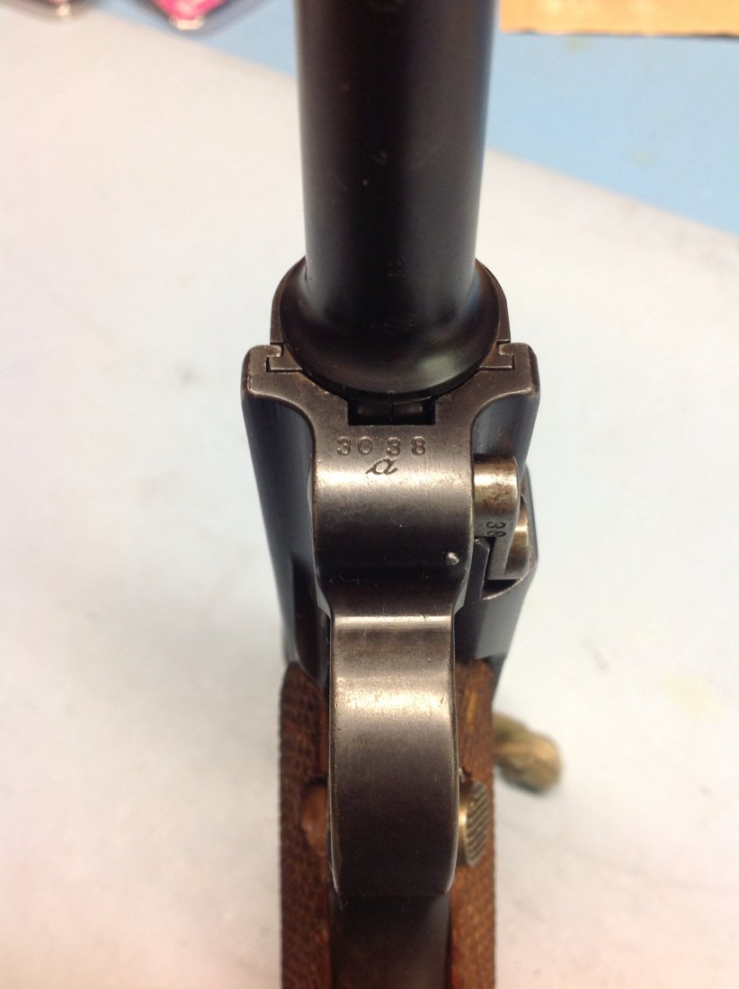

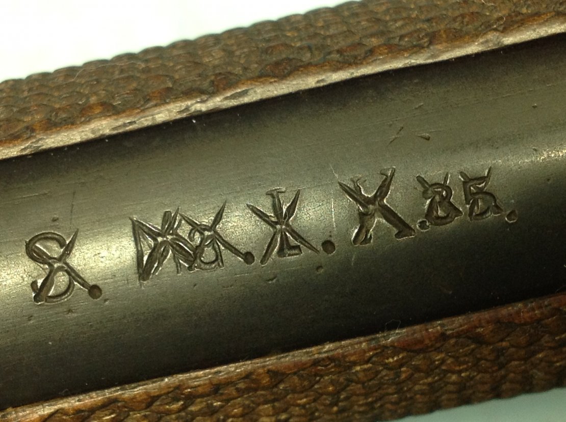

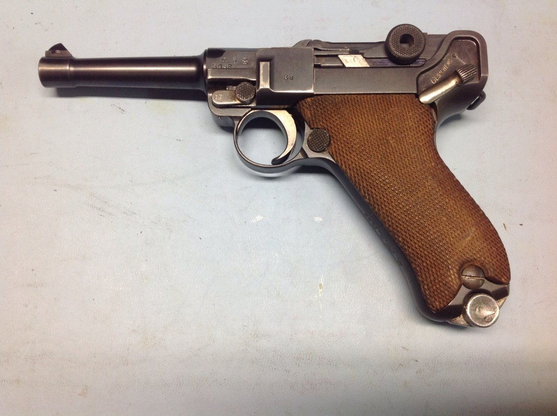

Hello,

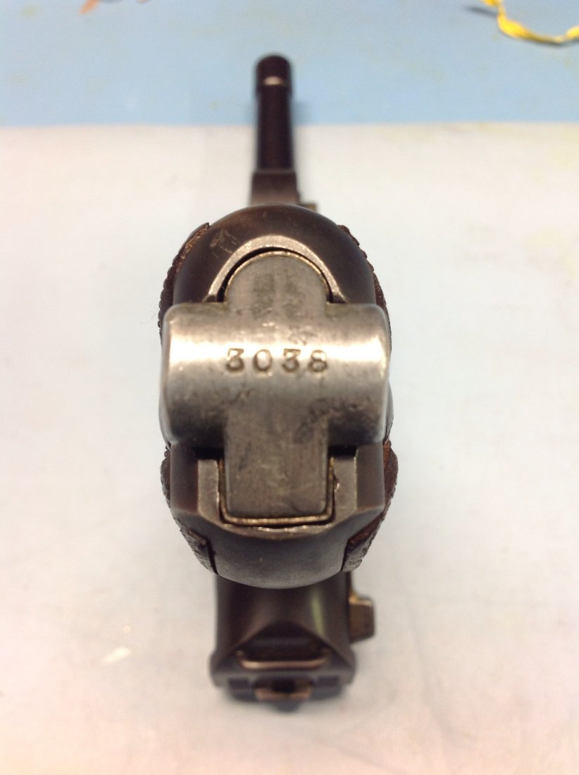

Noobie here. I recently inherited a 1920 DWM from my uncle and was looking to get some more information on what you all though of it's condition and value. Also, I'd like to know more about the markings on the gun and what information that the markings convey. I realize that the 3038 is the serial number and that the other "38"s represent parts matched to this gun, but the other markings are a mystery.
Any comments are most appreciated.

Your pistol is a Weimar era, (post WW1 German Goverment) Police pistol, which was first issued to a unit and then possibly passed onto another unit. The Unit marking experts will weight in on the Unit mark on your grip.
The Military acceptance stamps on your gun are also of interest.

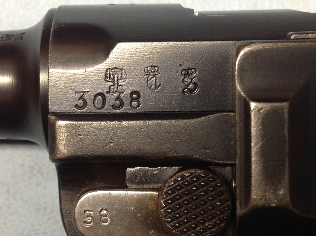

With the proof marks on the left side I would say this was originally a 1st issue then Weimar police. Since the 1st issue had no chamber marking the 1920 was added during it's reissue. The 1920 is a permissive stamp and not a true date. They also did not have a stock lug . Serial numbers were placed in commercial positions and then if reissued generally had military placement added. Looks like a nice luger with history. The small a on the frame is part of the serial number. (3038a ).Bill

Looks like a 1908 converted to police. Did belong to a signal unit(I think) before it was a police pistol. The 1920 stamp indicates government ownership I do believe. I like this one..

Marienwerder district police? Why would they proof the left side?

Interesting First issue P08, that was taken into Police service. Looking through Don Maus book, History Writ in Steel, if I've read it right it looks like the canceled mark looks to be a Police mark that may be from the Schupo district of Marienwerder/Westpreuben.

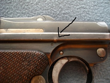

First Issue P08's originaly were not fitted with a Holdopen. Some were retroffited later, noticeable on the right side of the pistol. From what you have described it sounds like yours has a holdopen.
Dave

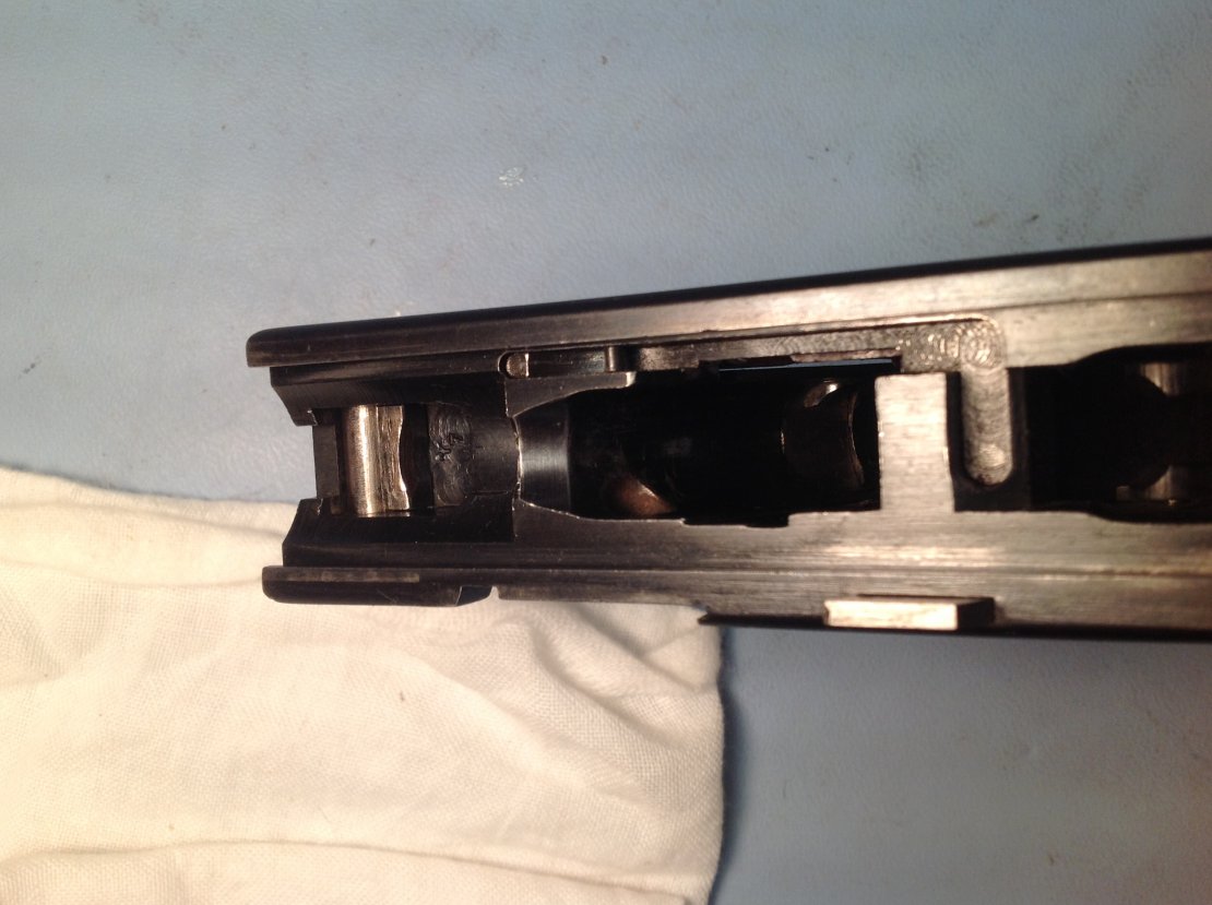

No. No holdopen present. See attached photo.

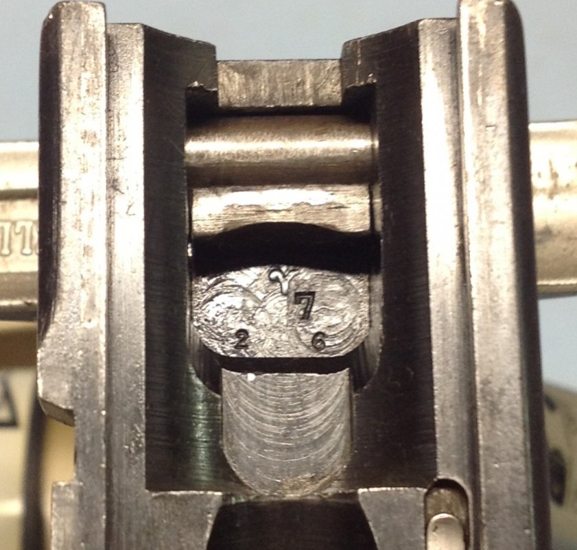

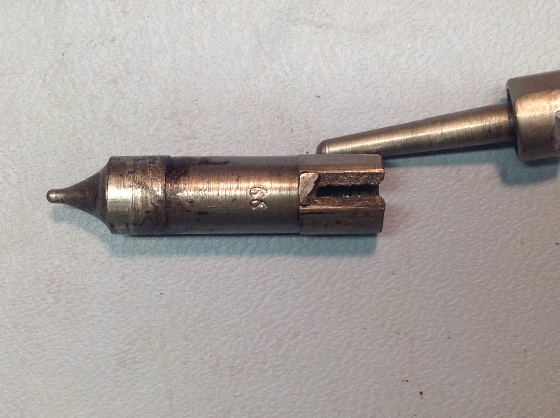

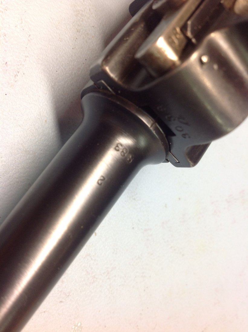

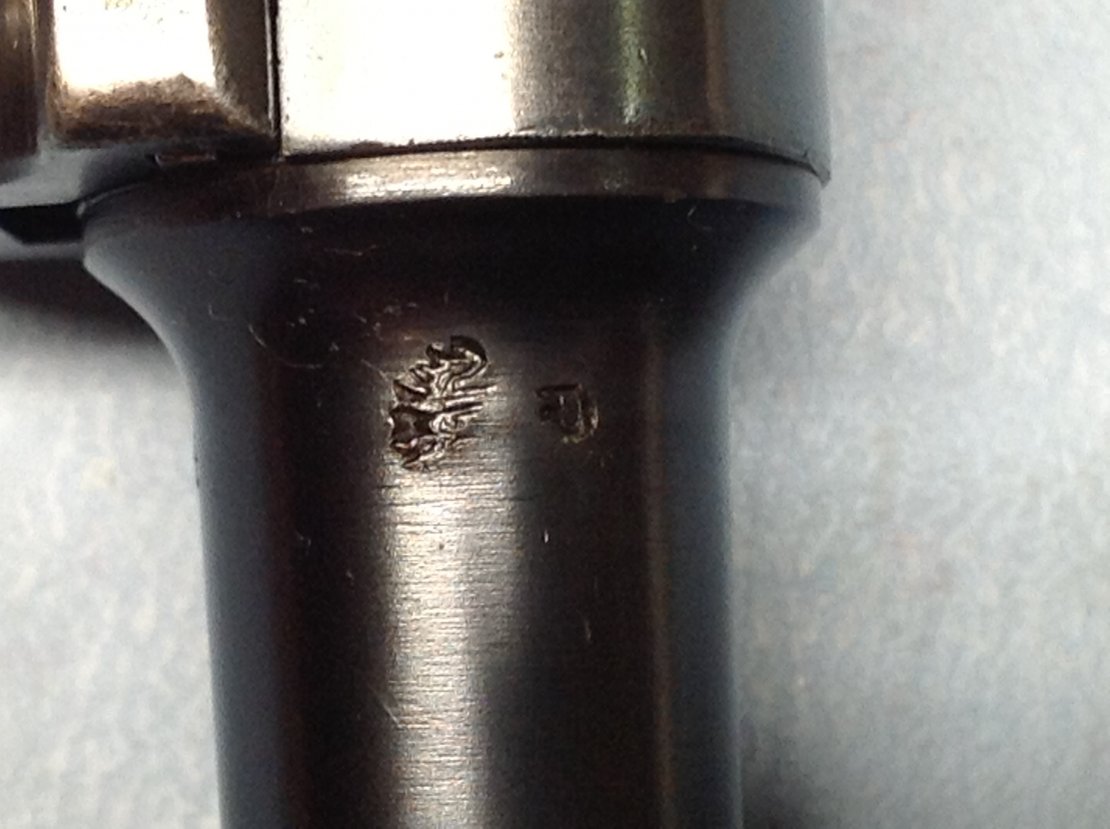

Also found addition marking on the barrel and inside the frame with the receiver removed.

Your pistol DOES have a holdopen, (see tip of its spring in the lower right corner of the above photo), which would make this pistol later than first issue, since there is no evidence of a retrofit on the outside of the pistol.

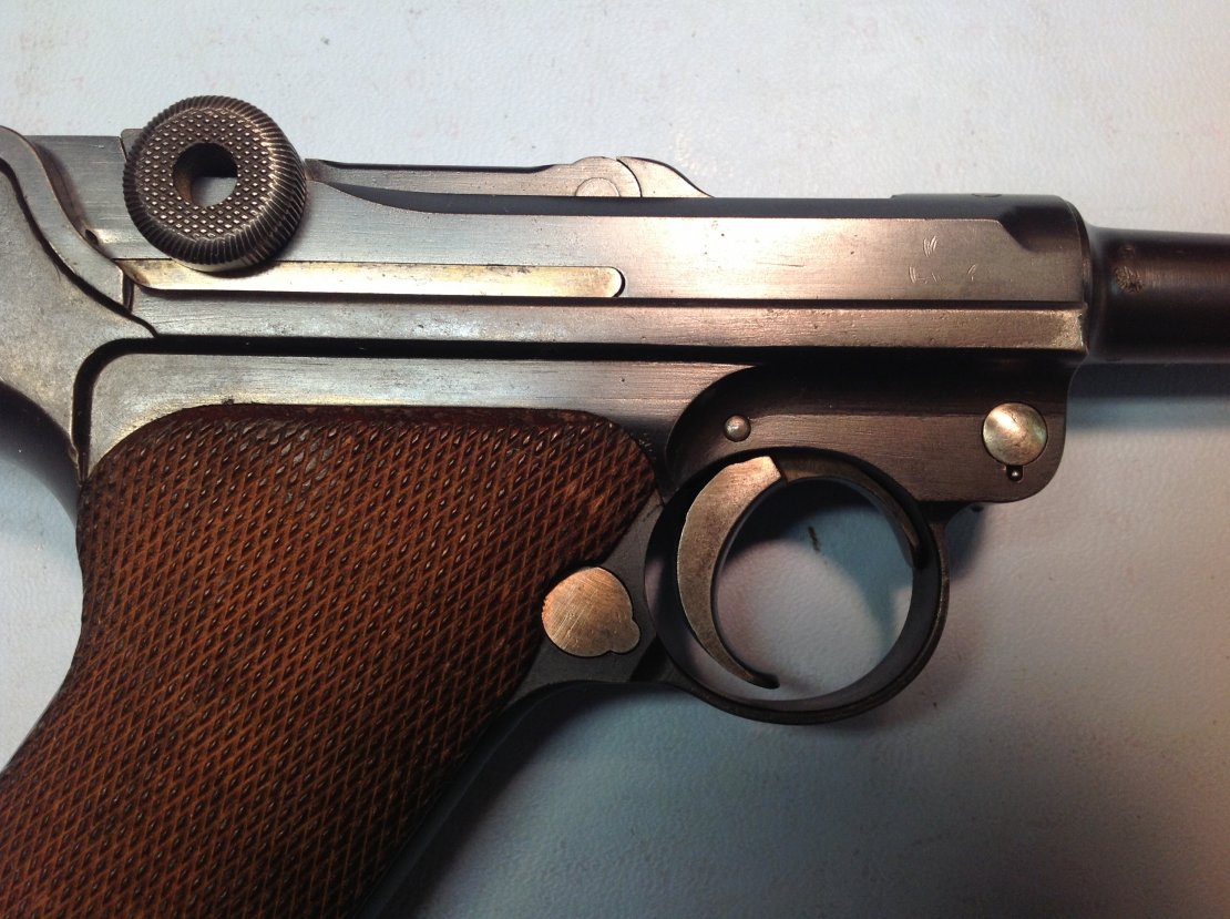

In looking closely at the photo of the side I see a mark that may be an added holdopen that has been finished to match the frame, although there is no proof mark. Perhaps a closer photo of this area would clarify.

Looking closely at the outside of the frame, I can see no evidence that anything has been modified. Attached are pictures of the holdopen with and without the spring in place. Surely looks like the frame was engineered this way.
Thanks!
pqschipper is offline   Reply With Quote
Unread 10-26-2012, 02:50 PM   #17
The gun is a 1908 First Issue as evidenced by the proofs/acceptance marks on the left side of the receiver and lack of stock lug. The hold open has been added but either the frame was refinished at the time of police modification which obliterated the tiny hold open Erfurt inspection stamp, or the hold open may have been added by the police armory which would not have had an inspection stamp applied.
At any rate, it is an early WWI military piece that was subsequently acquired by a police unit, modified and given a 1920 property stamp during the Weimar era. Nice gun with an interesting history and in very nice condition considering its long service.

Patrick, you have a very interesting gun. As stated above, it was reissued to the police after WWI and received the 1920 government (police) property stamp. Dave is correct in identifying the marking S.Ma.I.K.35. as being from the Schupo of the Marienwerder district --- specifically the command stationed in Elbing (Ma.I.). The K. is a little uncertain but, in the early 1920s, this command used letters to designate Hundertschaften (companies) and one other example of a K. from this unit is listed in HWIS Table 11-7.
The unit marking has been canceled and it was not replaced with S.Wpr.I. which was specified for this unit in the 1932 marking order. It is quite possible that the gun was surplused before that date and ultimately reissued to a Gemeindepolizei unit in the mid-1930s. Many of these smaller-city police did not mark their pistols and all unit marking of police weapons ceased in 1937. It probably received a sear safety but no mag safety sometime from about 1935 on, by which time mag safeties had been deemed a bad idea.
The barrel is definitely a replacement. It has an E/33 Simson proof and the number 2 on the bottom, the latter indicating manufacture by Simson in 1922. The Berlin Police Armory had purchased a number of these barrels and used them in reworking police P08s and LP08s from about 1928 onward. I suspect the rebarreling occured when the pistol was reissued in the mid-1930s. Does the barrel have the stamp PTV or TP (superimposed) over and eagle on the right side?

Don et al, thanks for the great info. I'll have a closer look at the markings on the right side of the barrel when I get home on Sunday. (I'm currently at the shore in NJ, battening down the hatches in preparation for hurricane Sandy, headed this way).
