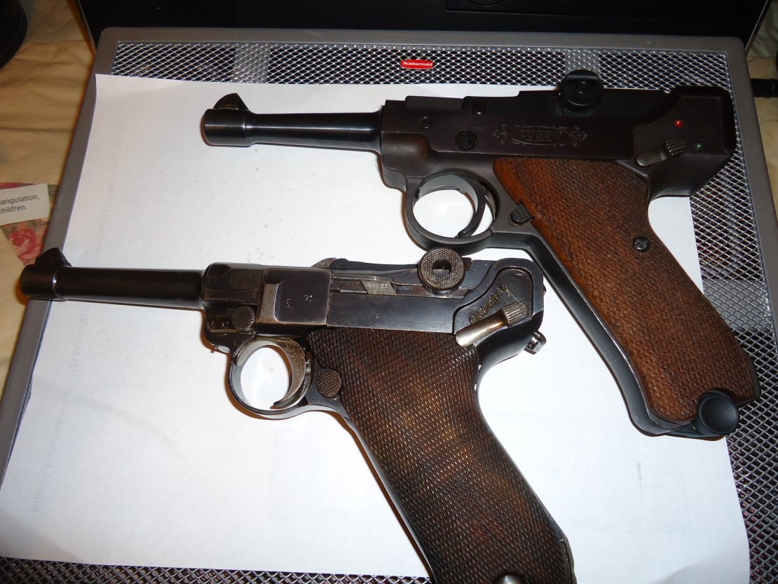

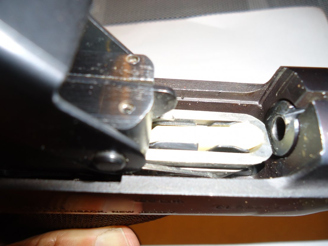

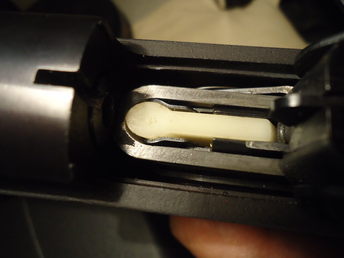

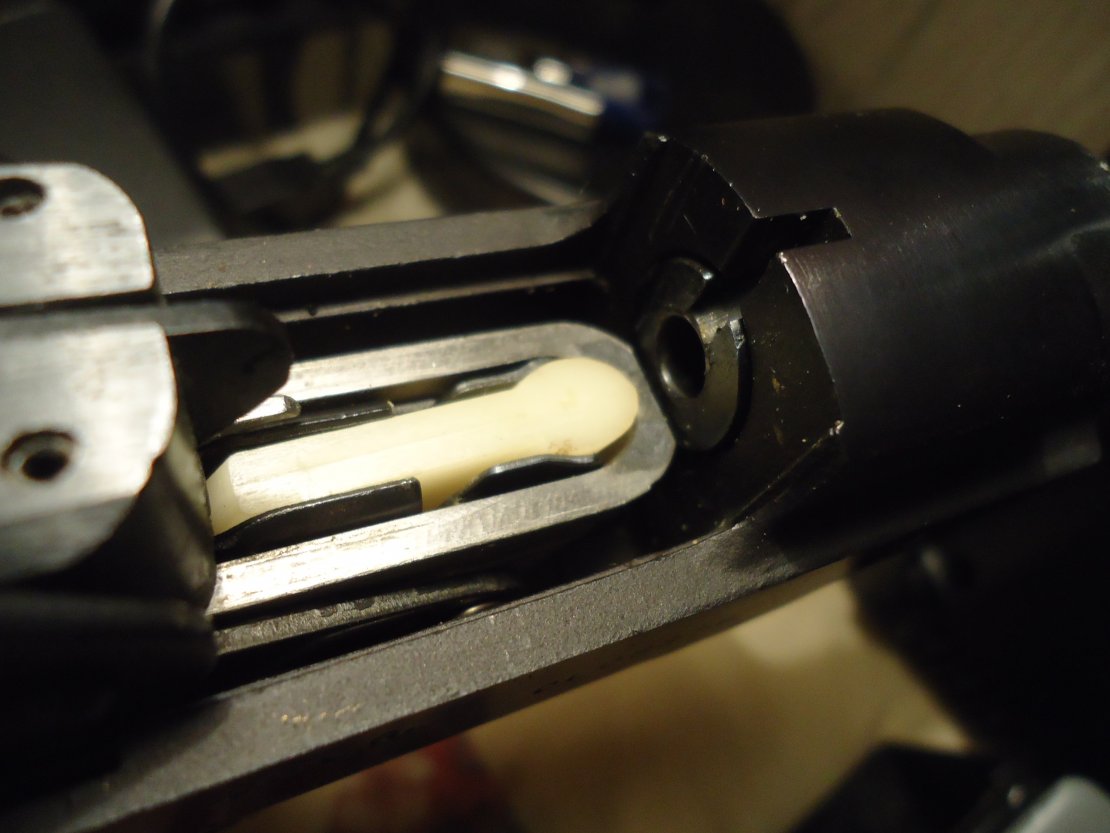

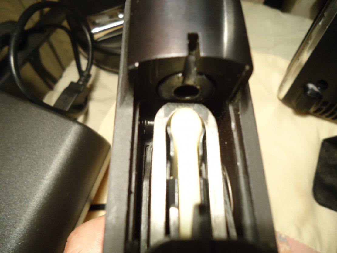

maybe these will help, this is a steel frame stoeger .22, bought in 1983 it has had a total of three magazines fired trough it. So i would say the magazine is pretty much new even for a 29 year old gun, perhaps this will help you. good Luck , Padre Dan

Stoeger made a pretty good copy with the steel frame pistols, too bad they had so many feeding and jamming issues, they never got them to work without problems.

EXCEPTIONAL !! Thans for taking the time to post the pics.

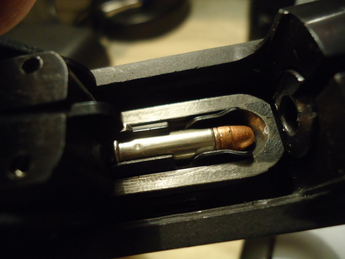

SInce you're such a nice guy, may I ask for a couple of pics, similar to those you posted, but with rounds in the magazine, so I can see how the rounds are presented to the chamber?
Thanks VERY much !

this pistol tends to like cci stingers, but it hasn't been fired with anything else. good luck.

Thanks - interesting pics - those rounds look to be a lot lower in the magazine than mine are - the feed lips on mine must be spread out too much . . .

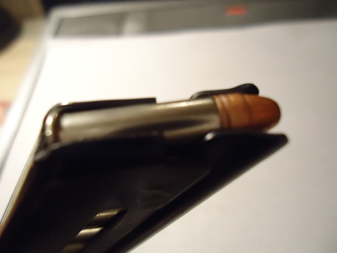

One final request on the magazine pics - can ya take the magazine out of the gun, and send me a picture with some rounds in the magazine, from the side, so I can see how the round looks coming up from the mag?

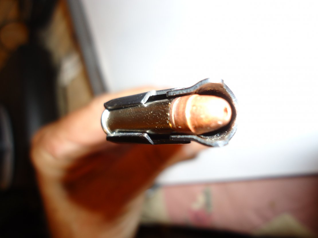

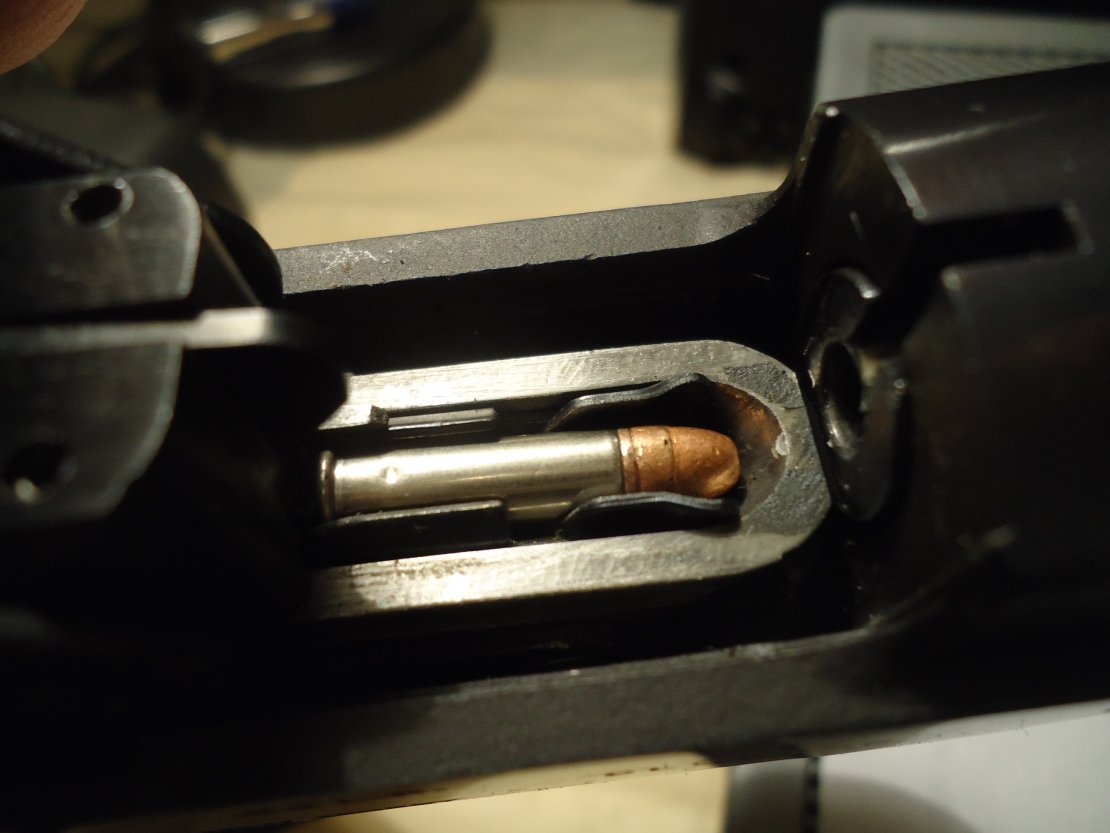

here are the pictures of the loaded magazine you requested, i would say this magazine is as close to new as any can be, you may like to read this thread on the stoeger luger i took the pictures of.http://forum.lugerforum.com/showthread.php?t=27742 good luck

Thanks, all, for the assistance - the positioning of the rounds in my magazines look very different - so, I think a good first step (LOL, maybe the last step before I just give up and sell the guns) would be to get a new Stoeger Luger magazine and try it in each of the Stoegers I have - if that solves the problem, I'll buy another mag - if not, I'll probably just sell the guns.
I believe that my two Stoegers are alloy frames - the SNs are 4315x and 4417x - for both guns, the barrel measures 5" from the end of the barrel to where the barrel goes into the frame. No markings on either of the mags, but they are definately different - one has a black (smooth) button at the bottom with a white follower and a single place for the pull down button to go into the side of the follower. The other magazine has a silver (aluminum?) button on the bottom, a black follower, and two pisitions where the pull down button can go into the side of the follower.
The presentation of a round is VERY different for each magazine.
