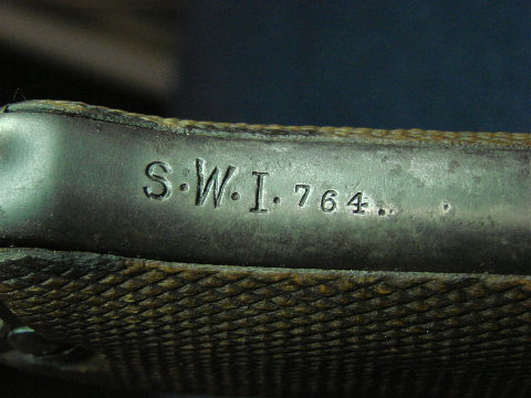

Many police used Lugers will have their particular branch designation stamped on the front grip strap. In addition, most will have a sear safety and often the remnants of a magazine safety.

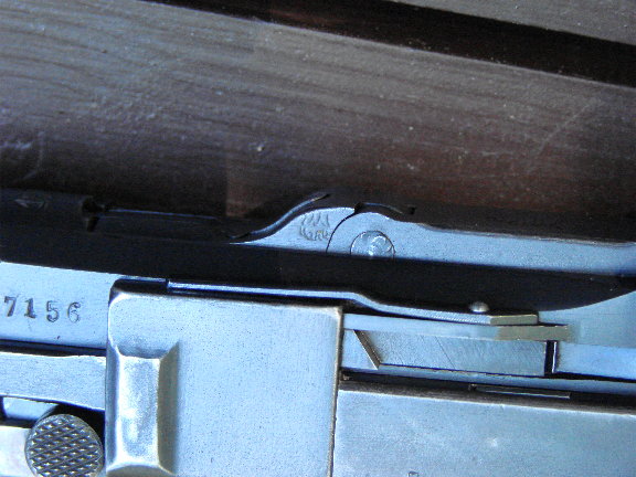

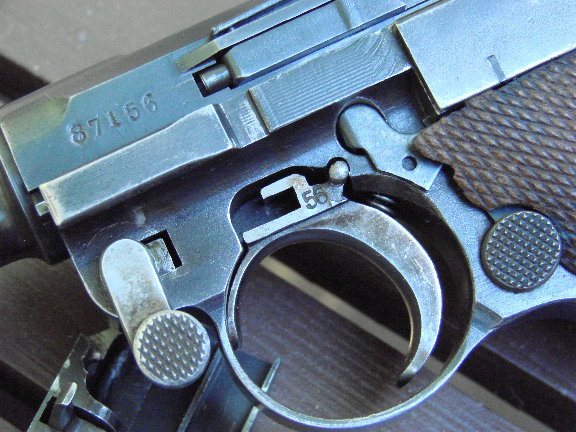

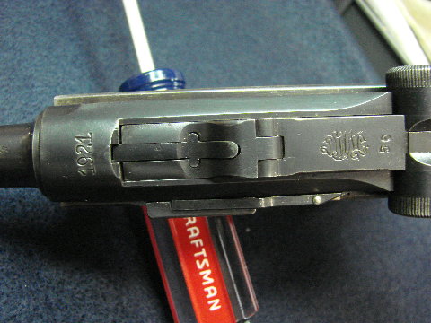

I am attaching a few photos to illustrate the features discussed above. The sear safety is the riveted attachment on the top left side, overlapping the side plate. The remnants of the magazine safety is shown in the view with the left grip removed.
Neil

Thanks for those photos. Interesting configuration for a sear safety, I'm guessing since it was an afterthought to the design. Is the mag safety actuated by the lever at the top left of the left grip, just above the trigger return spring? It looks like it was trimmed back flush with the frame. Did it originally block the trigger? Looks like if that was the case and it was intact, it could be seen protruding from underneath the grip?
Thanks to all you Guys for taking time to share your knowledge.

yes to your questions / the mag safety did not work as they wanted, so most (almost all) were taken off or disabled.
The advantage to a police luger is that you can find a WW1 or earlier one that went into Weimar Police service (unit marking on it), then had a sear safety (pre-WW2) and perhaps find one with a matching aluminum magazine that was nazi proofed.
