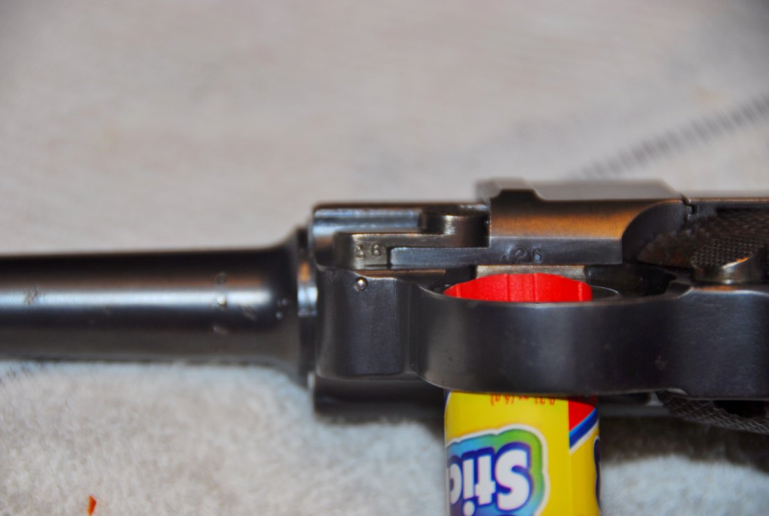

Default 1915 DWM what do I have here?
All the numbers end in 26, but the sideplate and takedown are marked different than my shooter grade. is that normal or was it forced matched maybe? Not real knowledgeable about lots of this stuff. I got it off a guy at a gunshow who wanted to sell it cheap to buy something else, paid shooter price for it. Blueing is definetly rust blue and I think is original, not a reblue. it has one issue tho.
unless you cycle it firmly, it will sometime not catch the striker on the sear. This is remedied by popping into battery rather than gently closing it. Dry fires fine, haven't taken out to shoot yet. Bore is good, some crud in it ( no time to clean due to workschedule. What have I got?

The sideplate and takeddown are marked in a commercial location, not sure why. More photos, left side, would help. I'm sure there is a logical explanation, just not thinking of one at this late hour.
Clean all the internals well before going to the range, and only load one at a time until you are sure it is safe to fire. Then 2, etc. The striker not catching may indicate that some 'smithing is in order.

Any chance you could re-shoot your pictures with sharper details of the places where proof and serial number stampings exist. Particularly the frame, barrel and left and right receiver areas?
Try using a camera with a tripod, closeup setting and use the self timer to eliminate camera shake. Shoot in natural indirect (outdoor shaded) light.
It's very difficult to make out detail in these pictures.
In normal 1915 military accepted DWM pistols, you would expect to see the last digits of the serial number on the side face of the trigger plate and take down lever. I've attached a picture from a 1916 military accepted DWM luger. If I'm not mistaken, your parts are numbered in the commercial style.
On operation... check to make sure that the little plunger on the front end of the sear bar is operating smoothly. Make sure it pushes in and pops back without hanging up. If it feels like it hangs up, clean and lube it.

I can't think of any 1915 dated commercials, but would have to look it up, but I am more inclined to think two force matched parts, but some close ups would be good.

Ill try for more pics when I can, work late nights. thanks for the tips on on the cleaning. I suspect force matching as it's all matching otherwise. If Commercial parts, would it be worth the hassle to look for military marked sideplate and takedown levers? How hard would these be to locate? I bought some repro grips from you Ed, a few years back. It's a military gun, as it has the 4 little crown thingies (technical term?) on right side. How hard is a takedown lever to install anyway?
