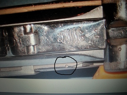

Steve, This is the "hole" we are talking about on your luger where the sear safety would have been installed.

Besides this hole, notice that your sideplate also has a rectangular cutout on the top, (lower left in photo) and visible inside this cutout is a second hole, which the sear safety would drop into once the sideplate is removed. All these modifications indicate police use.

[IMG][/IMG]
Ok, these are the sear safety holes and cutout. These prove Police use. I like that I'm a rertired cop. Would this have been German State Police or maybe Military Police? I guess the real question is... Were these weapons put back into Military service for WWII? Somehow I need to get the gun to France by 6 June 1944.
