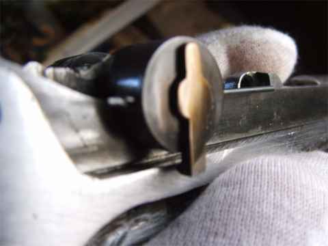

Trying to get an idea exactly how that thing in the frame actually is mounted and what it looks like. Looked at many pics showing the toggle lock but no clear pics of the frame portion. Looks like it was cut/dovetailed in. This is a pic of what I've made thus far for my Borchardt replica. Haven't made a spring yet. Any help? Bill

A channel has been milled from top to bottom in the frame. A small piece of metal with a catch at the top is dovetailed into that hole.

Here are some excellent photos showing exactly what you need..
http://www.forgottenweapons.com/lore...tomatic-pistol
Unread 03-01-2011, 02:38 PM   #4
Bill,
The catch is actually fit into a "T" shaped slot in the frame rather than a dovetail, and silver soldered in place. I had a loose catch from a 1900 Luger that I wanted to photograph for you, but I can't find the darned thing among all my junk. I will keep looking, but don't hold your breath.

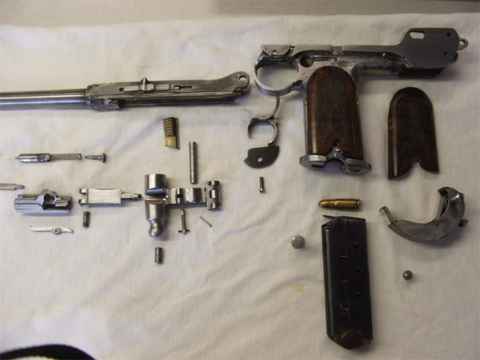

Pic of the progress thus far. I need to get a fininishing reamer for 30 Mauser to set the head space. I actually reamed it deep with a .30 Luger reamer, so I'll only need a few thou to finish. I will start testing with primed shells, move up slow with soft loads to get the mainspring tension.

Amazing project!!

Amazing! I'm surprised you're only making one. To go to all that skillful "trouble" I would think at least 2-3 "copies" should be made. I think you would have a market to sell one or two. Problem is, what price would you have to charge to defray the costs of time and material?

I'm not sure which has been the most difficult, collecting information, making patterns, or actual construction. Most of this is pure handwork. I guess one has to imagine the first few prototypes were hand made, I wonder how many to get it to work? Then, I presume, comes the tooling. Would have been much easier if I had one in my hands to work from. It has given me such an appreciation for the pure genius of these guys and the incredible craftsmanship that went into the work. One has to imagine how apprenticeships worked back then, I'm envisioning some 10 year old doing nothing but polishing grip screws all day. I have long felt Herr Borchardt has gotten kind of a footnote in History, compared to Herr Luger. I wish I had the resources to write a book strictly on the Borchardt. I recently built a wheellock which was very difficult to get to work.....500 year old technology! Probably a hundred assemblies, disassembly, file, fit, etc. Then one day, 'Bang'....nearly jumped off the ground!

Oh yea, Dr, I don't know what the cost would be. That little toggle assembly represents a good 8 hours!
