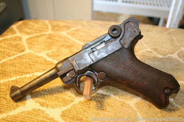

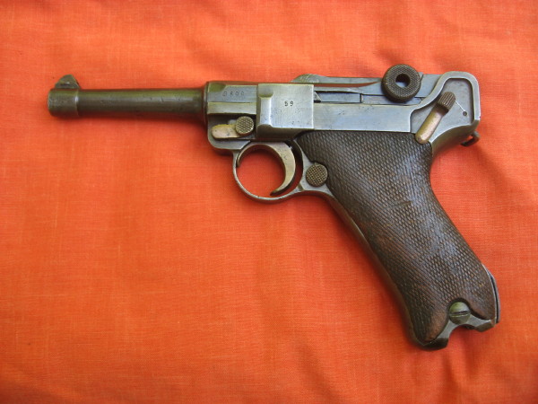

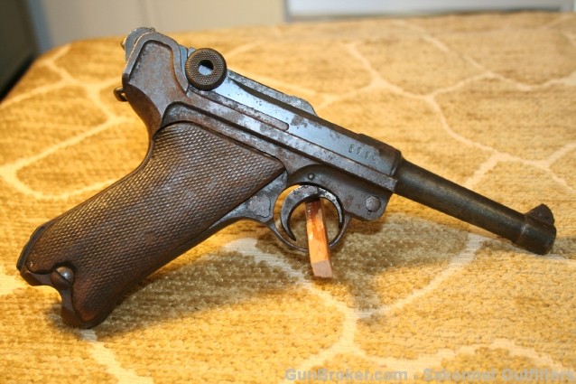

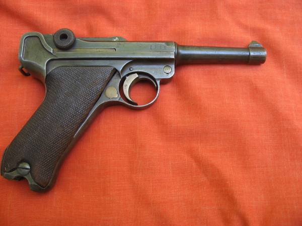

I recently picked up this "parts" pistol that was on GB. I was quite pleased with the way the pitted parts cleaned up. I left the toggle assembly in the original rust blue, and used several applications of cold blue on the rest, which matched up pretty well. I enjoy cleaning up mis-treated pistols such as this and restoring them to use again.
It is "matching" in all respects except for the bbl/receiver/sear, and the # on the safety which had been broken, and the grips. As is sometimes the case, Murphy had a hand here, as the grips are numbered "95" and "should" have been "59."
I'm looking forward to taking it to the range as soon as my magazine arrives.

Wow that turned out pretty good man.

That came out nice. Good work.

Quite a difference! And the gun retains a kind of endearing, gnarly character. Does it shoot OK?

I think you did a pretty decent job. I really like these before-and-after pictures.
Another Luger saved from the trash can.

wow! Almost like night and day! good job!

Blush, blush. Thanks for the kind words. A Luger is relatively easy to file down, as most did have machine marks left in the metal. My son-in-law is a master clockmaker, and as such, has a nice assortment of metal files, picks and emery paper in his workshop. I left some of the pits as you can see. One of the hardest things to do is to "go back, and file/polish "one more time". There was a tiny wave in the forestrap, and I had to go back several times, after polishing was started to get rid of it.
If you think this work is good, jump on Olle to "show off" sometime. He has a lot more patience than I do, and is approaching Thor's work quality.
Thanks also to Tom H for passing on which way the machine marks went, and helping out on a few parts needed. And thanks to all for the warm welcome to the Forum.
