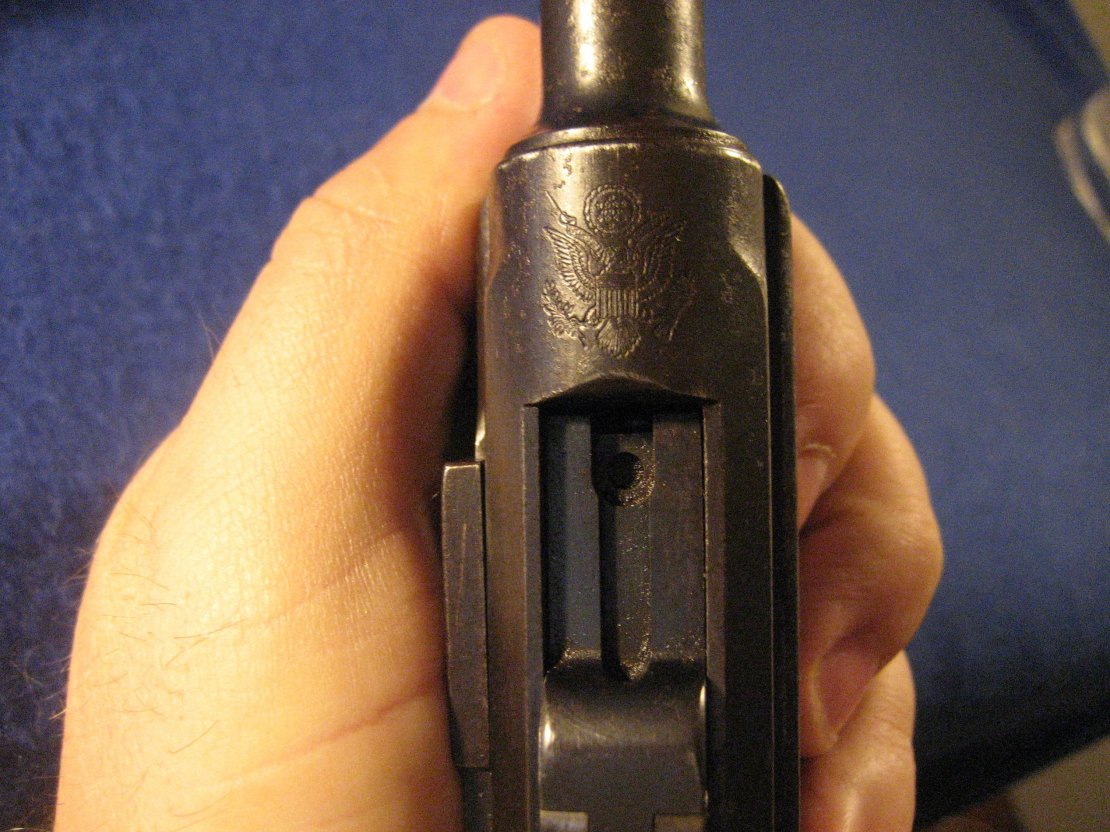

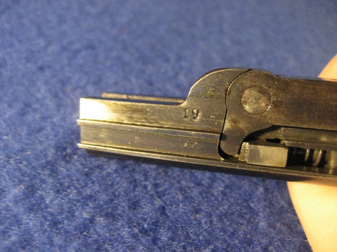

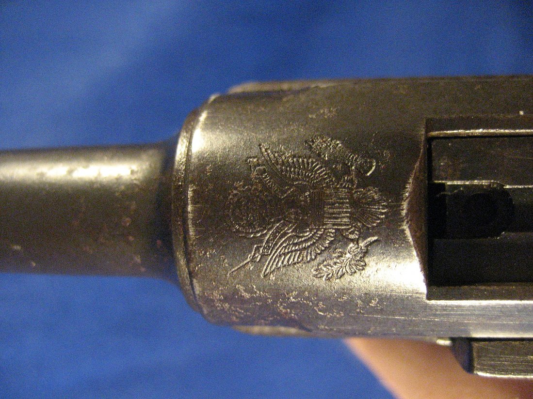

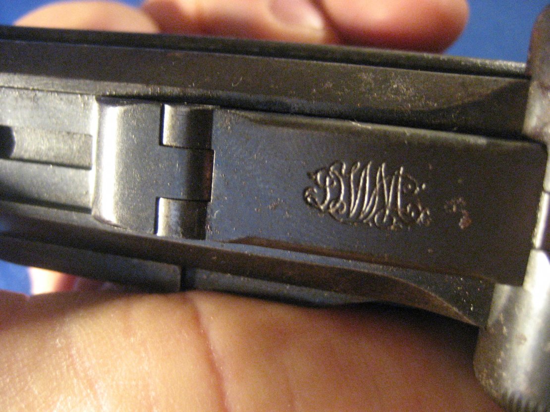

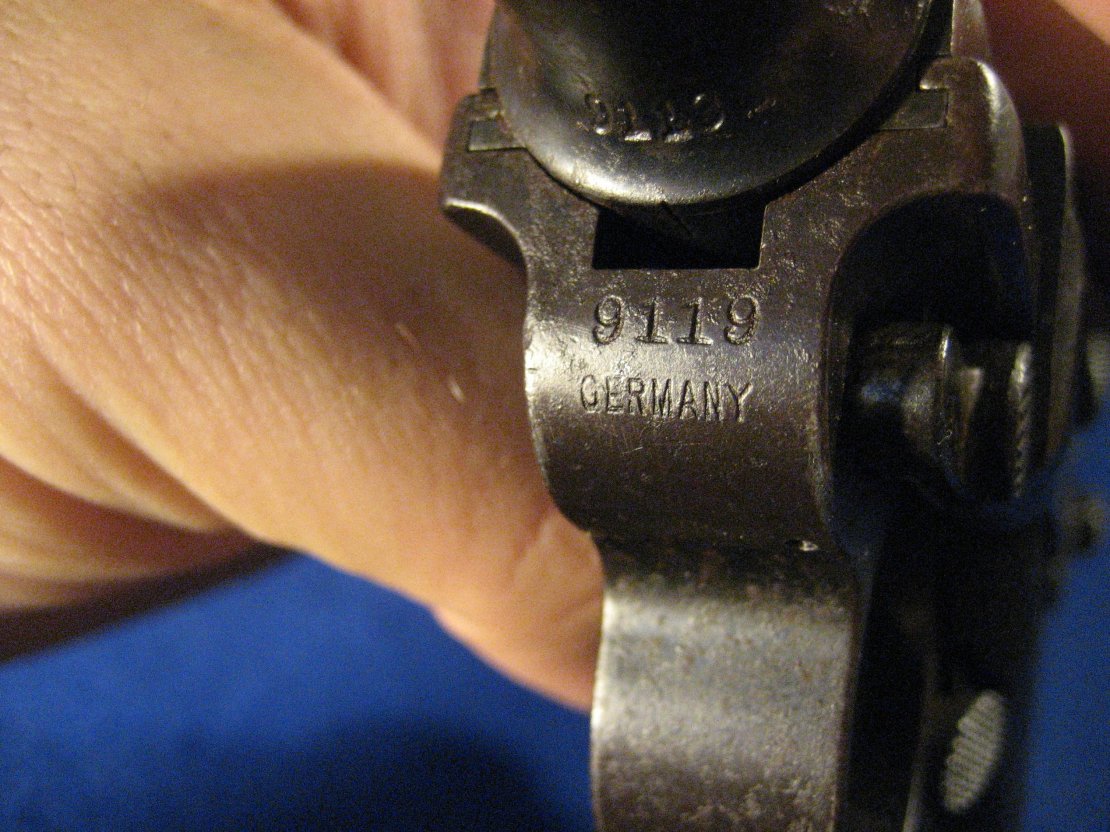

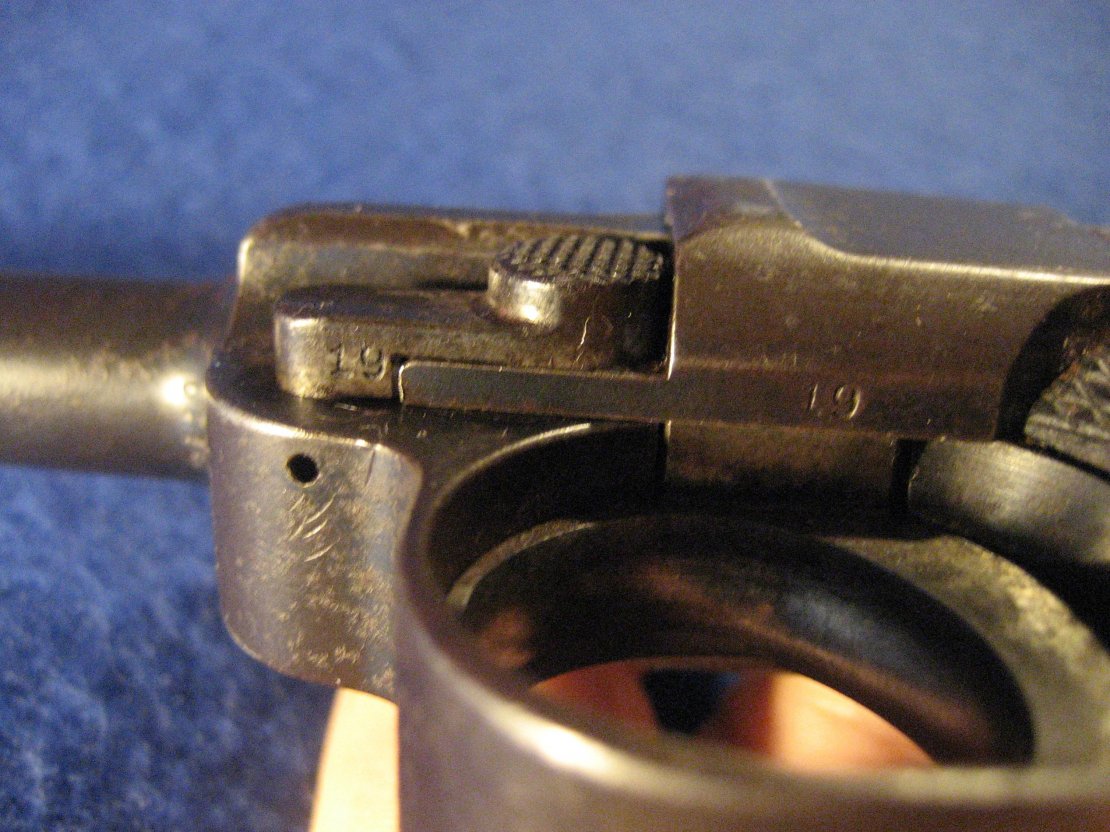

I also posted this over on Jan Stills forum. I think you guys have seen this pistol Briefly before.
I have this one more pistol that I am bebating trying to get back into shape. But my initial thoughts are that it would be more than it is worth. I dont want to part it out if anything I would keep it as a representative piece.

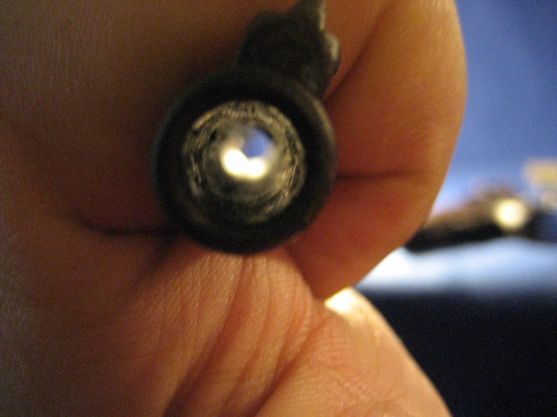

#1.The Barrel is bulged and the rifling is completly gone. Is there anyway this barrel can be sleeved? Probably not but If I could I would like to keep the original barrel with the gun.
#2. The extractor and spring are GONE How hard would it be to get a proper 1900 part for this?
#3. The safety just flaps in the wind.
#4. The tension pin for the safety lever is GONE
#5. The grips are almost completely worn smooth and there are letters carved into the left grip.
It is a damn shame that this pistol was neglected as bad as it was and whats even worse is that this is a completely matched pistol including the grips.
What to do ?

The bulge can be rolled out, but finding someone to do it will be a task...and it is my experience that the rolling will leave rings...
It can also be sleeved and re-chambered (or just sleeved)...again, finding someone...
If Lugerdoc can't do them, he may know someone who can [Policeluger???]...and he probably has the parts you need...
Unread 02-06-2010, 10:26 PM   #7
Another one??? This one's bore is too bad. After restoration, a shiny gun with sewer pipe bore .... well, I don't know, many do not care. Alternatively, postie could help rebarrel it.
It does not have to be shiny. The major problem, it does not function and that can be fixed. Not many people shoot 7,65 though.

There is a gunsmith named "Redman" doing relining work on Mauser. People saying he does good job, consistently. Another guy doing similar work, some praised, some feedback saying he did not drill the new hole in the middle of the barrel. Probably unstable performance. No experience with either, but you may try "Redman". Fewer guys doing this business, I don't know he does Luger or not:
http://www.redmansrifling.com
The benefit of relining, it is still matching.

I have two 1900 barrels sitting in my parts, had them for sale on the forum, but both are sewer pipes for barrels (very little rifeling and pitting). Externally they look decent.

Need to re hash an old topic. A couple more questions regarding this pistol.
1. Should this be BUG marked i see no evidence of it ever having the markings.
2. Do any of you guys have an extractor and extractor spring for sale?
Unread 06-02-2012, 10:42 PM   #19
Wayne..Looks like you also are in need of a takedown lever spring?
