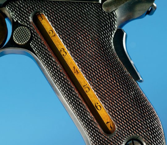

cartridge counters have slots cut in the grips too see how many bullets left

Yes, in addition to the missing extractor and toggle lock, that is the most significant piece missing on this gun. I have seen CC magazines come up for sale from time to time, but I have never seen an original CC grip offered for sale. To restore this gun (if it is a real one) you would have to have a grip made up from scratch.
Not quite.
http://www.egun.de/market/item.php?id=3840427

Since it lost the original windowed grip panel, I would think it's a regular 1902 fat barrel with mismatched grip panels.... probably plus some amount due to the s/n.

The grips on Egun were made for a Mauser Parabellum commemorative, and will not fit on a DWM frame.
