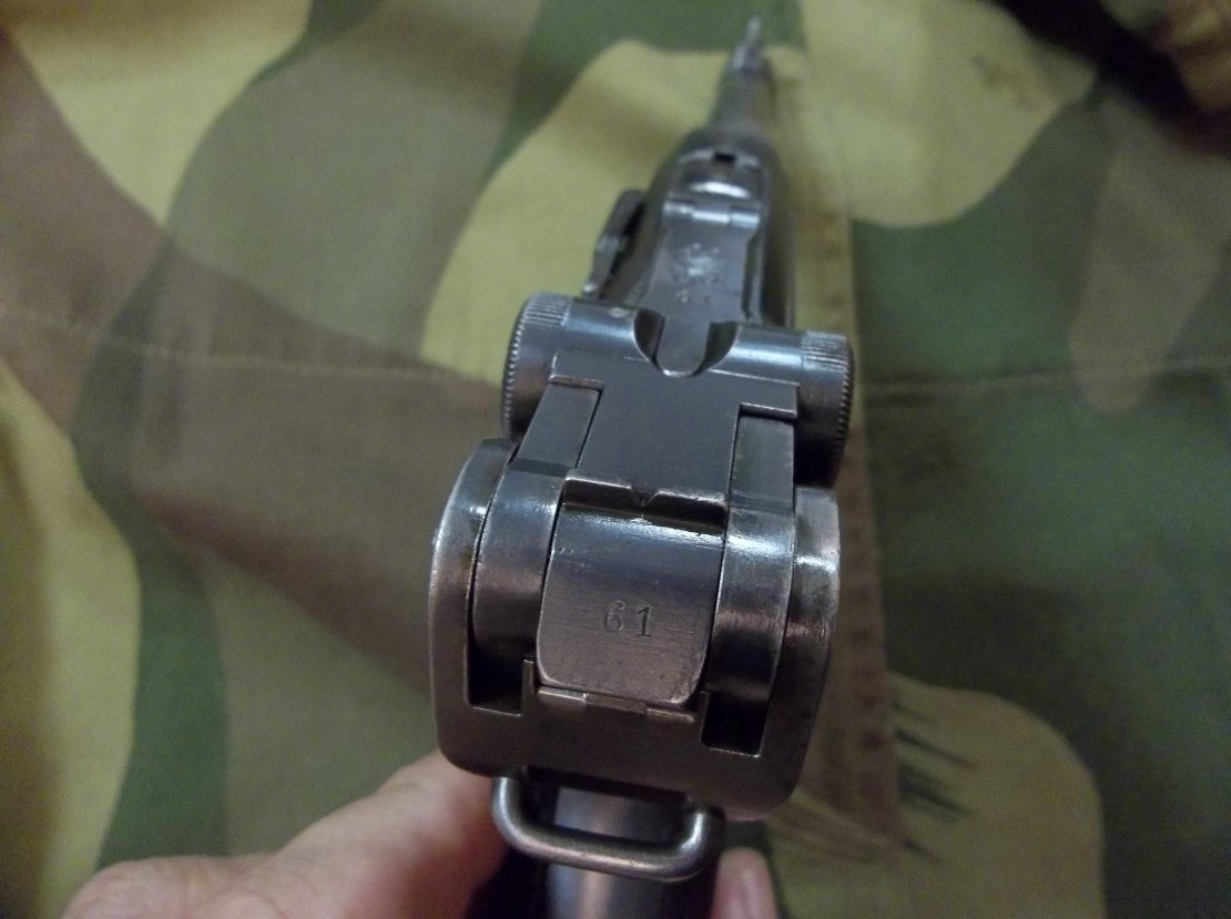

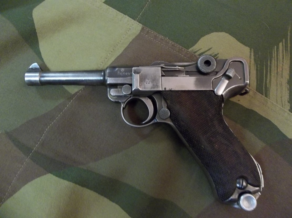

A hand pick, all matching from RGuns, I requested the earliest WW1 dated P08 they had. I don't know what I got, is it a 1908? Perhaps reworked by Simpson in 1930?, Is it Miltary or Commercial?

Another question, does the sear safety mean it was once issued to the Police? But since it has no magazine safety does that indicate it was transferred back to the military?

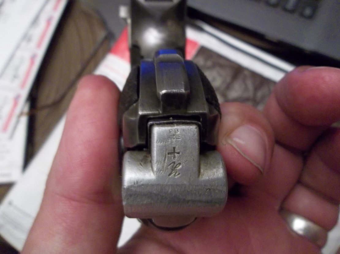

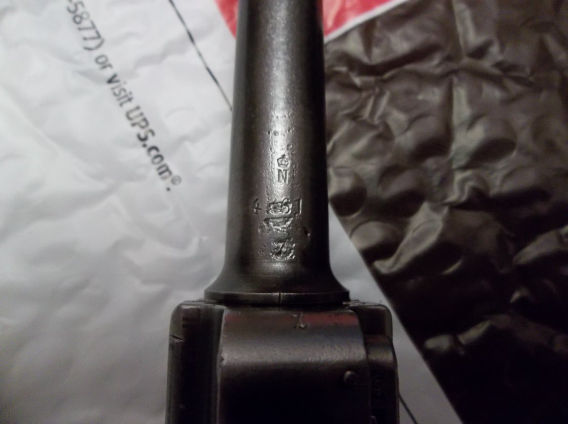

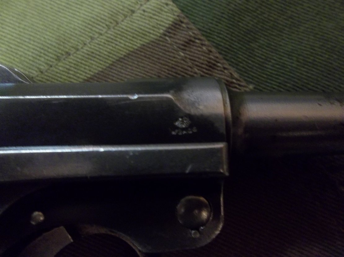

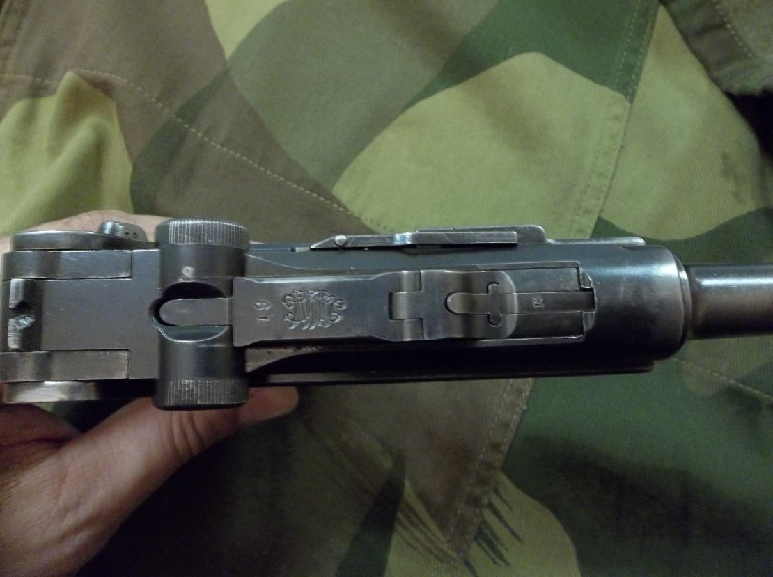

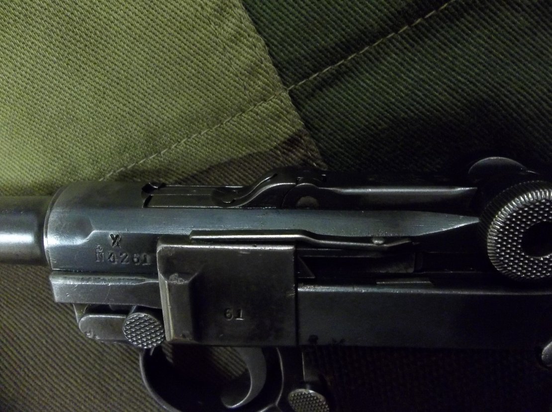

The frame has had a mag safety installed and has a sear safety..That part is Police..I can see a Crown N so a commercial pistol, no date on chamber.
What is on the toggle? It looks later like WW2. BYF-42-DWM?
There is an X over the serial number which looks like Russian.
Is the pistol matching?

Not even the 1920 mark and with the sear safety, very interesting. One wonders if they didn't quite get your request regarding the WWI bit. I don't suppose there's any unit markings?

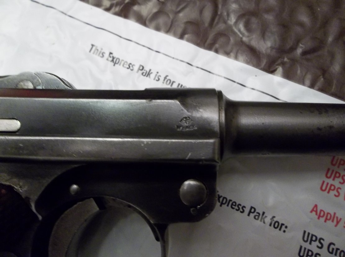

There's no mag safety, just a bit of corrosion in that spot.

#4261t is a 29DWM (made in 1929). The serial #'s were in the commercial range but, most went to the police or army. I suspect Jerry is correct about the mag safety. Many had the slot on the left frame flat filled in (welded). Is there a hole in the frame under the sideplate?

The proof on the right reciever is Weimar Army I believe? Deffinately Police Pistol. Quite a history there.
If that spot IS corrosion I could be wrong about the mag safety. Looked like it at first!

You did not get what you requested. It is not a WWI gun, in fact it it is considerably post-WWI.

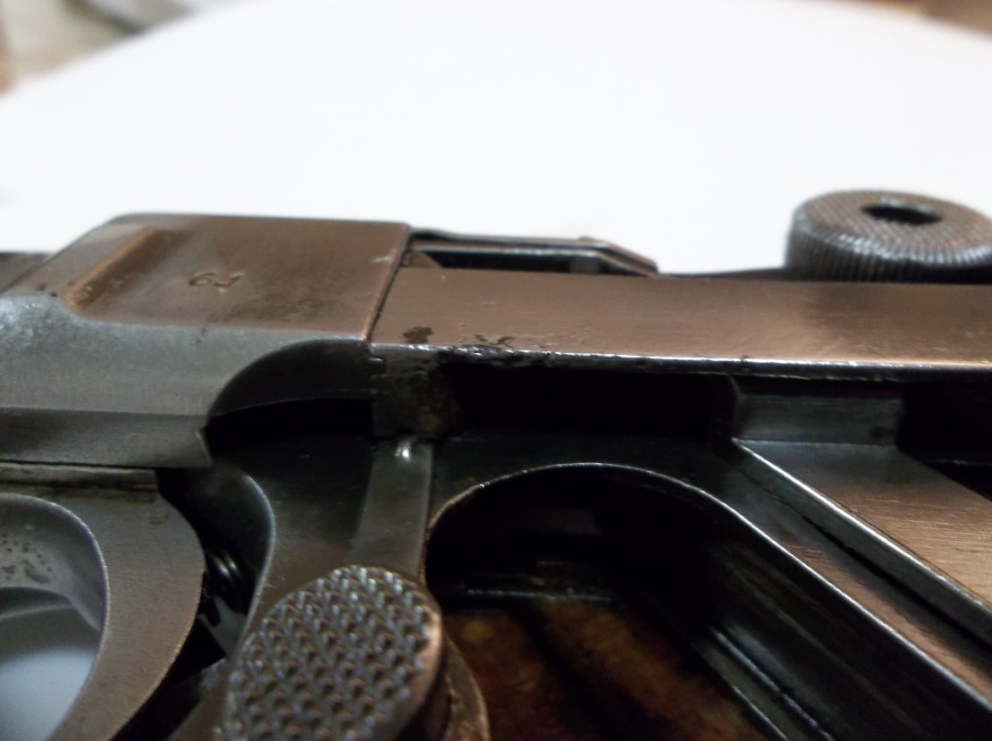

Here's another pic, there's no cut for the magazine safety, I thought there had to be one, or am I wrong?

Not all Police pistols were fitted for the magazine safety. In my opinion, the Weimar era is as interesting, historically, as the First World War. This pistol witnessed the upheaval of an entire society and the rise of Adolph Hitler.
I, personally, would not exchange it.

You got a rather interesting Luger from R-Guns. Considerably more rare than the Military DWMs from WW-I. To be clear, this one was newly manufactured by DWM, and would not have been a Simson rework.
Was the barrel a replacement? Is that corrosion that was welded over where the serial number normally is found? Did it originally have a different number, or match the rest of the pistol? Does the witness mark line up?
If you replace grips, keep the originals. You can find members here that can repair the chip on the front of the left grip if you want that done. They may also be matching...
The notion of what is "collectable" can change over time. A RC Luger with this interesting a background would be, in my opinion, worth holding on to.

I still think this gun may have had a mag safety. The corrosion may be pits from a weld to fill the slot. Is there a hole through the frame under the sideplate? If so, there was a mag safety installed in the past. Also the left grip looks like it was inlet for a mag safety and may be original to the gun. Check for the hole...

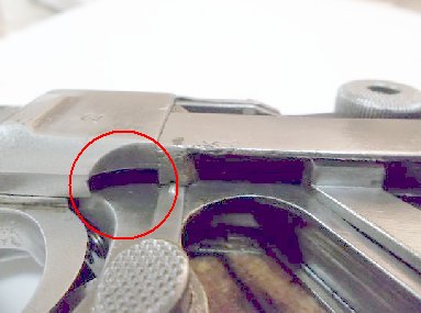

Removing the sideplate will show if a mag safety was ever installed. (There will be a hole). Your sideplate does have the cut commonly done to clear the mag safety (pic attached).

It does have the safety hole drilled, however the cut on the sideplate was smaller than I'd ever seen and was so well welded up that I mistook it at first for a spot of corrosion. It is
