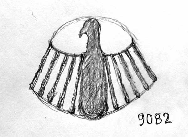

Folks,
A friend in Finland has a commercial Luger with these stamps on the barrel, frame and receiver. I think I know what it is but there is enough doubt from the crude drawing to put it out there for other opinions.
The gun's serail number is 9082, so that is not necesarily part of or near this proof.
File Type: jpg Olkkosen 7 65 Parabellumin mysteeri (2).jpg (33.9 KB, 43 views)

Need to know the serial number letter suffix. Need to know exactly where the proofs are, and if they are in combination with any inspector marks. Need to know if the toggle is stamped DWM or is blank. Need to know if it has a sear or mag safety, and any gripstrap markings. Need to know if it has any c/N.

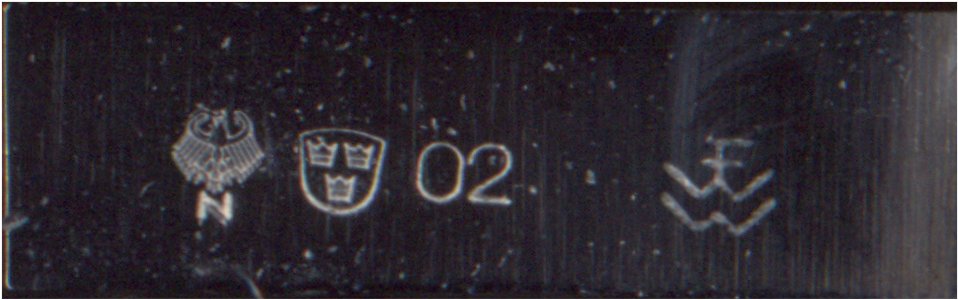

Looks very much like a post war Western German commercial proof marking. I'd expect a letter N below it.
