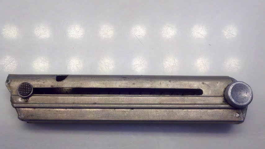

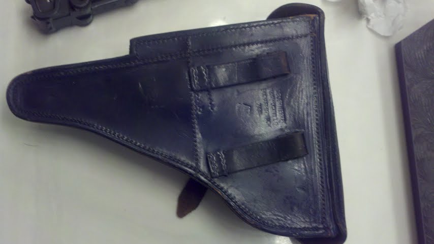

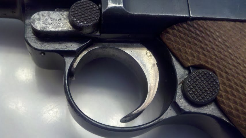

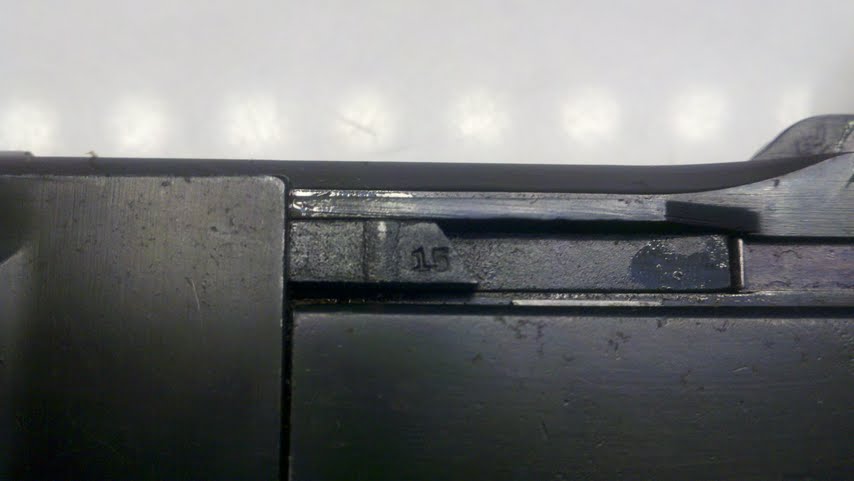

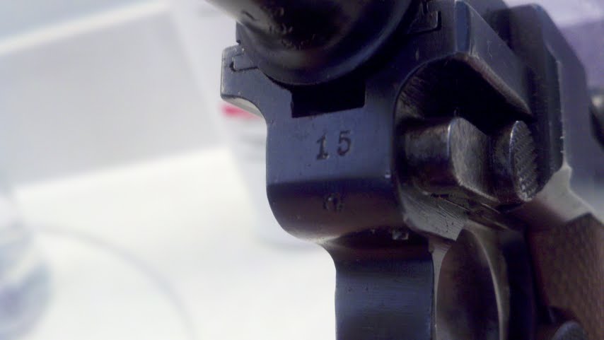

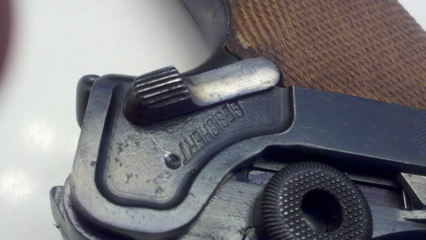

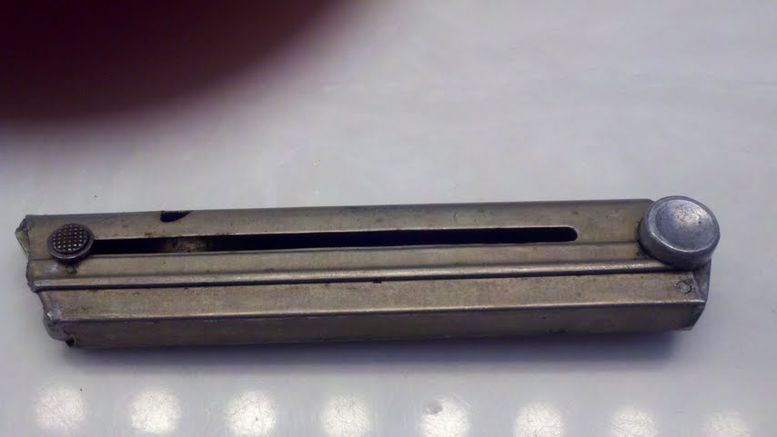

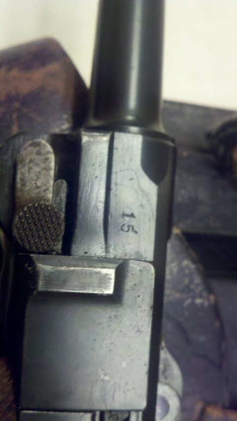

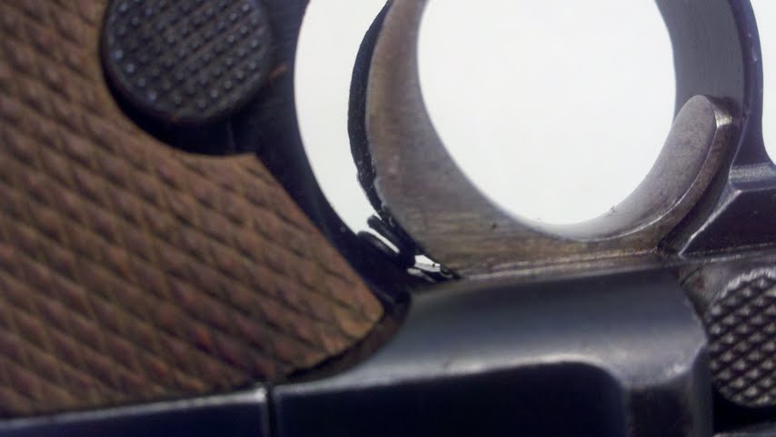

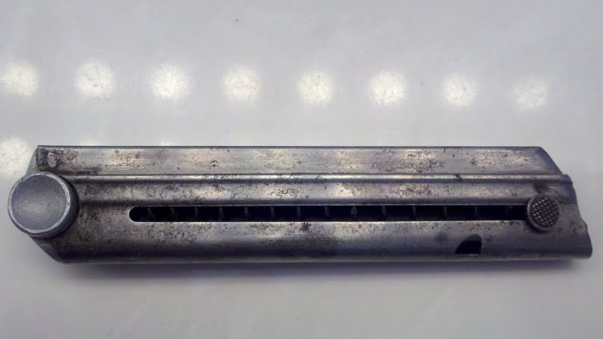

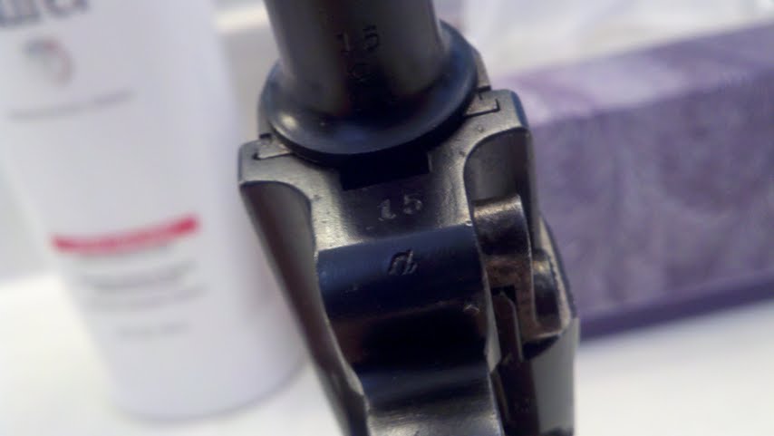

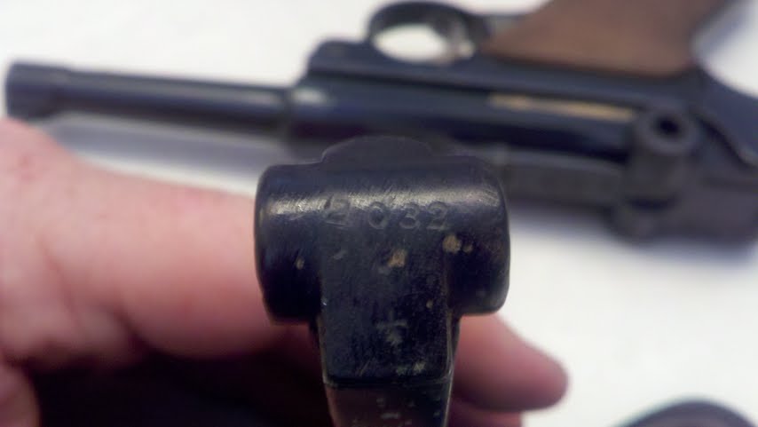

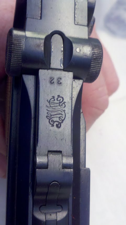

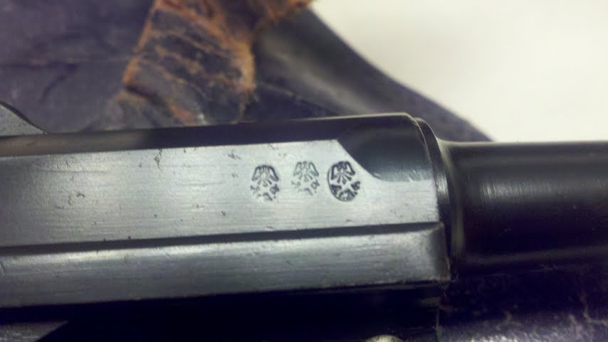

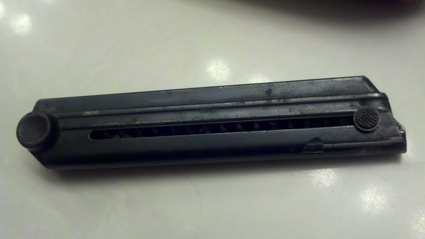

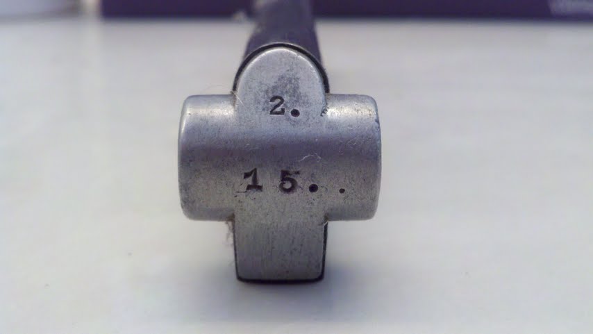

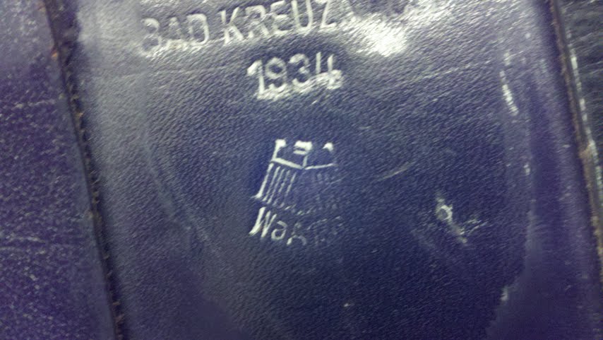

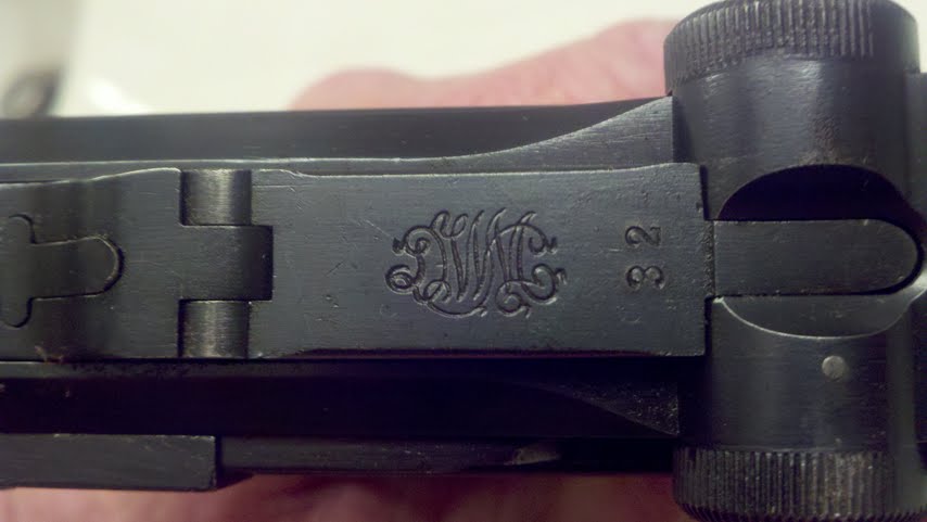

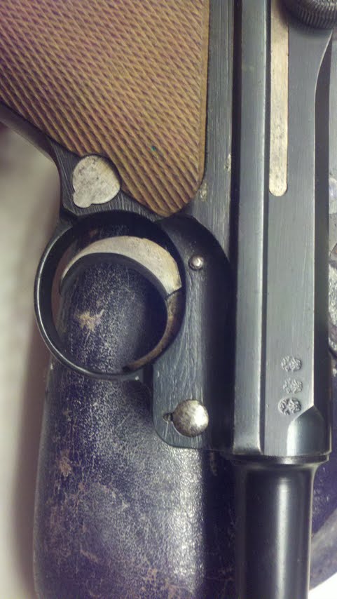

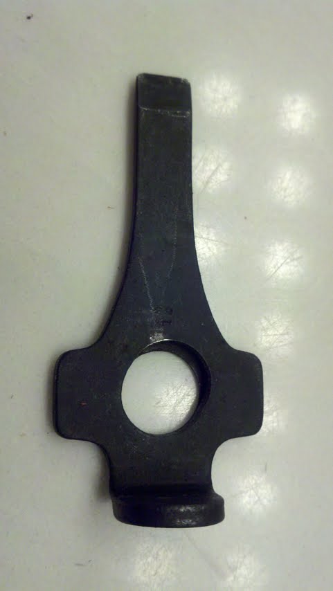

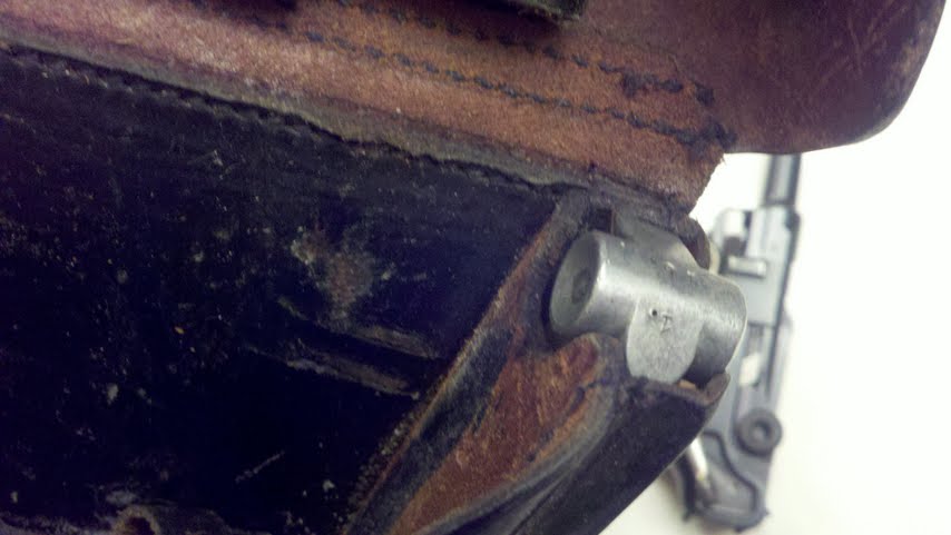

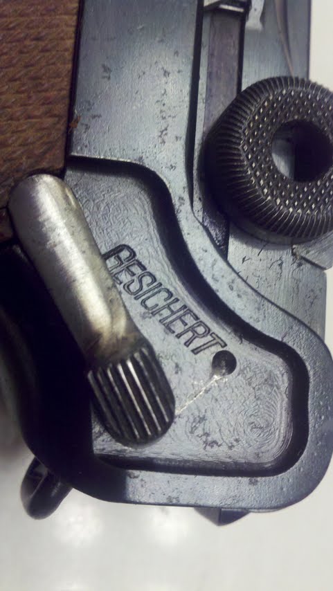

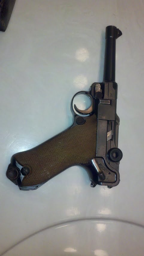

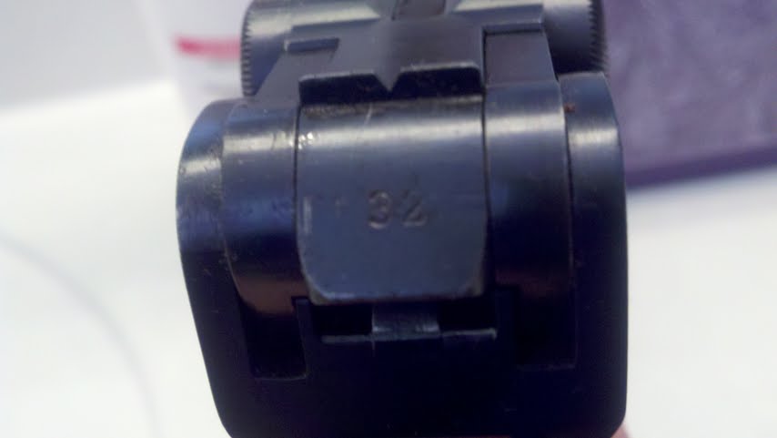

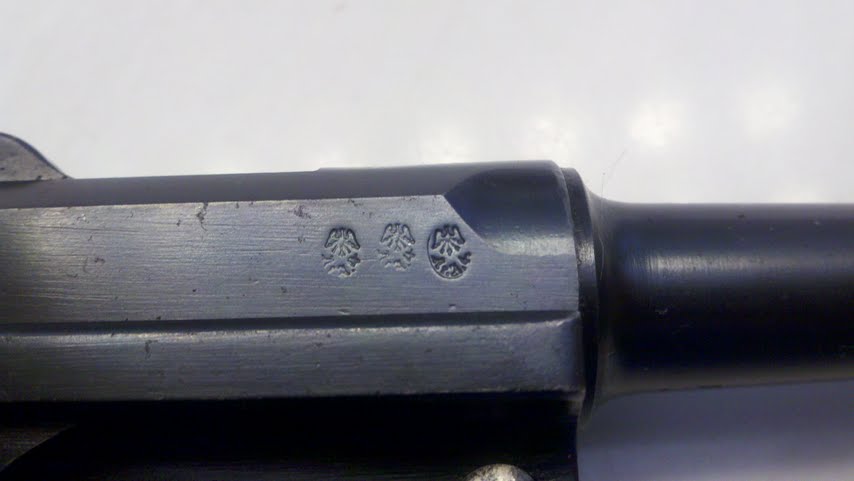

Just want an idea of what I have here. I have no paperwork and nothing else but what is in the pictures. I would like to know what significance (if any) the small engraved emblems mean and how to figure out if it was used/carried by an officer in WW2. I know little to nothing about guns and only recently found out my father has this gun from my grandfather. I appreciate any help that can be given.

Well sir, you have a very nice 1920 dwm, police luger, with looks like one matching mag, nice holster. Allso looks like most of the numbers are matching, very nice rig indeed.. Verry good pictures, Welcome to the forum.
Unread 03-16-2012, 05:11 PM   #6
Dan is right on. Your toggle train does not match the balance of the pistol. Curiously, your takedown lever matches the toggle train and your magazine has a similar ending pair of digits, so all these parts may have come off the same host pistol in order to create a functioning weapon.

I like the proofs on the right side of the receiver, the low block serial number "15" (can't tell which letter is below the serial on front of frame), the 1934 holster, and the matching mag. "SB" unit mark is Weimar police, I think, though I don't see a sear safety.

I believe this to be a 1920 DWM Luger manufactured for the police. It is not an all matching piece since the toggle is from a different pistol since it is marked "32". The locking bolt is also marked "32" and the wooden base magazine bears the serial number 2032. The serial number of the remainder of the pistol is 15a (see bottom of the barrel and the front of the receiver) and the "15"mark shows up on several more parts. The aluminum based magazine is matched to the bulk of the pistol in the police fashion with the 15 serial number and the number 2, which indicates No. 2 of up to three magazines issued. The "S.B.12 333." on the front grip strap indicates Schutzpolizei Berlin (Schupo), if I have interpreted Mr. Maus's book correctly. I can't read the mark on the loading tool.
The DWM mark on the center toggle link is the trademark of the manufacturer. The marks on the right side of the receiver are the acceptance and proof marks (E/ArA4 and WaA4).

It most probably served in WW2 as a police gun and was in active service until captured or surrendered.

Actually, the lack of sear and mag safeties indicates the gun was issued to one of the barracked Berlin Schupo Bereitschaften (riot police). Their Lugers were exempted from the order to add the safeties. These units were transferred to the Landespolizei and then to the military in 1934-35. The gun probably saw service in one of the police battalions or the Wehrmacht during WWII.
