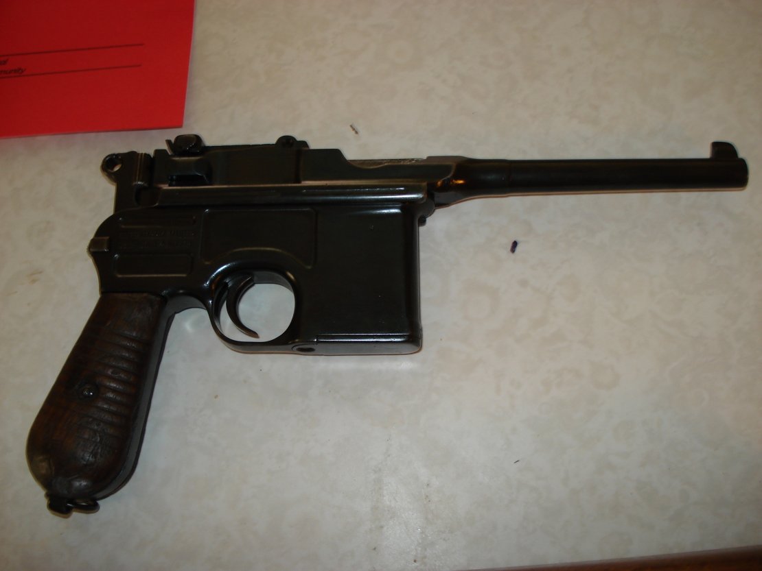

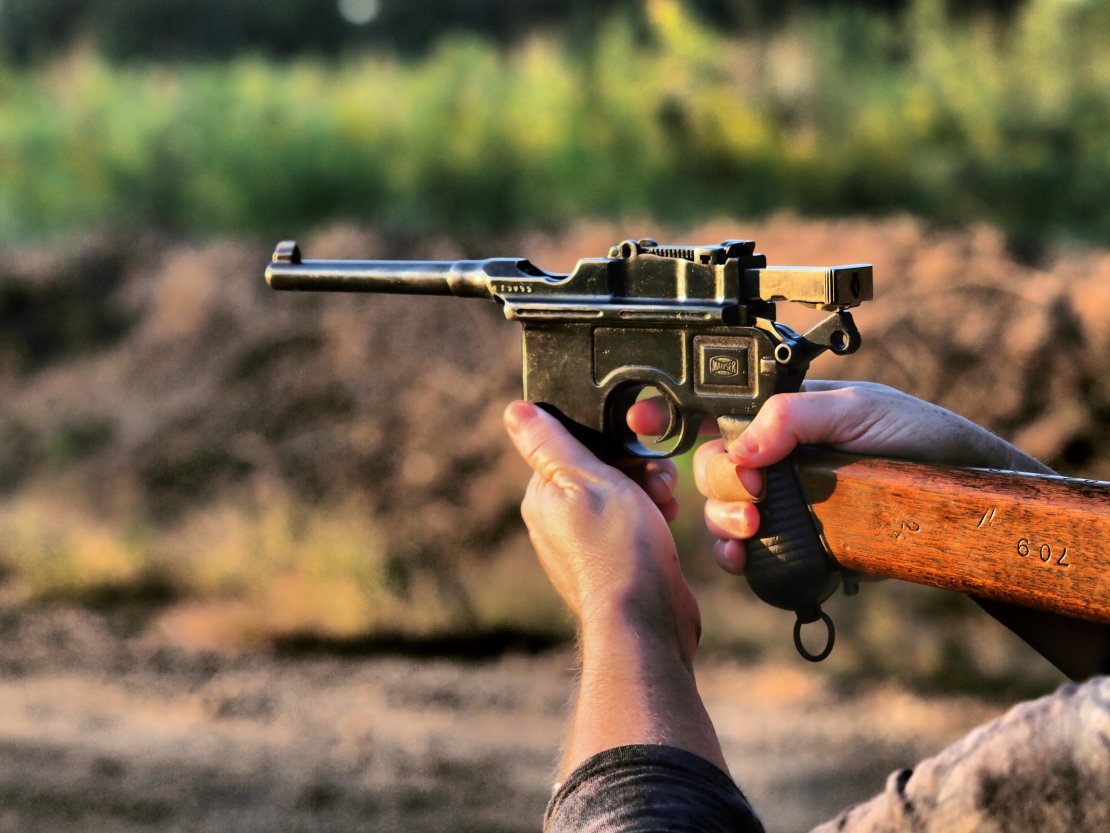

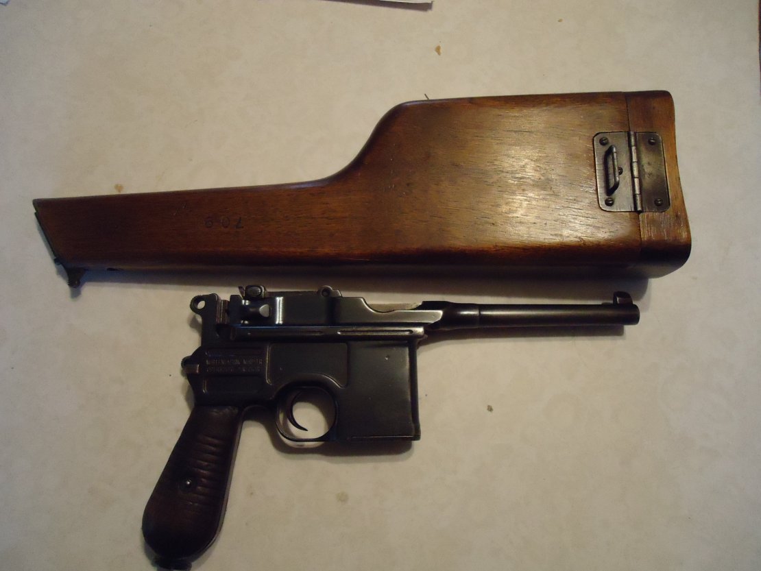

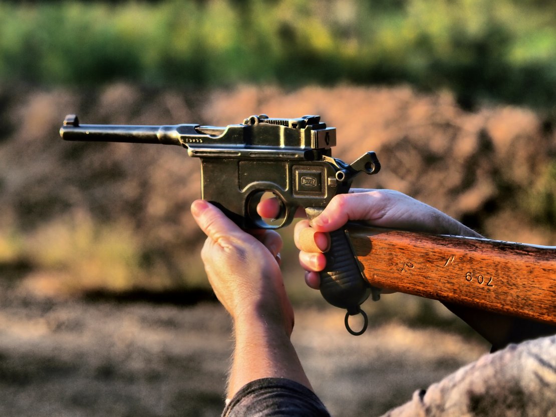

this is a 1930 mauser c 96 in being fired and shown with the matching stock holster. I do know the history and a bit about it, a world war two bring back, given to me by my uncle, member of the 101 st abn div, was aquired in belguim jan 1945, near the town of bastone, belguim, still shoots and functions well, pistol and stock have matching numbers.

thanks i did do a bit of cleaning on it. the safety was broken only took six years to find the correct one. the leather harnes on the shoilder stock had rotted to nothing, but the rest has cleaned up rather well i think.

Dan,
For $50 you can get a reasonable holster replica to keep that stock in..

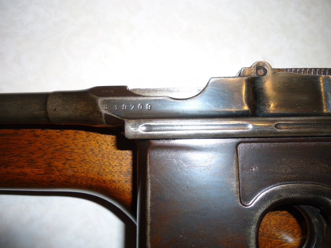

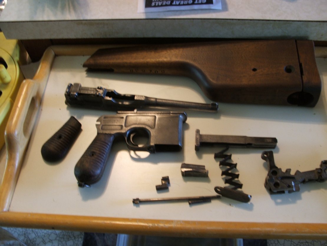

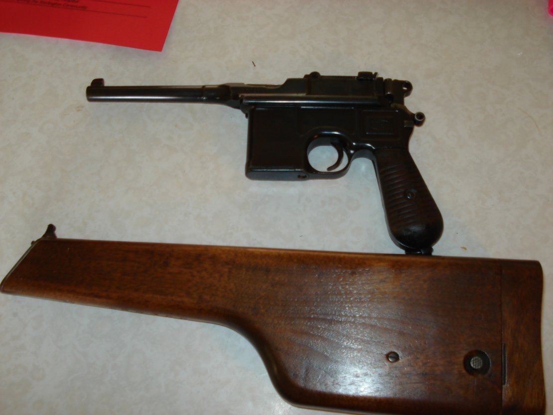

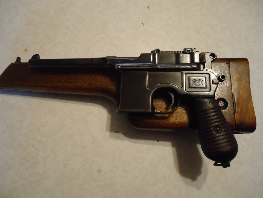

thanks bob, i will check on the springs, took a few more pics of it, the before and after. one of the local so called broomhandel exsperts around here offered me 600.00 for it since it cleaned up so nice and had a matching stock with it. i declined. can any one tell mea bit more about uncs c96, i know it's a mauser c96 about 1930, thanks

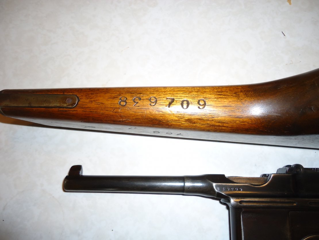

Just an FYI, but unless your stock is numbered on the attaching iron, it really isn't an original, factory matched stock. The Germans may have numbered the wood later on, but to an advanced collector, this would not be a truly matched rig.
Is your stock iron numbers matched to the pistol?
Not a huge deal, since it is priceless to you, but just thought I'd put that out there.
Unread 02-10-2012, 08:46 PM   #11
This stock is not Mauser made stock. It's a replacement. The gun was refinished.
But if it shoots well in range..... I think I wouldn't sell any working-perfect Mauser Broomhandle under $1000 (even if it's refinished). Most of those "shooters" asking a few hundred dollars on the market do not work well, buyer has to spend money trying to fix various kinds of issues. The "shooter" name is misleading if it does not work. A reliable and accurate C96 is a gem which brings in lots of fun. Sell it under $1k? No way.

yes , i cleaned and refurbed the pistol after it was given it me, the stock had other markings on it, i may have removed them, there is a 2, left.besides the serial number unc was too ill to tell me much about it by the time he passed it to me, It shoots well and now looks good and will never be for sale in my lifetime. the so call c96 expert every offer he ever made to me was usauly half of the value, consider him to be a joke for the most part. We all know experts just like him. everyone considers him a lowballer, but it is fun to hear the wrong information he gives out. as far as the c96 goes it is really fun to shoot, it is a long way from being retired.

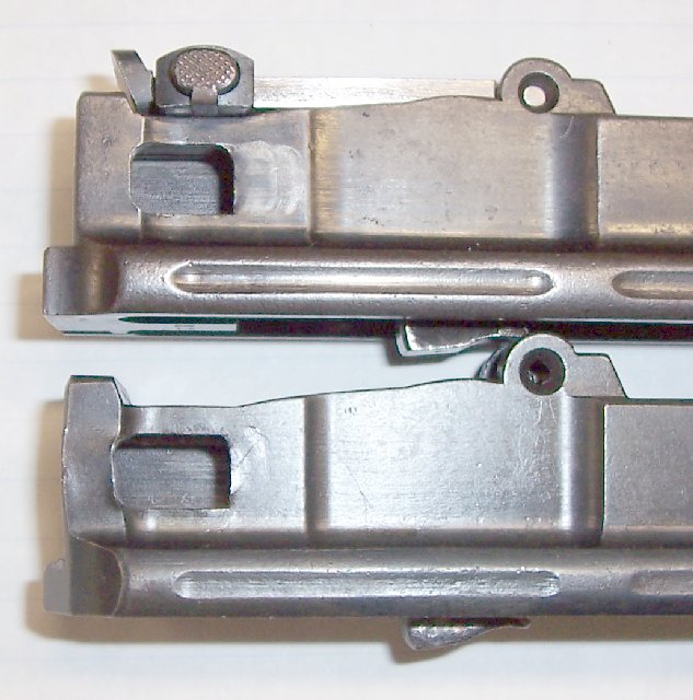

Top is my infamous 'Red 5' C96; bottom is a C96 which has been abused with 7.62 Tokarev ammunition...
Does that look OK to you???
I don't know who you heard that from, but you have found a good source of information...to ignore...

That Tok ammo will beat that old gun to death.
I have seen several with the metal distortion pictured and cracks there as well.
I own one I wont fire as it shows damage.
They may be extracting the bolt from your forehead one day.
