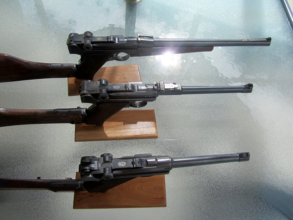

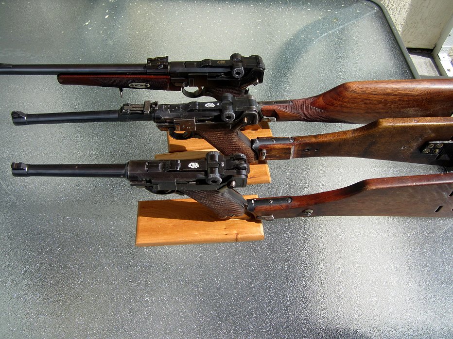

Unread 02-13-2012, 02:15 PM   #17
Default Finally The Holy Trinity
and never fired by myself to next week!

Unread 02-13-2012, 02:26 PM   #19
LugerMan.com
LugerMan.com's Avatar
Join Date: Feb 2012
Posts: 377
Thanks: 91
Thanked 364 Times in 116 Posts
Where is a front sight on that Navy Luger in the picture ... ?
LugerMan.com is offline   Reply With Quote
Unread 02-13-2012, 02:54 PM   #20
Thank GOD you spotted it. I found it outside where the pictures were taken!!
