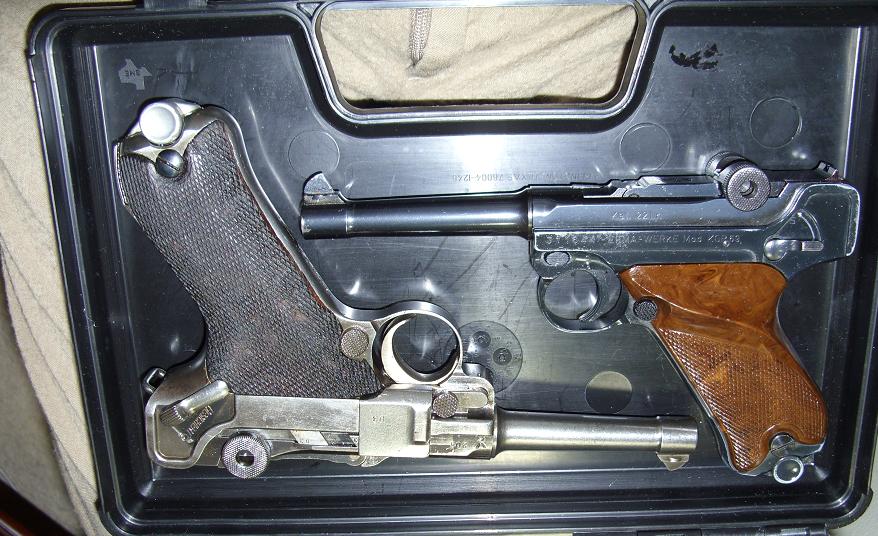

Hi everyone, here's a photo of the Erma next to my newest acquisition.
It is distinctly smaller than its 'real' brother. I'll try and get more photos later, I have a guest on the way so no time now!
