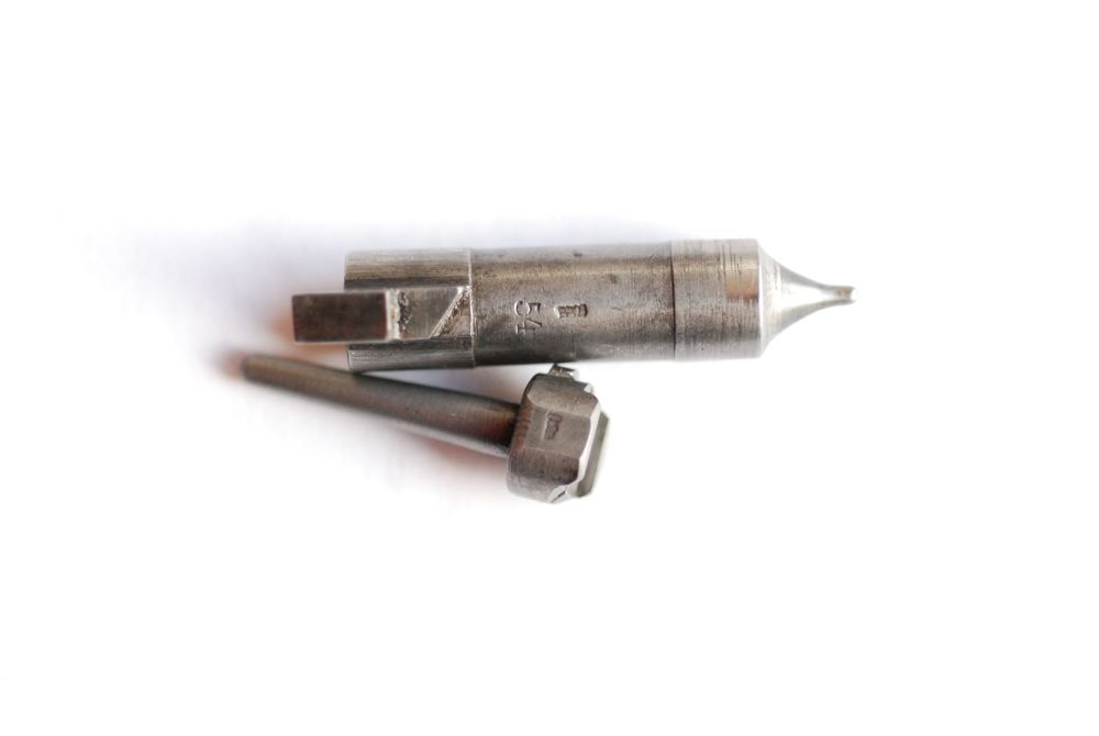

Hi Jim, Trigger, breechblock, firing pin, hold-open and grips, have numbers that are not externally visible. In addition, all parts with the exception of the grip screws and springs should have inspection marks. Regards, Norm
