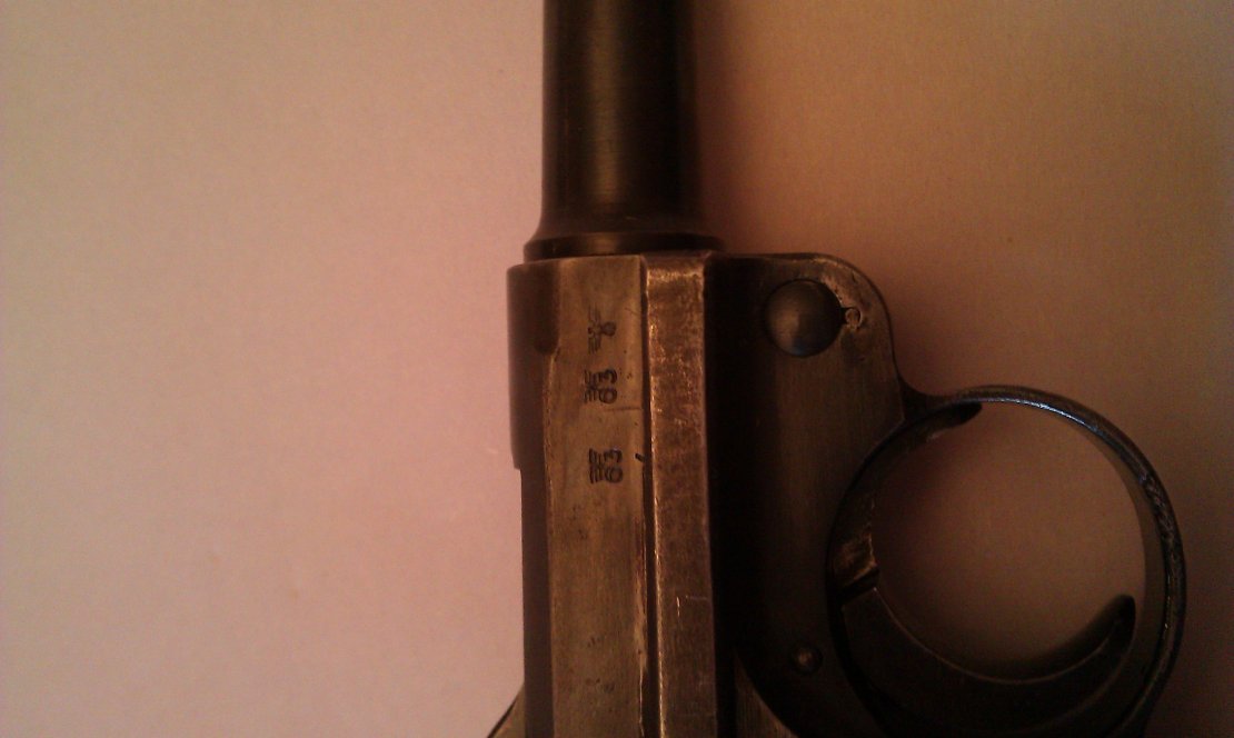

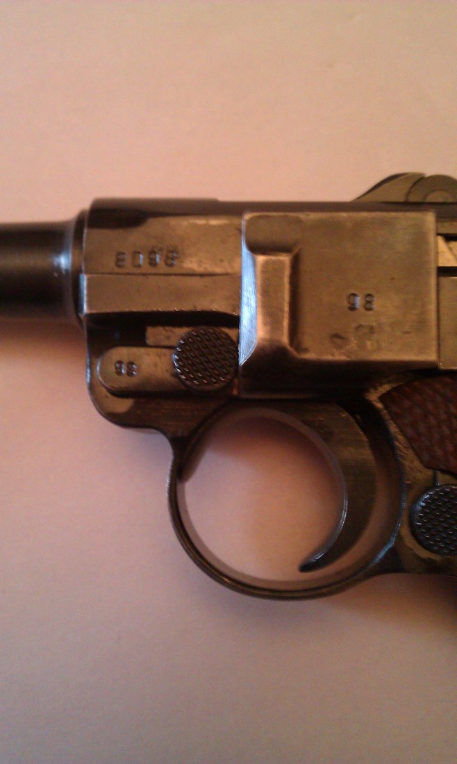

Hi Marc,
It doesn't represent a Russian capture. It has not been re blued and no "x" marking.
All the s/n's match. 2 x e63 and eagle on right receiver. s/n 8098r.

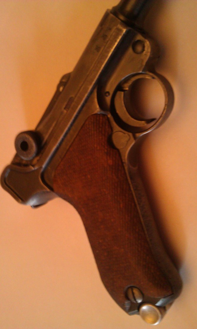

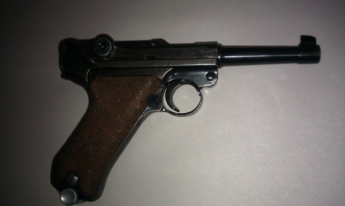

1939 42 Mauser
OK, here are the barrel markings. I believe as you guys stated it looks like a Finnish Tikka re barrel.
This is my first Luger I got at a local auction. Let me know what you think. The hold open link and firing pin is also matching s/n.
Thanks in advance
John

yup she a finn

Nice Tikka. Good shooting.

A very clear finn luger. Not all of them had the "SA" stamp. But the barrel stamp is absolutely finnish.
