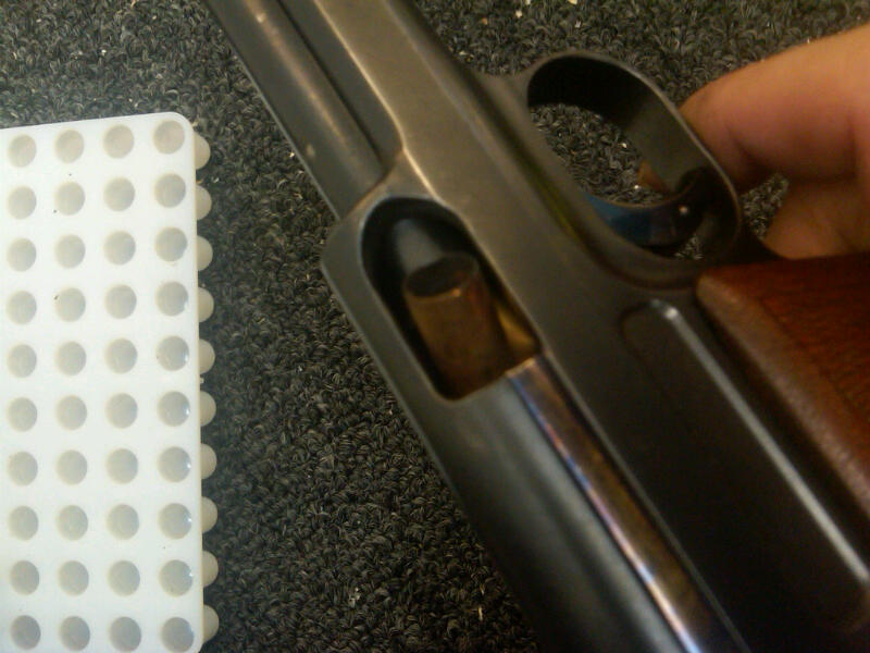

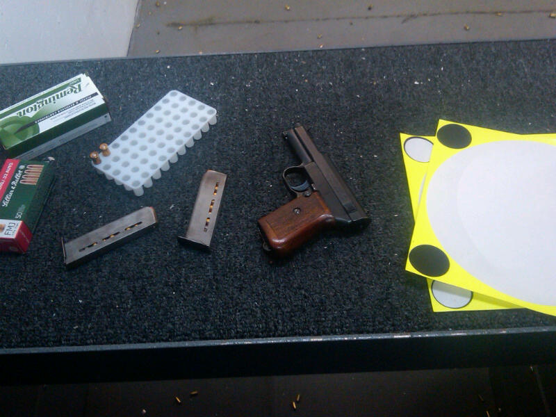

I went to range today shooting a Mauser 1914, a relatively early #3188. Fired 110 rounds. The trigger pull is excellent on this gun and it's accurate. Everything worked fine except two empty cartridge cases failed to eject.

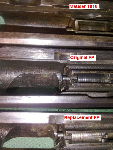

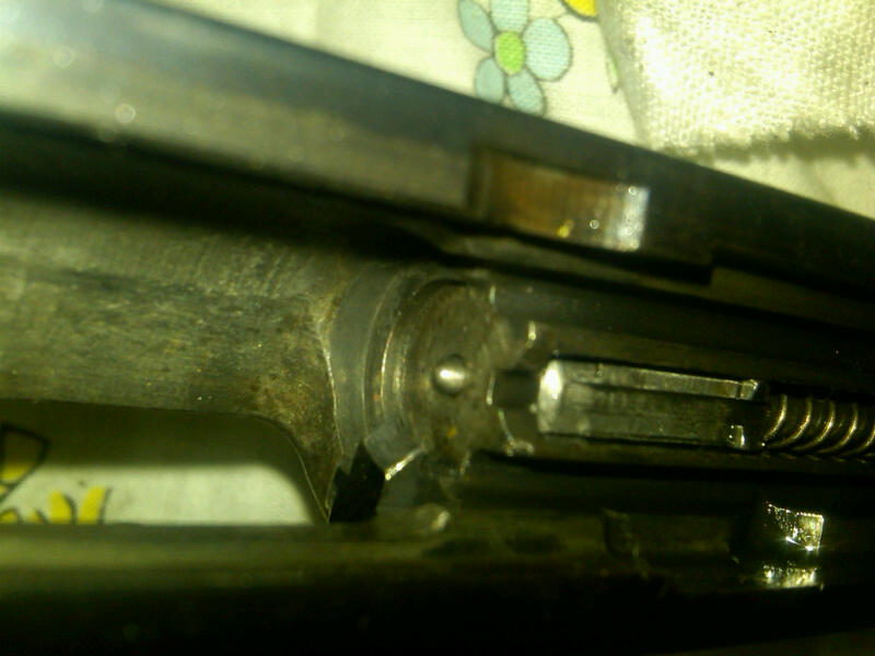

Originally, I thought the jamming might come from Federal's 71gr ammo. Could it be too weak to push the slide backward enough? By dragging the slide wide open, to my surprise -- this gun does not have a formal ejector and the ejection function is performed by the firing pin, like a Browning pocket pistol. Unfortunately, the firing pin on this gun protruding too little (around 1m/m), it's long enough to perform its firing pin function, but as an ejector.... doubtful.
Is this a "feature" on early 1914? I don't know. Any thought?

Alvin,
I think you will find that the slot below the firing pin is there for the ejector/holdopen on the frame
Rich

Rich -- Thanks! You're right!! I just checked again. It does have a conventional ejector, as an integrated part of that Mauser specific slide hook. I missed it earlier.
Now, I have to rethink why it jammed. Fifty 71gr Federal "American Eagle" fired, two failed ejection. Fifty Czech made 73gr worked fine. Ten Remington worked fine as well. Probably need to shoot more to find why.

Alvin, it may not be the reason why it jammed.. but I agree that the firing pin looks a bit too short.
Edit;
I see now that it's a bit unclear from the picture.. It's just the top one that is 1910, the other two are 1914/34.

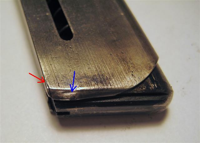

Just coming back from range. Trouble cause identified!
The jamming was caused by the broken magazine. There was a "bubble" on the mouth of the magazine, which causes feeding and ejecting issues. After careful checking, I found there was a crack on the magazine wall. With this crack, the magazine mouth by itself was not strong enough to hold its shape and was damaged by the rim of the cartridge.
After identified this issue, I tried a good 1934 magazine in this M1914, fired 150 rounds (including 50 Serbian made JHP) -- everything worked without any trouble.
Early 1914's magazine with this type of bottom must be hard to find
