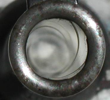

A picture of 7,65mm bore may be helpful.

The bore doesn't look like that picture above. I can see the groves but they have no depth at all. I will try and get some pictures and see if the guy will let me take it apart to check the serial numbers.
