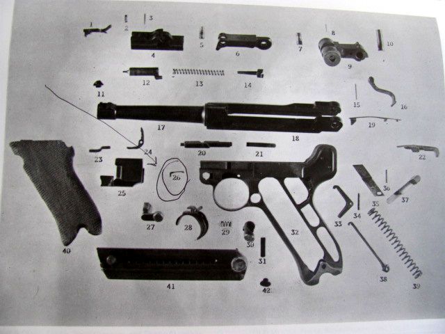

My 1917 artillery survived 2 world wars, trench warfare and has gone to far for you to make one mistake or use an incorrect load. It would be disrespecful to even attempt to fire it without a thorough inspection by someone qualified to do so. Last night on 'Sons Of Guns' an artillery was brought in. Before the agreed to fire it they did a full shake down including replacing the fire pin. There are 42 seperate parts, each must work exactly or some one including yourselve the results may be tragic. Please have your wonderfull heirloom be thoroughly check out. You owe it to yourselve and its previous owners, Eric

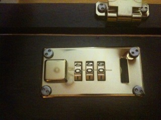

The screw is a Drilled Spanner head (slang) (Snake-eye) also called Security screws or Tamper resistant screws. They have been used on Elevators for many years. I use them on my gun box lock I got them at McMaster Carr along with a bit. See Pic#2

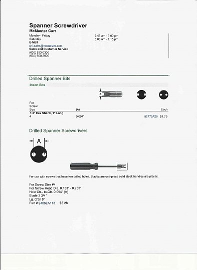

When I got my Artillery I checked with them but they had no Metric drivers or Spanner screws so I paid $40 for the little brass tool.
After I got my sight adjustment screw working I realized that the screw is the exact same size as a 4-40 Spanner Head screw. (0.094" c/c holes) ***McMaster Carr Atlanta Phone # (404) 346-7000 Internet www.mcmaster.com *** bit price $1.75 or $8.25 for the whole scredriver See Pic#1.
As I see it I can justify paying $38.25 more and waiting a week because the round pins in the brass one are less likely to deform the edges of the holes in the screw and the pins are exactly the same depth as the holes in the screw so the brass flat of the driver rests on top of the screw. (less potential for damage) Also because I played $40 for the tool I was careful not to force it. Most important is that My $1300 Artillary is not damaged and the sight is now adjustable.
If your screw is not stuck the modern tool is OK (It is lower cost) but it sure does not look as neat as the wooden handle one I saw with a price of $500.00 or my little $40.00 brass one. Pic#3
