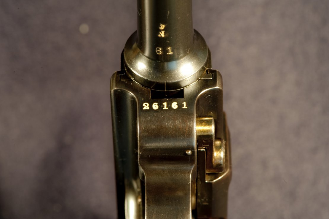

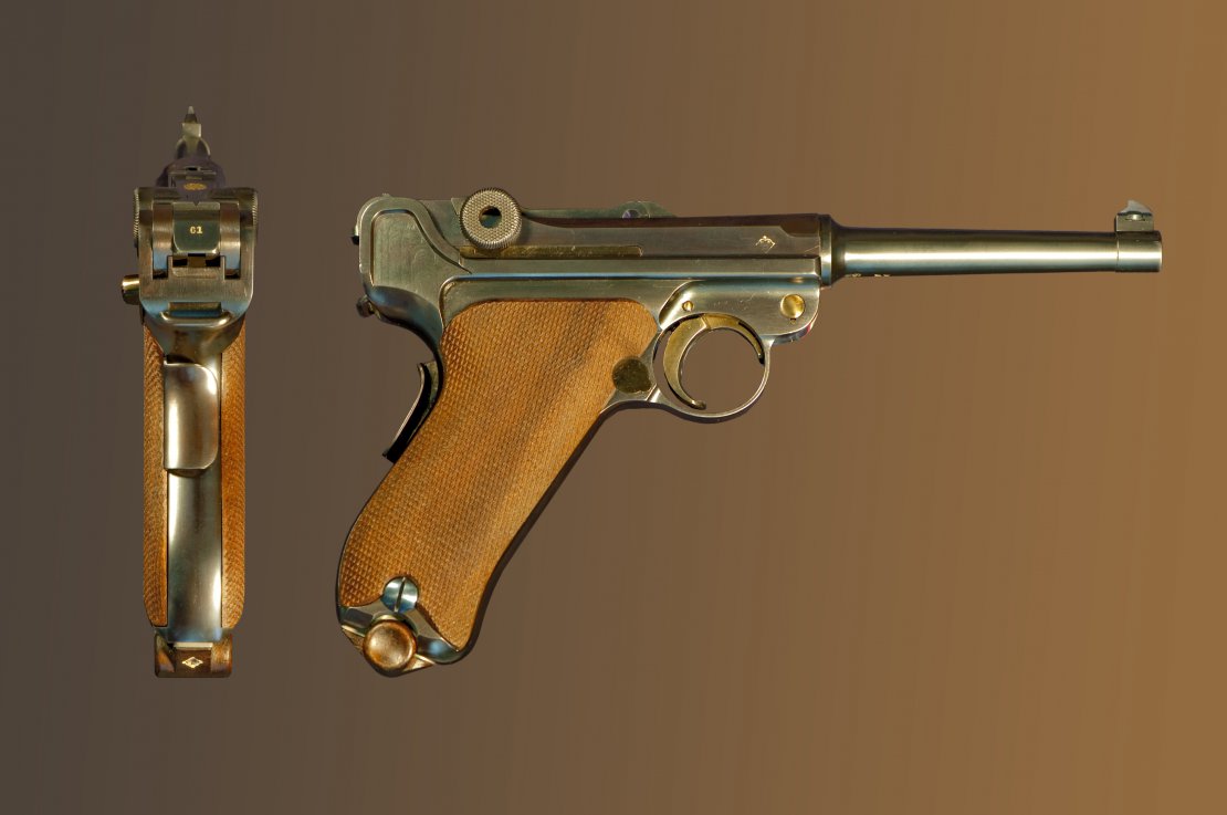

Luger Forum - Could a Swiss collector help with a question for a first time poster? I have a 1906/1920 (?) re-work for which I have not been able to identify the gunsmith mark. The pistol is a very early commercial serial number built on the long frame. Re-worked in Switzerland, it has a new barrel and I believe new receiver (marked internally only with a "G", which indicates it was manufactured in 1912 (?). Close examination of the barrel/receiver index mark indicates that no other barrel had been mated to the receiver. I suspect it also got new grips as they have no internal numbers. The barrel is serialed to the frame and Crown-N proofed, with the "lazy" Crown-N proof stamped also on the left side of the receiver.
My question centers on the Swiss gunsmith acceptance mark. It is identical to the well-known Fluckiger mark, but instead of the "FZ" initials, this mark has the initials "RB". The mark was also stamped on the bottom of the magazine, and filled with some sort of paint.
Was the enrayed Federal Cross a standard Swiss mark for which any gunsmith added his particular initials? Also, do the Crown-N proofs indicate that the gun was returned to Germany for proofing? Why would it not have been submitted for Swiss proofing which would have satisfied that countries requirements? And then, why is the receiver proof sideways? Shouldn't it have been vertical by this date? Lastly, is there a definitive was to identify the barrel as manufactured by Hammerli rather than a Swiss military piece?
Thanks in advance.

I have seen a Swiss rework with a FB rather than a FZ, which I presume refers to a Bern (or possibly Basel) workshop rather than the usual Zurich location, but the RB is new to me. I can’t tell from your photos whether the chamber bears the large enrayed Federal Cross?

I have been reviewing Bobba in an attempt to identify your Luger. It appears that it may be one of the small lot of 1906 Commercial Swiss. Apparently there were not many of these guns produced and their production was mixed in with other commercial and contract production of that period, so there is no definitive serial number “block” or range exclusive to these guns. The 26161 serial number would certainly support the post 1906 timeframe. The horizontal Crown/N receiver proof is correct for a Model 1906 produced after 1912 (which fits in with your observation about the "G" receiver marking), and it was originally produced and proofed in Germany, not returned for later proofing. It obviously has been reworked and rebarreled by, at this point, an unknown gunsmith…possibly a subcontractor to Flukiger or one of his workmen. These guns were reworked/produced for Swiss civilian shooting sports.
I have not discovered any way to positively identify a Hammerli produced barrel, but the thick flange on your gun is certainly typical of some of their known pieces.

Are you saying that the receiver is original to the frame? I assumed that the very low SN on the frame indicated that it (the original gun) was manufactured shortly after the switch to the New Model in 1906 (at about SN 25000?) and that the receiver (which bears no SN on the recoil lug) was a factory replacement manufactured some years later. Maybe not so?
I guess my last question is why the new Swiss-made barrel has the German Crown N and not the Swiss Cross proof? -SD

Actually, I agree with you that the receiver is a replacement. The serial number of the frame is only roughly 1000 away from the start of Model 1906 production placing its manufacture no later than late 1906/early 1907, whereas the receiver was most certainly produced in 1912. However, I am still of the opinion that the barrel and receiver were originally proofed in Germany and not sent back at a later date. Possibly it was an OEM part from DWM ordered by the workshop that did the rework.
I am leaping to the conclusion that it started life as one of the small lot of 1906 Swiss Commercials based on its final Swiss configuration. It could very well be an early standard 1906 Commercial that was “transformed” into a Swiss when it was reworked. At any rate, it is an early 1906 and a very interesting piece. I would have it in my collection based upon its condition, markings and as a stimulus for interesting conversations!
