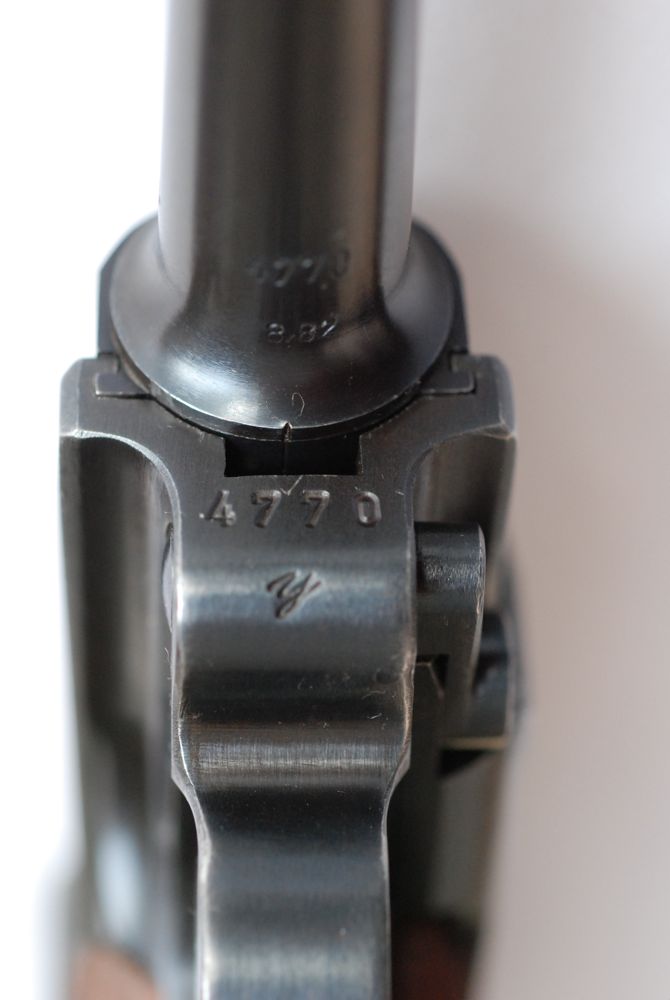

Unread 09-05-2011, 04:31 PM   #8
Hi John, The suffix appears beneath the frame serial number, and no place else, as shown in the photo. Regards, Norm

Posts: 8
Thanks Norm, so the example in your picture is 4770Y, is that correct? So I am assuming that mine is the 23rd Mauser in the W series. All this is very interesting. Are there three different bore sizes for my model? Mine is 8.83. Do all three shoot the same ammo? I know its a dumb question.

Hi John,
Your gun is, indeed number 23W. The bore size was the German's precise way of keeping quality control. All the bore sizes that start with 8.8_ are for the 9mm Luger round.
