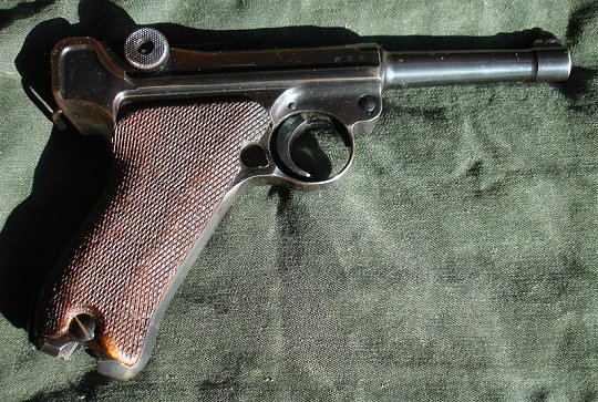

This is the gun. Could it really be that simple; I was just pulling in the wrong direction, up instead of back? But why can't I slide the safety?

Unread 09-01-2011, 02:10 PM   #4
Please show a photo of the safety side of the gun. Also remove the right side grip (the one shown in your photo) and photograph the internals. It could be incorrectly assembled or it could be gummed up. The additonal photos may help troubleshoot.

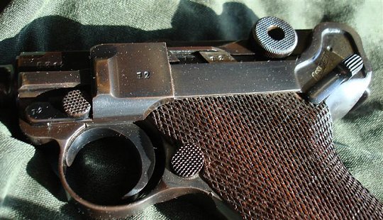

Here's an image of the safety side. I'm afraid providing an image of the gun minus the grip will have to wait until this weekend when I'll have time to disassemble it.

Stupid question - Is the reason I can't slide the slide because the safety is engaged (down position)? And does that then mean that the slide is working fine (it shouldn't go back because it's not supposed to when the safety is engaged) and my real problem is that the safety mechanism is jammed? In other words once I get the safety to disengage the slide will slide back. Sorry, this is all rocket science to me.
Enoch is offline   Reply With Quote
Unread 09-01-2011, 03:14 PM   #7
Enoch, the answer to your questions is yes. I see no reason why the safety lever should be stuck in the down position. You should be able to swing it right up to the upper position.

Your Luger has what is called a "relieved" sear bar (a modification to the design that happened around 1913). This feature allows the toggle to be opened far enough to safely remove a round from the chamber to clear the weapon, but not far enough to completely cycle the action. To be able to fully retract the toggle the safety must be in the "up" postion so that the GESICHERT marking is covered and the little silver "flag" that blocks the sear is retracted. If you cannot move the safety there is a pretty good chance that it is just gummed up after all of these years and bit of penetrating oil on the "flag" and the pivot point of the safety lever might free it up. To do this you will have to carefully remove the left grip. The carefully is underscored because it is very easy to break the grip panel just below the safety lever. Remove the grip screw and reach into magazine opening with your finger and lift up on the bottom of the grip panel just enough to clear the grip frame at the bottom, then gently pull the grip panel straight down until it is out from under the frame and safety lever. It may help to push in on the magazine release button to make it easier to pull the grip panel down.
Unread 09-01-2011, 03:52 PM   #13
(Overlapped writing this note with Ron's above...)
There was a change made to the Sear early on to relieve the sear so that the Luger could be opened part of the way with the safety engaged.
Your WW-II era Luger does have that cut in the sear (just forward of where the safety lever contacts the sear).

Ron, I would also add, that if the gun is not cocked, the firing pin will not be able to move over the sear because the safety is on... giving exactly the symptoms that are being described about not being able to pull the toggle open...
I doubt there is a round in the chamber, because the extractor is flush with the breechblock in one of the photos. It would be "up" with the word "geladen" exposed if there were a round in the chamber.

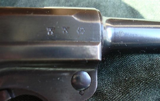

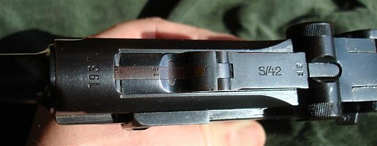

Figured I'd post an image of the proof marks (right term?) in case anyone was interested. By the way, if anyone wants to educate me re: those marks and provide details re: what each one actually means I'd be very grateful. I realize I can get that information via research but if someone who knows would just tell me it would be so much easier. Yeah, I'm a little lazy
Also, my only other thread on this message board is from a few years ago when I was considering selling the gun (not considering that anymore, wound up selling a vintage Gibson mandolin to get the money I needed at the time) but, again, for the curious, there're pictures of the holster and magazines there. The thread is entitled "My Dad's WWII Luger..." Skal!
