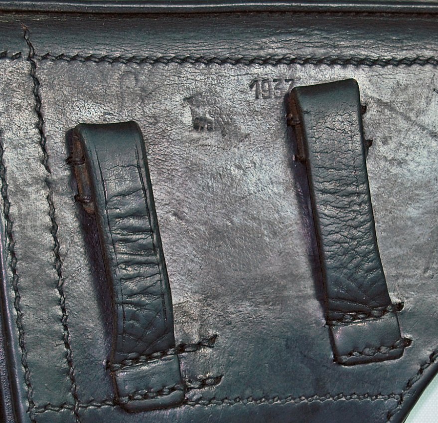

Hi All,
I have a Luger holster that I have not been able to identify its manufacturer. The maker's mark looks be be a cursive L with another letter next to it.
I had Jerry Burney do his 'magic' on the belt loops and I asked him about it but he couldn't identify the mark. He did, however, do a beautiful job repairing the belt loops!
Anyone have a idea who made it?
Thanks for your time.
Bill

Well, if Jerry had it in his shop and could look at it with a loop, I am unsure if we can. However, I recommend you take a very clear, macro picture, then post it here.
It does not blow up big enough to tell.
And would / should it be a 3 digit code by this time period?
ed

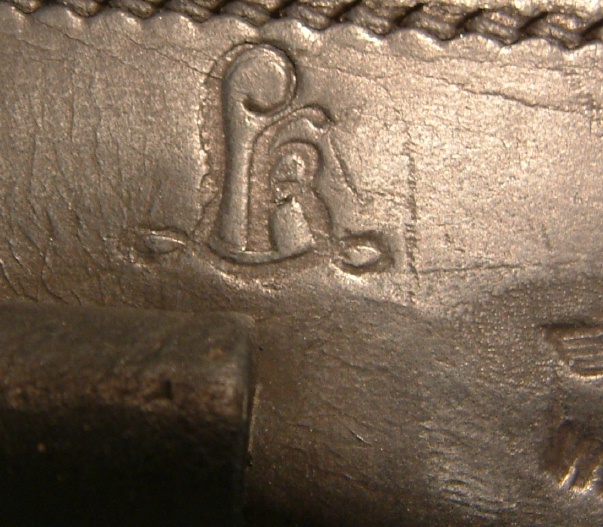

The WaA should be 145
File Type: jpg Luger Holster Maker Mark Steininger 2011.jpg (156.3 KB, 70 views)

Thank you Jerry!
Bill

145
-Karl Barth, Militäreffektenfabrik, Waldbröl, Nordrhein-Westfalen
-Deutsche Lederwerkstätten GmbH, Margarethenstrasse 3, Pirmasens, Rheinland-Pfalz
-Lock und Hartenberger Metallwarenfabrik, Idar-Oberstein, Rheinland-Pfalz
